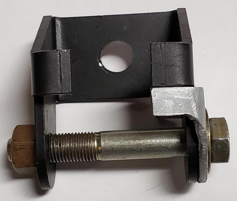

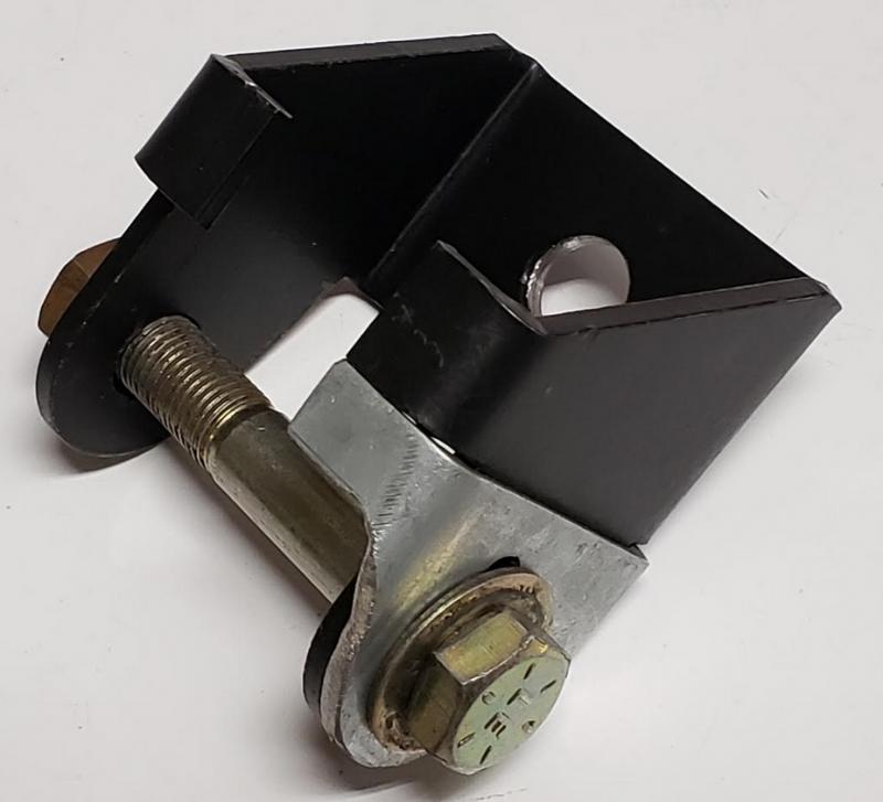

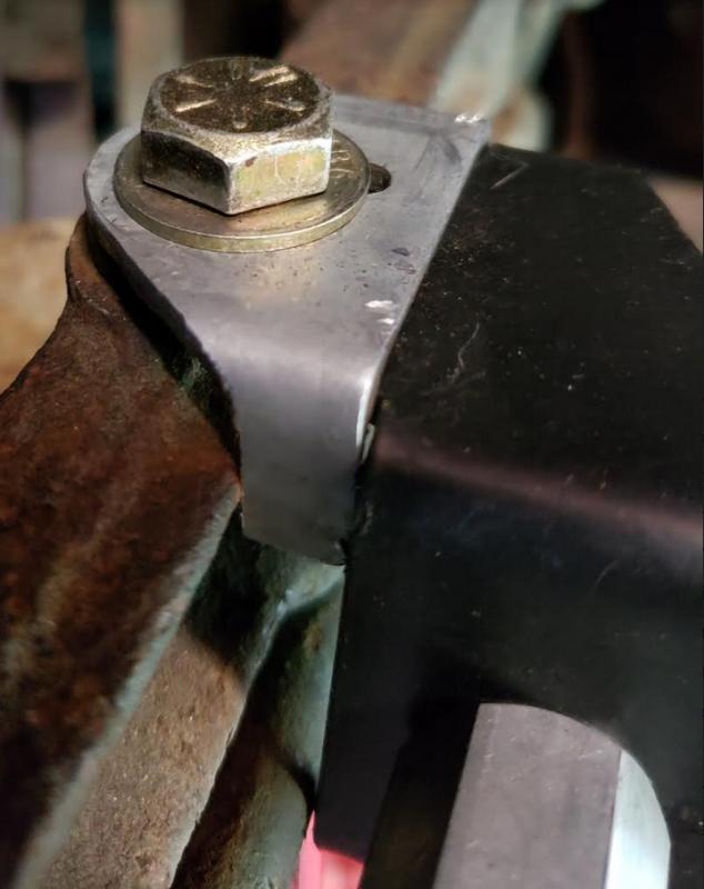

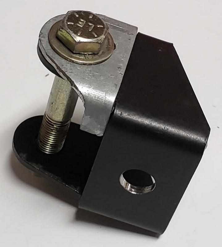

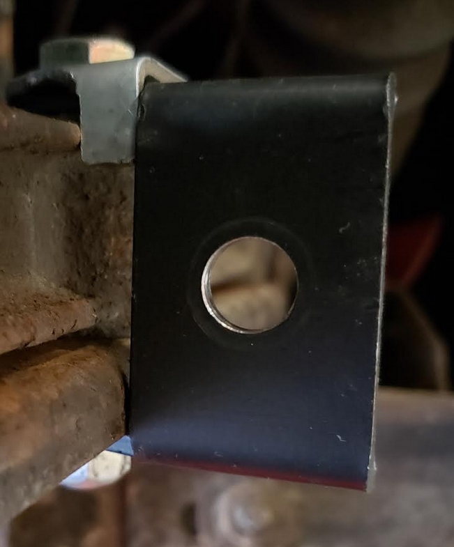

Sway bar bracket twists because top tab does not rest against side of lower A-arm. This add-on should prevent the twisting. New bracket temporarily installed on the A-arm and gaps measured at 9/32" and 5/16". Tabs on add-on were fitted to these gaps. Was made from a house-framing bracket of approximately the same gauge steel.
Looks good Steve. Were your mounts missing the spacers that go between the bottom of the A arm and the bracket?
