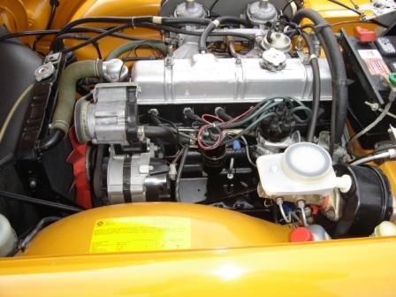

Attached is a picture of my engine bay. The car now has 18.6 K miles. Except for the coil and Pertronix ignition, and battery everything should be factory original colors.

Semi-gloss or low-gloss black is probably correct in most cases. Not much use of high gloss under the hood of any car, except for the body color.

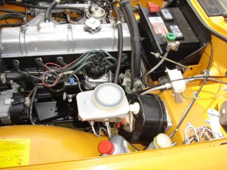

I started to post a better picture yesterday but the network died. This shot shows more of the left side of the engine.

Thanks for the picture. It is helping me with other issues also. From the picture, it looks like the engine is semigloss and the rest of the items painted black were gloss.
