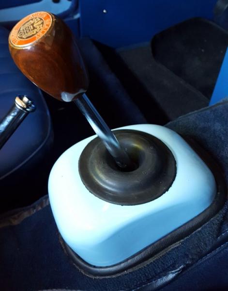

It turns out that converting my shifter boot from "outie" to an "innie" made a big difference. It now works pretty good (and perfect in 3rd and 4th). 1st is still a tiny big scrunched but not excessively... AND the boot stays in place without any adhesive.

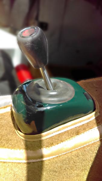

[only realizing that this thread is old, oops]I got a chance to install and test drive a Bugeye with the prototype today. The results are even better than I expected. The volunteer who brought his car over said the shifting actually felt better and more positive than with the original shift lever. I only had some brief seat-time, but when comparing the two, it felt that way to me as well. Shifting is crisp and positive.

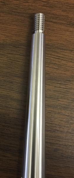

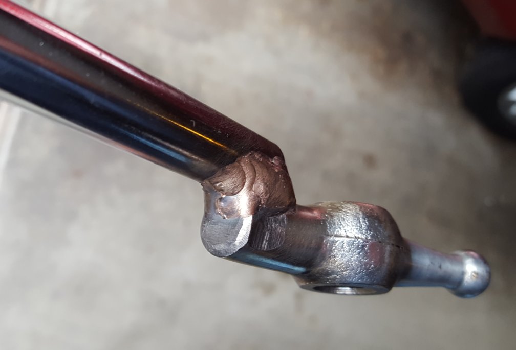

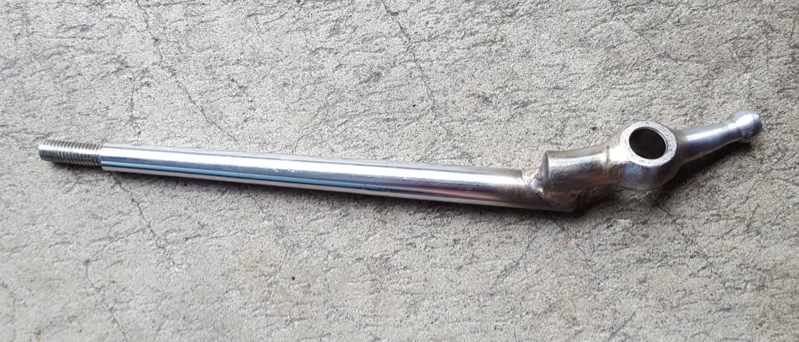

Thanks for the pictures! I can duplicate it. JimThe one I made (well, a TIG-welding buddy made for me).
