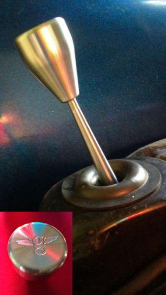

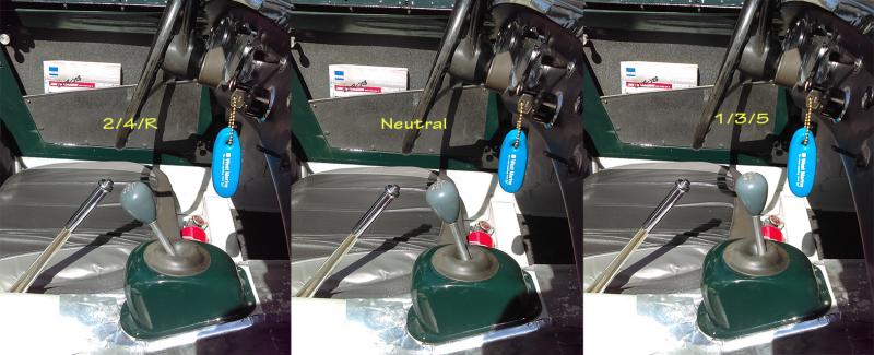

Pictured below is the proof of concept short-shift prototype I developed for the Datsun 5 speed conversion. Yesterday, the final CNC product was shipped to me for final approval and testing, which I hope to have by the weekend.
Besides reducing shifter travel by about 50%, as a bonus feature, it will also fit neatly under the original metal shift turret most people desire to keep in place, as well as use of the original rubber shift gaiter. This is a custom shifter and will include the necessary mounting hardware, new bushings and pivot pin. The shift lever will be threaded to accommodate existing shift knobs, but I can also supply new MG, AH Sprite, 5 speed pattern shift knobs. I am also considering making a "Winged g" badged version that some have requested like seen that on my adapter plates. Installation can be performed with the gearbox already installed.
85% of my intended first run is already pre-sold, but I still have a little time to increase production if others are interested. Please contact me directly for more details if you are interest in having one.

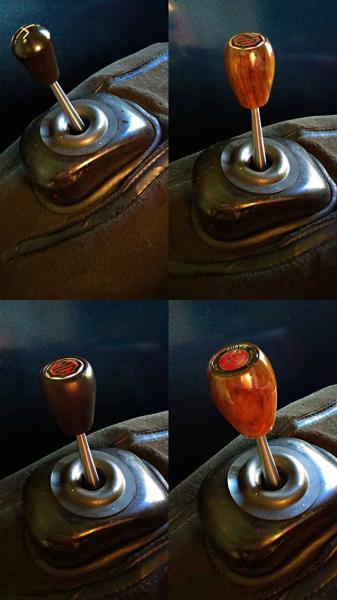

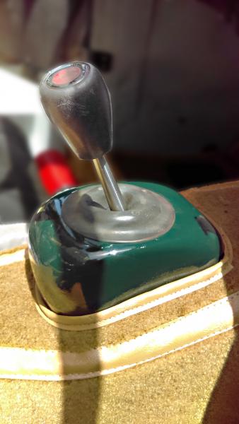

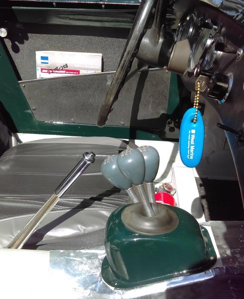

Received the prototype shifter as well as a proposed custom shift knob (not included with the kit) I've shown it with several shift knob variations, including an period original.
I couldn't be more pleased.

I got a chance to install and test drive a Bugeye with the prototype today. The results are even better than I expected. The volunteer who brought his car over said the shifting actually felt better and more positive than with the original shift lever. I only had some brief seat-time, but when comparing the two, it felt that way to me as well. Shifting is crisp and positive.
