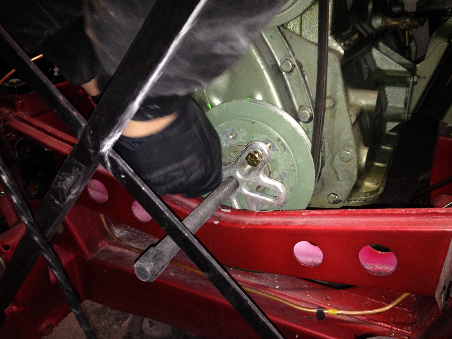

Quick update guys.... Just received all my parts and tools and started today. Made some good progress and took off the starter dog, PIA.

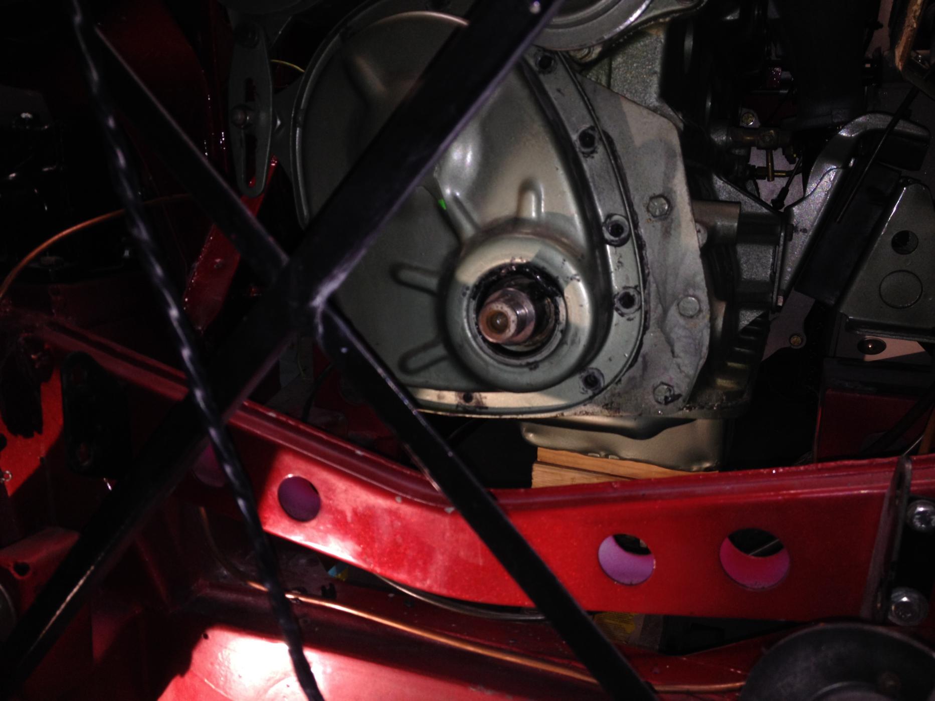

Question, I have the motor-mounts 3/4 backed out, how far from here do I have to jack up the engine? Ive called it for the night, but thinking im not seeing enough clearance from the damper and brace. Im not sure if it needs the whole 3" from crank tip to bottom of damper or leave and just get it loose with a puller and wiggle?

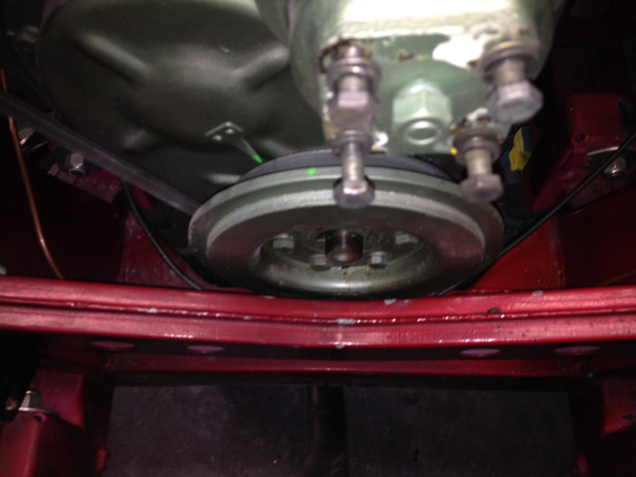

First you'll need to undo the ring of bolts to separate the damper from the pulley, then raise the engine an inch which will give enough clearance to firstly get the damper out then the pulley. A couple of pieces of inch thick timber work well under the engine mounts.

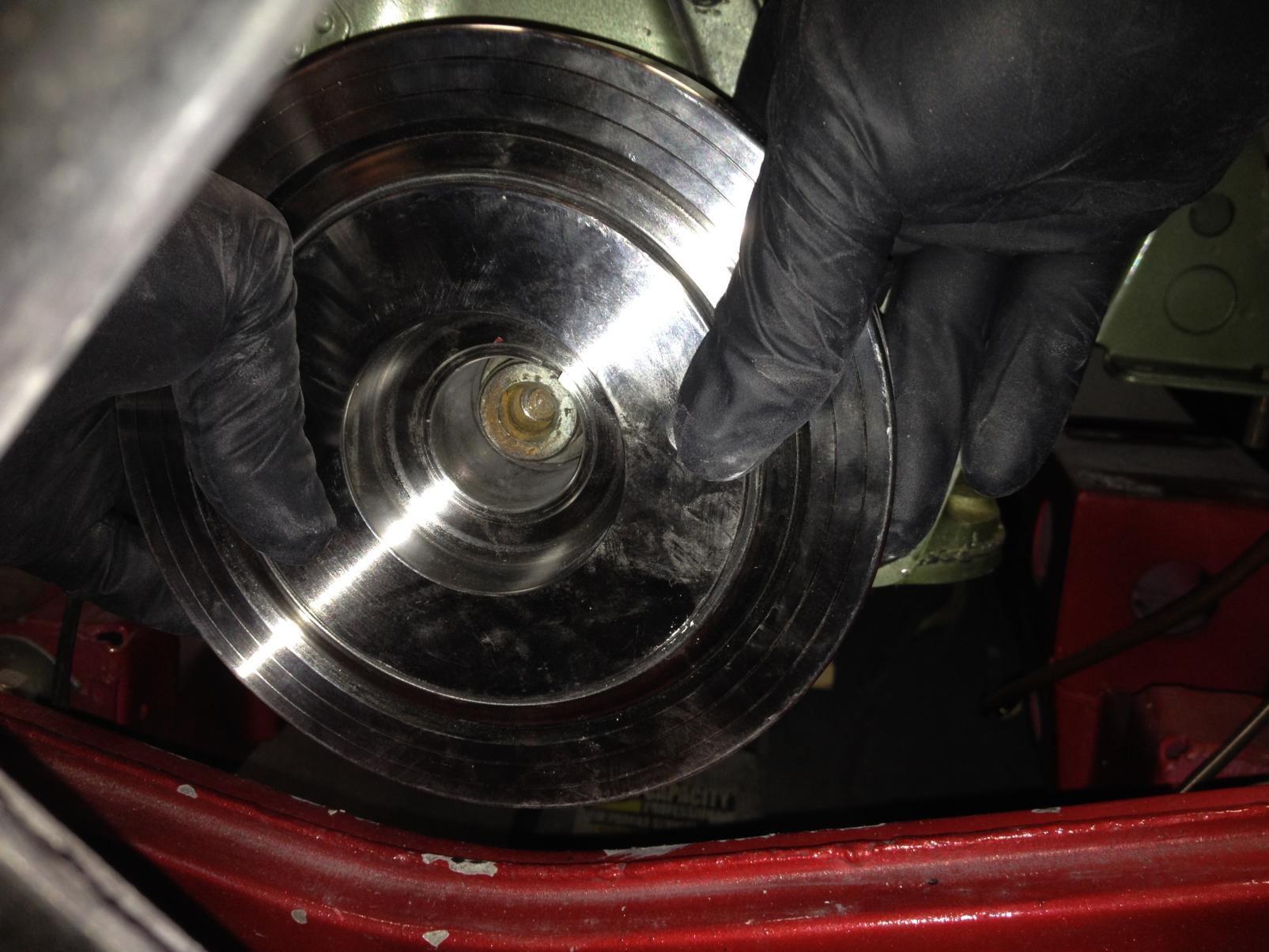

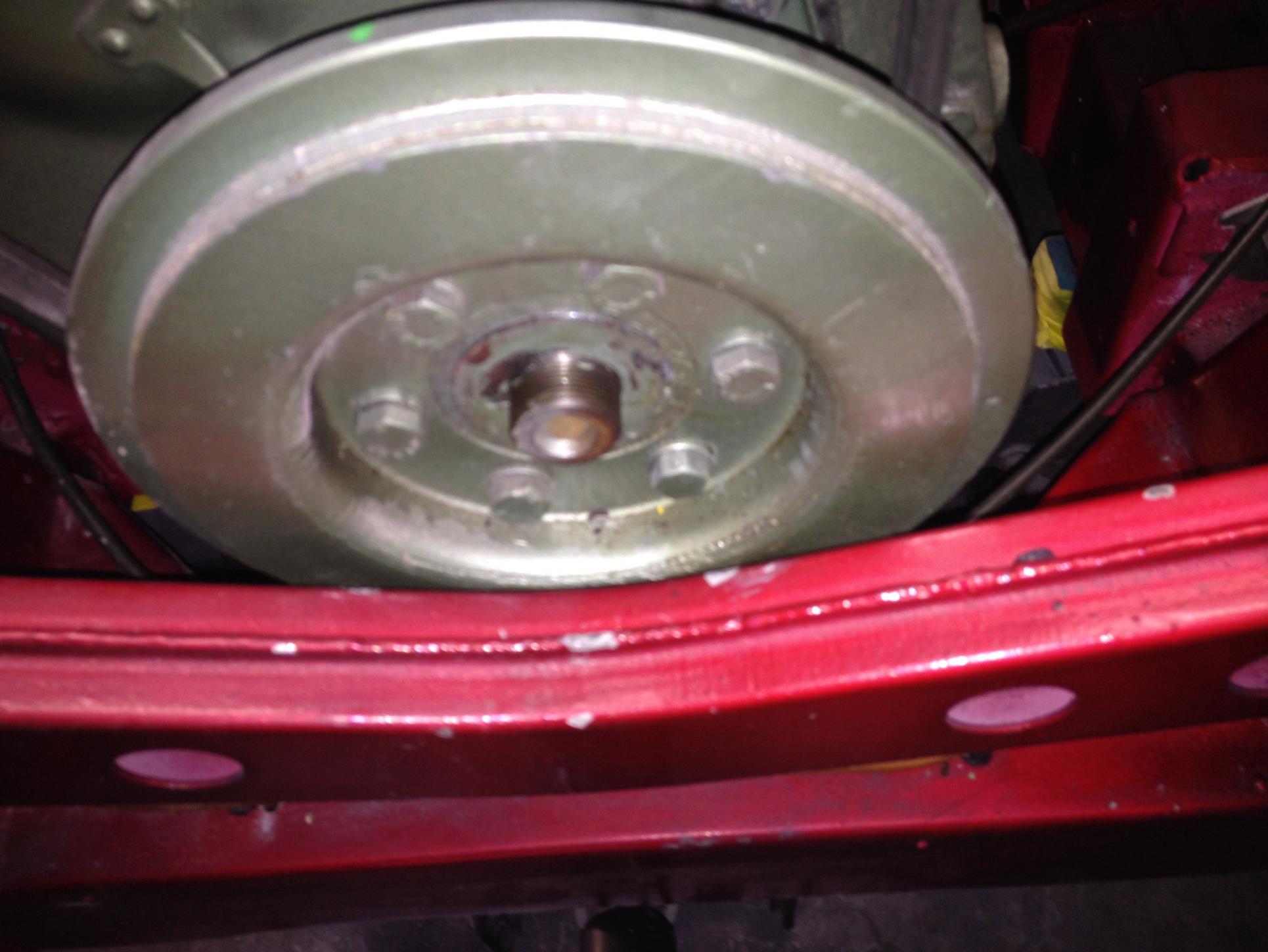

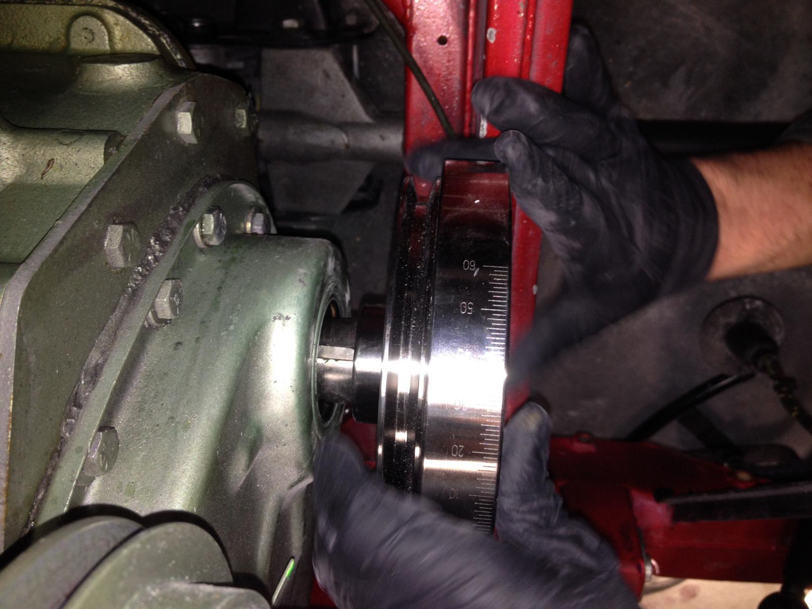

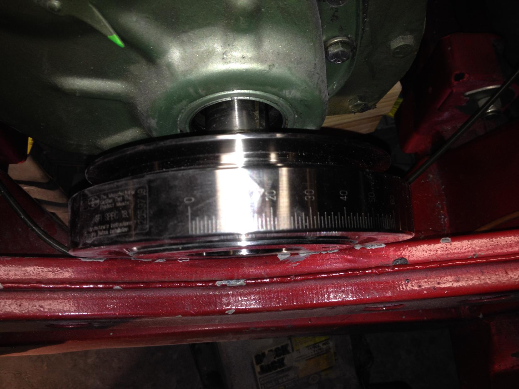

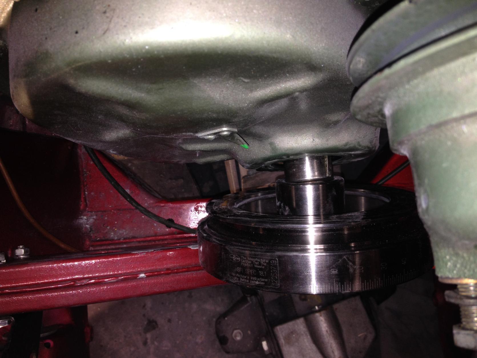

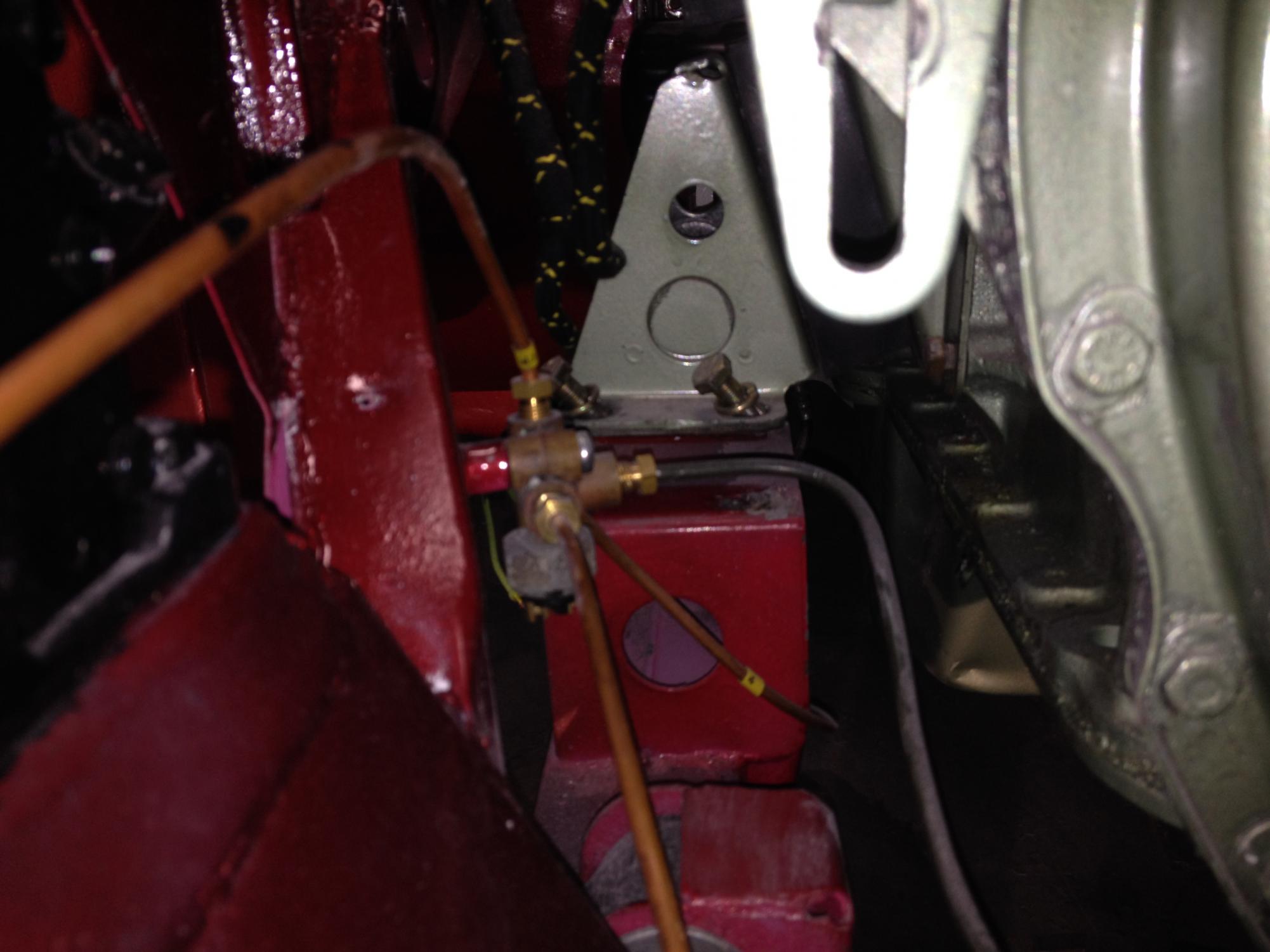

Thanks guys, now at a hair pulling point. Pulled the old pully, but the new one just doesnt have the clearance even with jacking up 3". Any ideas? The bottom lip of the balencer just keeps hitting the cross member causing it not to line up on the crank. Ive tried to lower slowly hoping it would push on a bit, but the angle gets worse.
I have already pulled off a air cleaner from the front carb, now having to pull the next with the choke. looks like I have to loosen the gearbox from the engine to let it seperate for another couple inches?

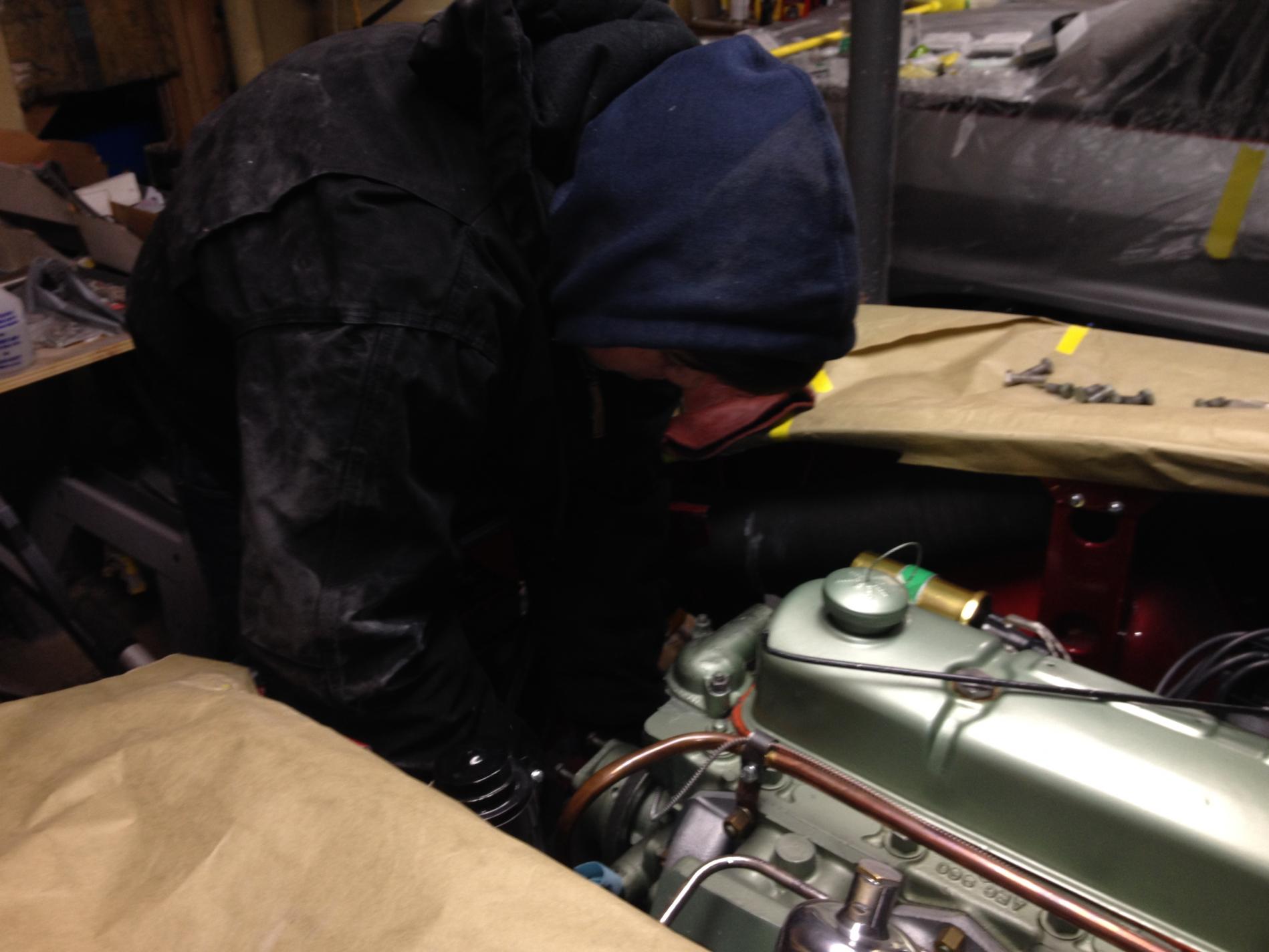

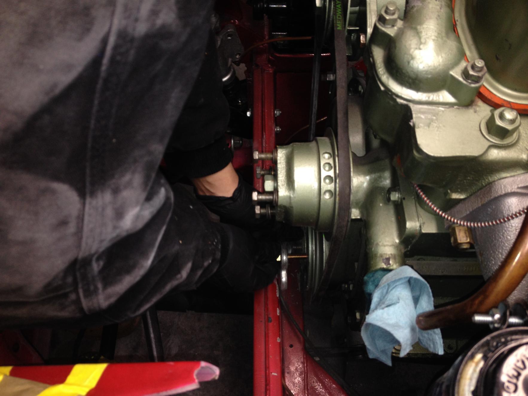

Have Avery, our HS sophomore doing the gear pulling but its soooo cold and were bundled up in the garage today. Was -10 last night and taking a long time to warm up.

Hmm. I loosened them at the point where they come to the cross beam, but you might be right. Eating lunch and thinking of how simple it would have been before i put the motor together and put it back in the car! I also had to loosen the exhaust from the muffler, disconnect the throttle linkage just to get here!
Wonder if it would be easier to loosen the transmission mounts and jacking the engine and tranny up together rather than undoing the bellhousing?

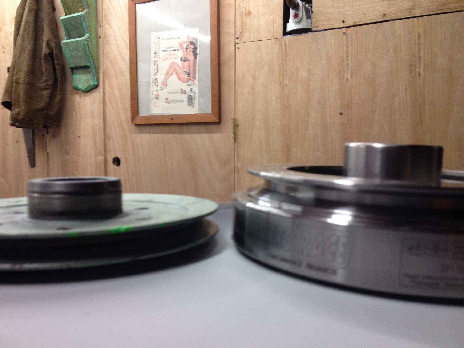

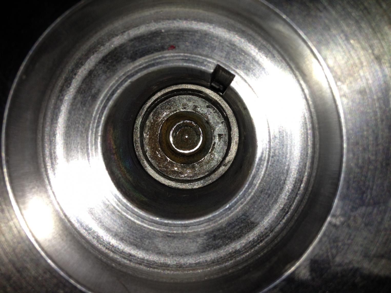

Couple more pics....You can see the nose is a lot taller on the balancer, causing me to need the clearance

photo 1 (2).jpgphoto 2 (2).jpgphoto 3 (1).jpgphoto 4 (1).jpgphoto 5 (1).jpgOk, it fits!! Was able to get past the cross member by lifting another 1" disconnecting the tranny from the car by the tunnel, Healey Ricks idea!

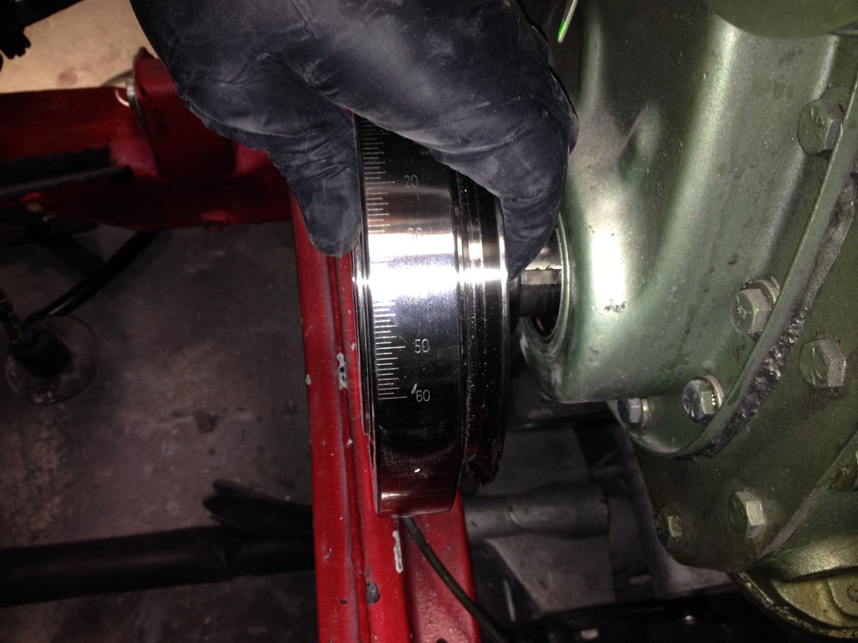

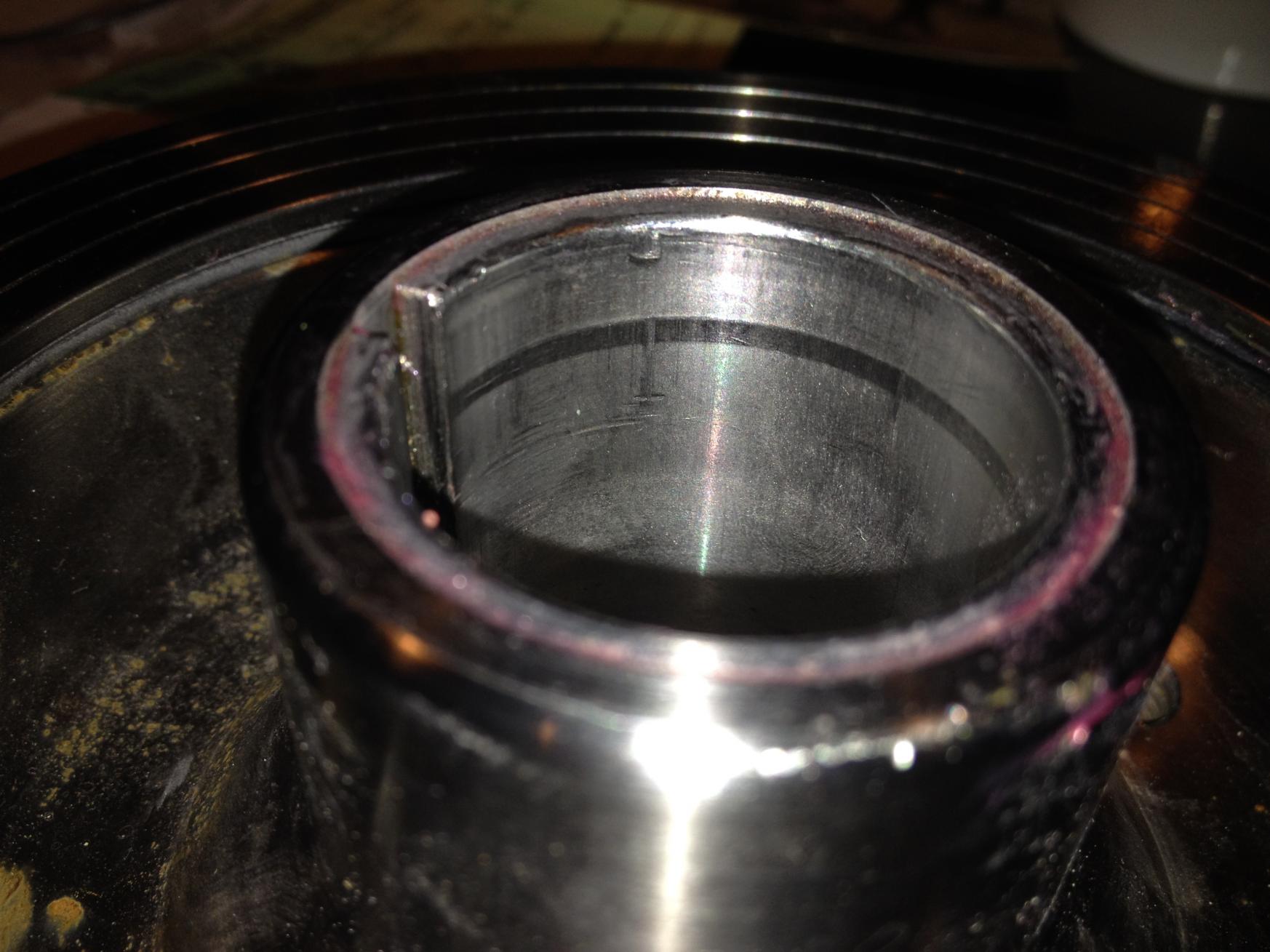

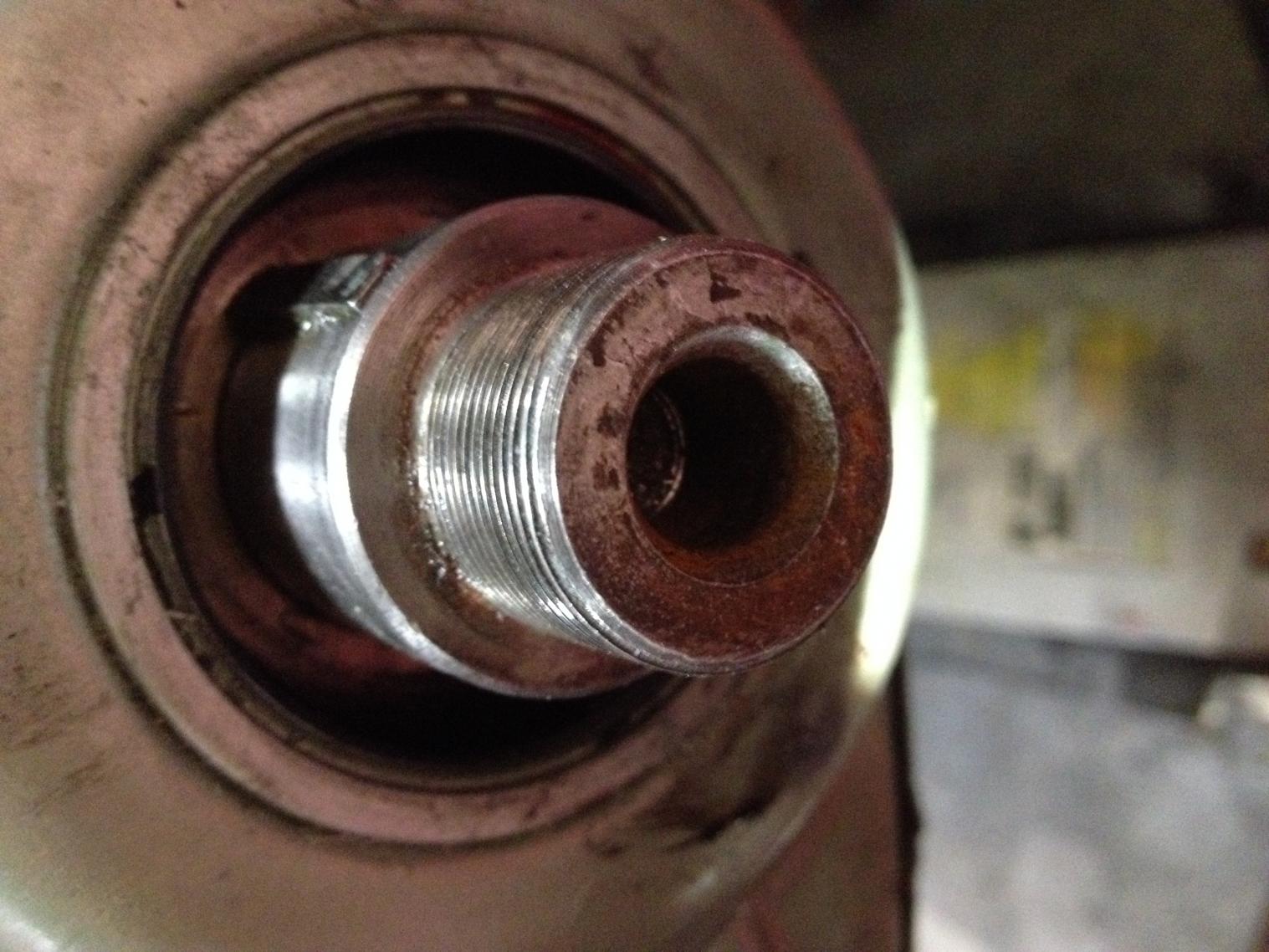

Strike two. The first strike was the trying to get the space needed for the balancer to get started. The second, failed getting the balancer seated today completely. Thankfully, I had my gear puller near by and we were able to pull off, but have to say, this is a TIGHT TIGHT! We boiled the balancer in water per instructions, used a jack pipe handle against a piece of 2x4 that rested flat on the balancer. Pummeled the pipe till the wood had 1" holes and couldnt get it more than half way seated. What took the longest was making sure the keyway was lined up, that was probably just 2 min, but enough to kill us.
I think for sure I had the power was enough behind the blows, but the give in the wood block took away the inertia I needed to send it home im thinking. Below is a witness mark of how far it made it on, only half way.
Tomorrow, im going to grind down the socket to fit into the balancer like Randys, or send to him. Ill also build a pipe or box tube with a flat end to hit with a sledge! Its on like a prize fight now!

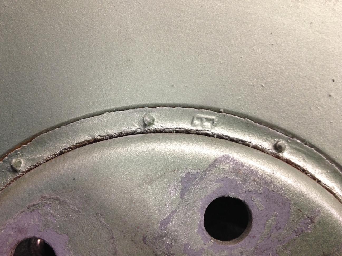

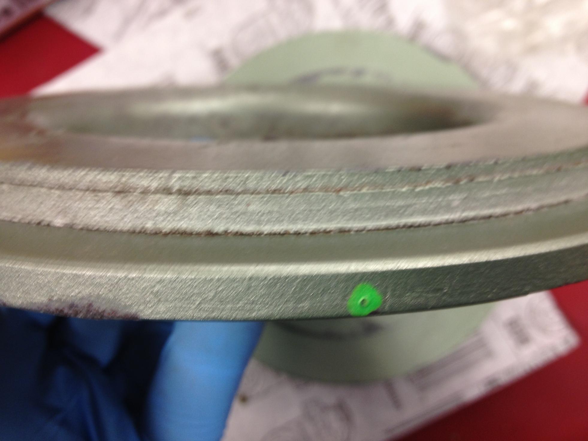

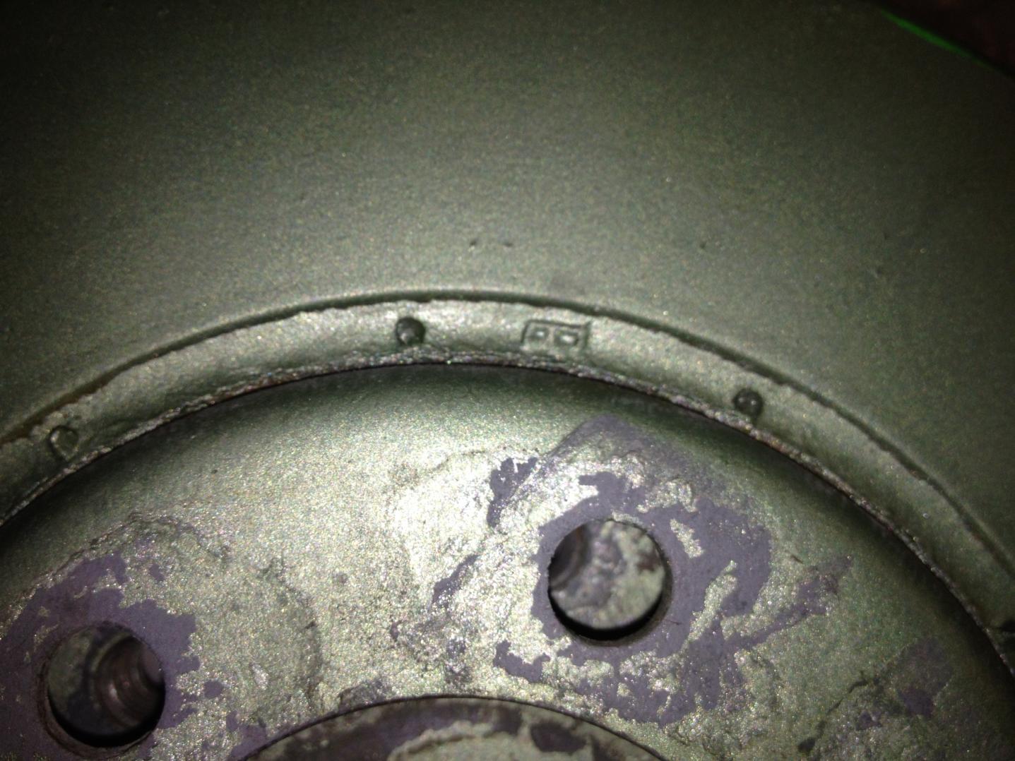

Also, some pics of the old damper. Please please tell me it was bad, that the preventive maint was for sure saving me from a certain catostrophic event and this was worth my time. Like, a story that was certain to unfold, like that the car at high RMP would have sent the starter nut into space and taken out an orbiting satellite, landing on my lawn!. Please tell me this!!
