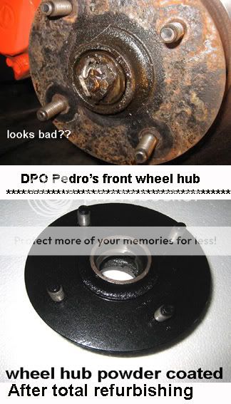

I don't think part of R&R a front wheel bearing is painting the hub,so we got to give Dale a little slack. It is over kill though.

DNK:
Now I ask you in all honesty.
If your wife looked like DPO Pedro's before photo,
wouldn't you suggest to her to clean up a little
before you went out to dinner? Maybe put on some makeup?
Besides- the top photo is Crypty; bottom is Amos.
The blodge on the car is a nasty DPO Pedro missing
paint area. Not a clue how to fix that one.

Seriously now when you powdered that hub, I hope you didn't powder the side where the disk brake gets mounted on right????? The disk brake needs to run perfectly true or you will have a nasty, dangerous pulsing in the brake. As it is, you really should check the brake disk for run out now that you separated it from the hub. Make sure both sides are clean (I guess I don't need to tell you that!) and all the bolts should be torqued to the same level to prevent warpage or the disk being out of plane.
Yisrael
Hey Yisrael-
Nope, only powder coated that ugly front face.
I have no idea what is "run out"
The bolt torque might be an issue. They were
rusted in-place and I had to soak them overnight
in Liquid wrench. Even then, it required a breaker
bar to get them out.
