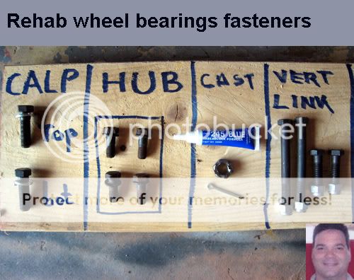

I just got back from the specialty fastener store.
I had my bag of Crypty stuff that needed replacement
with non K-Mart pieces or rounded off by the vicegrip
tool the "boys" usually used. My mind was elsewhere when
I handed the young man my bag and quantities wanted.
1/2 hour later he's got a nice rows of new fasteners
sitting in front of me on the counter. Then my brain
kicks back in. "I really sorry son, but are any of these
fasteners metric?"
"Yes Sir", he replies. "Most of them are metric."
DPO Pedro and his junkyard mechanic!!!!! Blast it!!
So I spend another 45 minutes trying to convert DPO
Pedro's metric into what I hope will be proper American
fasteners. So tomorrow will be day three of installing
wheel bearings in a single wheel. BLARGH!!!!!!!!!!!

Sorry to hear your woes, but I do like your neatness.
Pat
GB1 said:
Dale
Pat
Yeah, neat is good and all but the next time I want photos of Triumph parts laid out in granite or marble, Dale's area of expertise.

On the bolts, Metric cotter pins will work, and you MAY have metric bolts that mount the caliper, depends on year and caliper. Course Pedro may have put non stock parts on, so better to match and replace what you have.
Thanks Ron,
In general, if the fastener is thru-bolted with a
locknut it is usually a PDO Pedro K-mart metric special
and I throw it away and purchase according to Bentley.
If it is a bolt going into a threaded hole, I clean and
tap/die all the threads and reuse the fastener unless DPO
Pedro has the heads so rounded off with vice grips, they
need to be replaced.
I hope to reinstall everything today and the Car out for
a short test run.
thanks for the help.
d

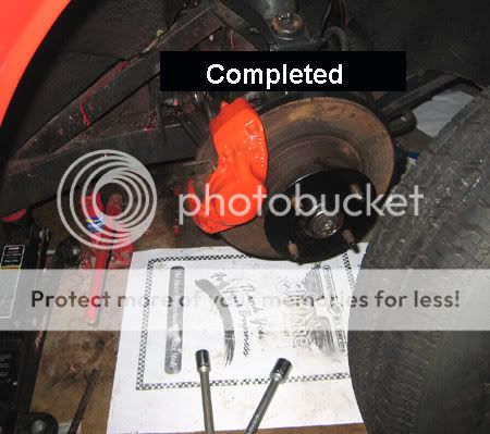

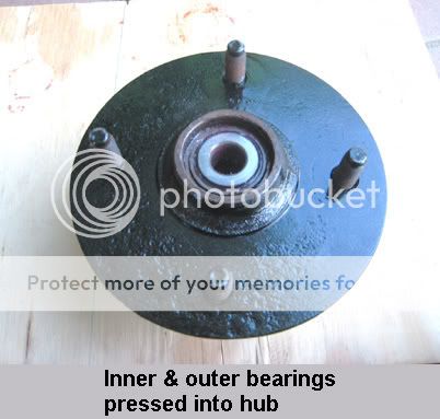

Progress made:
Passenger front wheel bearing install
day three end at 7:00 PM
The inner and outer wheel bearings are both
now pressed into the refurbished hub.
The working area has been cleaned up a bit.
It is now obvious a complete replacement of the
front suspension is badly needed.
Day 4 should see the Crypt Car down off blocks and
in the street.
Uh,
what do you mean "Pressed" into hub. Hopefully you are talking about the outer races. The bearing assemblies just drop into the hub, rolling on the outer races, then the seal holds the inner bearing in the hub, the outer you install after you put the hub on the spindle.
If you "pressed" these bearing assemblies(the rollers) into the races in the hub, I think you will have damaged them.
Thanks for the thought Ron,
No, just the races. I used apiece of 1 1/3" wide flat
steel bar and a tack hammer to "press" the outer races
flush with the hub. That kept everything even and moving
in a smooth manner.
I fabricated a tool from an old flathead screwdriver by
grinding the tip to the wall thickness of the races.
I then tapped the races into final position using
12-6-9-3- clock positions as tap points. The races
seated properly and slid/dropped the bearings into them.
