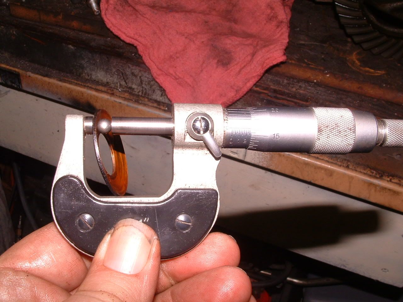

UmmYeahOk said:
Sorry, I thought "ball mic" was the same thing as a "micrometer." Whatever they used, it was the same tool that we had, which I guess is a digital caliber, even though people confuse it with a micrometer.
Ball anvil micrometer (aka "ball mic"):
'Regular' vernier mic:
Digital caliper:
And as I said before (and you've now seen for yourself), calipers aren't good enough to check that a crank journal was ground properly or is worn undersize.

Remember if you are measuring bearing shell thickness for clearnece purposes, then it needs to be done with a ball mic, and for the undersize bearings, half the undsize added to each bearing shell from standard thickness, say for example a .010" under size bearing you would add .005" to each bearing thickness, so a .010" under bearing shell would measure .072" + .005" = .077"

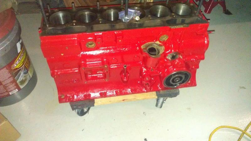

Thank you sir, this is what we needed. After obtaining the Heritage certificate (recently), it confirms that the engine that was ruined is the correct one for the car. I've located a set of main bearing caps, and we're having a trusted engine builder here locally do the work for us, and this is information that we desperately needed since the workshop manual is wrong, and nothing I've been able to find on the Internet seems to have this information.
To address the rest of the opinion and speculation in this thread, if we were millionaires, we'd have 3 different machine shops give opinions, cross check each others' work and get sworn affidavits that it was all done to best of their ability, with a bond. But then noone would want to do the work. Even the engine builder that has agreed to do the work finally tried to turn us away at the door when he saw that we didn't have a domestic block, luckily he's built a few race engines for my wife's cousin, and that bought us a little leeway.
Again, if we were millionaires, I would pay almost $1000 freight both ways to ship a $250 engine (check ebay) to someone who had experience with them. Unfortunately most of the people who've done this work on this type of engine are dead now, so you work with what you have. However, if it was going to cost me $3000, freight and parts, just to get out from under an engine, I wouldn't have bought a Triumph, or I'd swap in a computer controlled 4 cylinder for less cost and be done with it.
It has been my experience that noone takes care of your car the way that you do (if you love it, that is.) And the elitism, condescension, and the assumption that every new person with a love for these cars knows all the same life lessons that you've all learned over time is probably the reason these cars don't attract the younger crowd. I didn't realize the older generations couldn't be trusted. When I pay a professional shop to turn a crank 10 under, and they tell me it's 10 under, I wasn't aware that these grown men needed to be checked up on like 6 year olds. When I order the correct bearings from the largest of the three suppliers of parts for these cars, I assume someone there has gone to the trouble to make sure they actually fit the car they're selling them for. I also don't check every box of cereal I buy for ground up glass, or send the hamburger meat off to the chemist to confirm that it's really made of cow and not dogs or other naive customers. Is this something you've always done as well?
So my point is, when I pay a professional engine builder to do work for me, whether I can operate a micrometer, know one from a caliper, or can juggle three of them blindfolded is beside the point. When I purchase bearings, the specialty parts house I order them from, how many metals are used, or what company made them is not pertinent. I match up the numbers on the box to confirm the box is what I ordered, and that should be the end of it.
At some level I have to trust that not everyone in the world is an idiot, and obviously this bites me sometimes.
Regarding chips - the SCT Eliminator chip for the Mustang is 49-state legal. The headers are Ford Racing Performance Parts headers for GT40P heads, and are 50 state legal (categorized as a factory replacement in CA). The E Cam is also 49 State legal (California allows NO modifications, even if you end up cleaner on the other end, as we did.) The Cobra intake manifold is off-the-shelf Ford, and 50 state legal (in California, it must have been originally equipped with the engine, and in event of engine swaps, must have been equipped or optionally equipped on the engine year, not car year, and cannot pollute more than the factory equipped engine for the given year.)
The issue, UmmYeahOk stated, but might have been hidden behind the fog of judgement, was that we bought a used exhaust system for a 5.0L to save money, because the one from her previous 3.8L engine wouldn't fit. After all the tuning and adjustment to bring the emissions down, an actual GOOD shop (not the expensive highly sought after one that specializes in Mustangs) finally thought to check, and the previous owner had gutted the catalytic converters. Once we discovered that, we replaced them with new and breezed through emissions easily. The intent of the chip wasn't to circumvent emissions, it was to tune the computer maps for the new HCI, exhaust, and to adjust shiftpoints on the AOD-E transmission.
We've got the new caps line-bored by a shop that actually knew what they were doing. Now it's painted and ready to be built and installed, just waiting for us to find the time - actually the caps have been installed already, this is an old picture. It's hard to get motivated to pull out a working, running engine, and then we have to swap over the head, timing chain and accessories.
On the plus side, it'll be nice to have the correct engine back in, and we've been limping along with a transmission that had a cracked slave cylinder mount - it works well enough to get into gear, but knowing that I'll have to pull the engine anyway, I just ordered a replacement bellhousing so that we'll have some solid clutch action again, hopefully.
