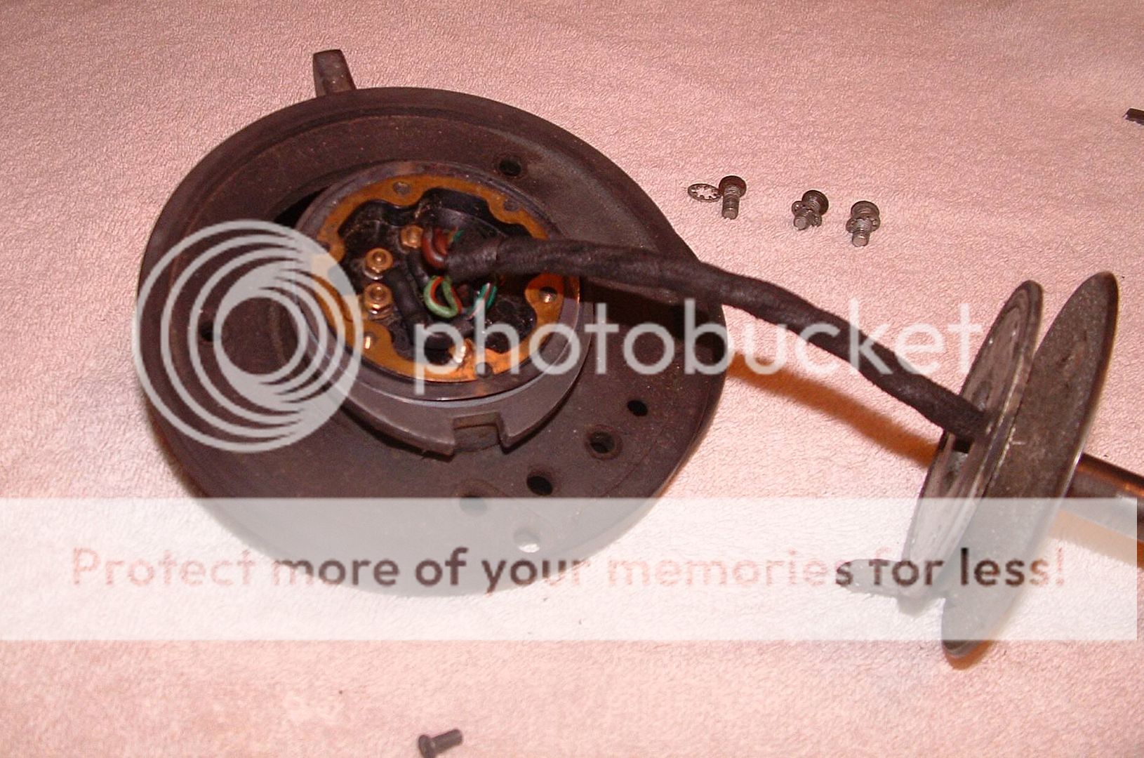

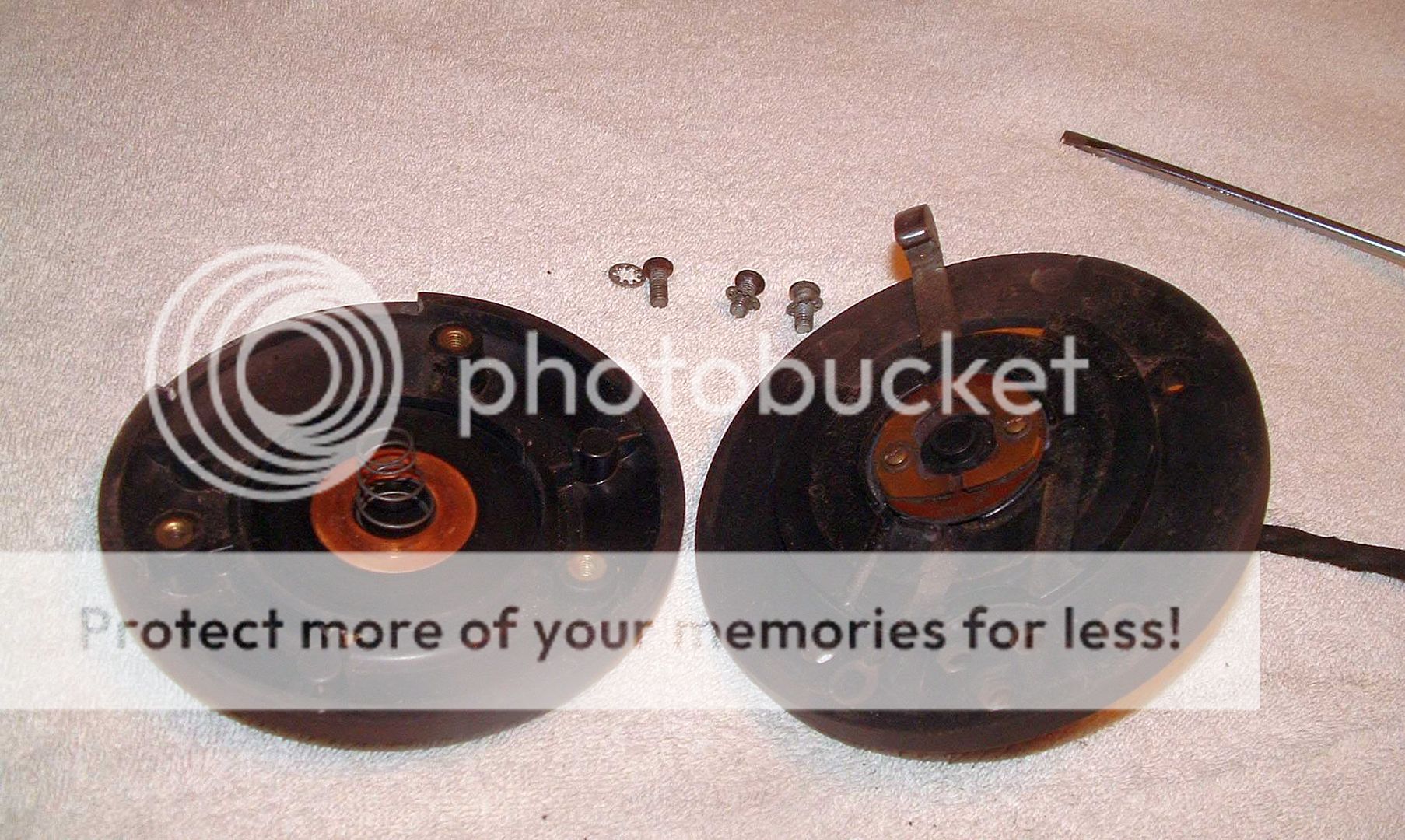

You should be able to leave the switch compartment assembled, which is where the "complicated" springs are. Only the back plate (with the stem to engage the stator tube) and the horn button/cover need to come off the switch. There is one spring that goes under the horn button, but it's easy to deal with IMO.
Basically, you stop here in the disassembly process

Randall’s picture is spot on and the only thing I would add is to move the selector over to each nut as you loosen each nut. This will keep pressure on the brass nut because if I remember correctly, the brass stud can fall out of its key way when the nut is off the stud as you swap the wires out. I have done it the way you are doing it, and you will see more as you take apart the new one. TRF parts are often of high quality and their wire looms are probably the correct size and putting them through would/might not be difficult either, so either way should work. There were some wirer looms around a while back that were just a fuzz bigger and they were a nightmare to get through the stator tube. I tried it once and it was a disaster, so if you go new look real close at the wirer size. I think it is Macys Garage that makes the corrected size wire loom to fit the stator tube hole if you need it and again TRF probably has it correct.

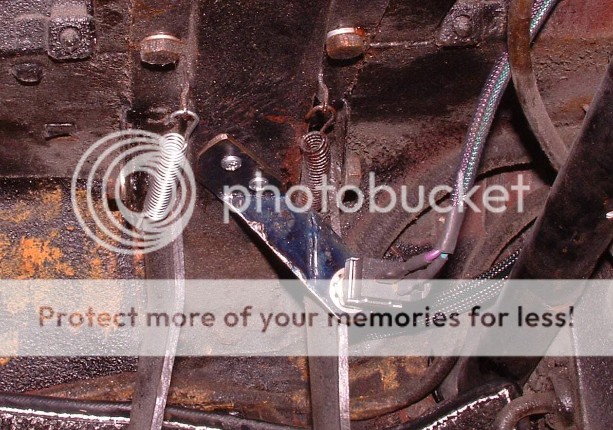

FWIW, The control head harness I got from TRF some years back was definitely larger than the original, and difficult to get through the tube. The individual wires appeared about the same, but the cloth covering was at least twice as thick as the original. I finally had to use wire pulling lubricant to get it through. Unfortunately, the lubricant has dried out and effectively glued it in place. I will probably have to destroy the harness to get it out again.
If I do it again, and find the same problem, I plan to strip off the cotton cloth and replace it with modern poly sleeving. The poly is thin and slick, and while clearly not period correct, looks pretty good IMO.
