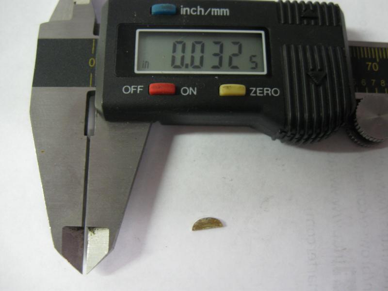

Thank you John. I now see why I couldn't find it or even hear it hit the shop floor when it bounced off of me. I made my replacement out of standard K and S brass strap that measures .032 in thickness. In the attached picture you can see I made very small 1/2 moon key that will fit under the spring clip once it is slipped over it and provide the detent function on the choke cable. Took a little filing to get it right, but now I know. IMG_2550[1].jpg
There you go! The trouble is that until you have moved that little clip and watched the detent go flying out once, you have no idea it is in there! Bet you never let it happen again...I know I won't...

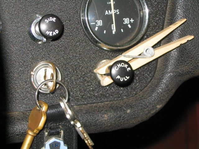

Here's my current Choke Cable Detent Device
I was using the MK1 Clothes Pin Detent as well, but the owner wanted the cable replaced so.......
Hah! The CPD Mk1 works just fine for me. When I'm not using it, I clip it to the tonneau cover.
I have had my car for over a dozen years, and the choke detent has never worked. Geo told me about the CPD...
So that makes Masta and I OCD I guess...
Maybe so, but you have properly working choke cables, and I have a cute wooden kluge...
