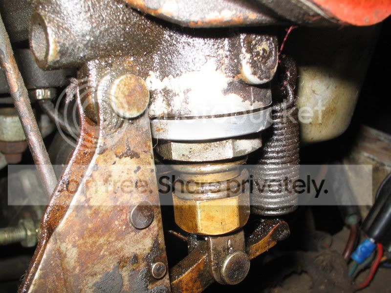

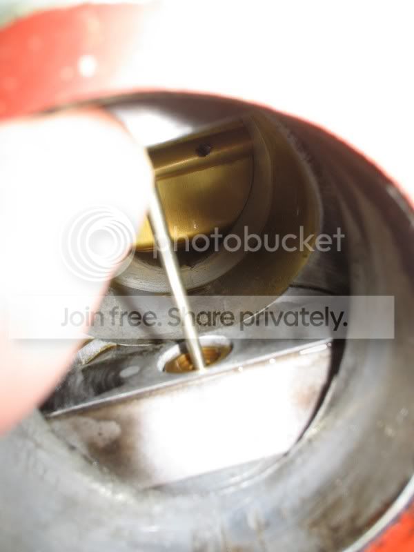

Tom,
I am no expert on this, but from what I can remember the upper bearing is held in place by the spring pressure of the spring between the two cork jet glands. The main nut holds everything in place, but I don't think it will move the upper bearing up or down in the body.
As it is a typically wet Saturday here, I have taken the opportunity to pop into the garage and have a look at my carbs. My upper bearing sits about 1 mm below the top of the bridge and the jet is about another 1/2 mm below that. My main fitting nut is quite close to the body of the carbs. I can remember when fitting these in the past that they seem to come to a stop as a result of tightening against something more than the cork washer.
If you excuse the dirt, have a look at the pics.
By the way we were on Islay and spent a day on Jura and a day on Colonsay. Highly recommended for the scenery, wildlife and whisky!
Nick
