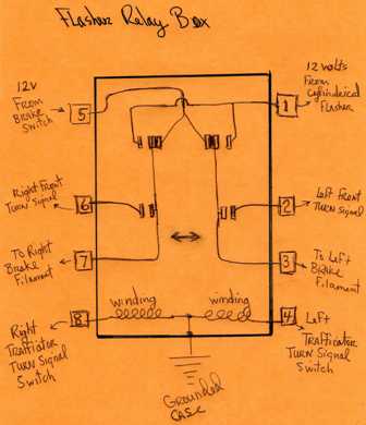

I haven't been following what you have been doing so I am not sure what year Healey you have. But from your avatar it looks like a 100. If so you have a stop light/ turnsignal relay on the the left from inner fender apron. I you say that you have no lights at the rear, (no running lights or anything) and you have the same at the front when you try to use your turnsignal switch at the trafficator on the steering wheel, then please know that the trafficator switch on the steering wheel switches the relay to the right or left. Look at the drawing I have attached and see that terminals 4 and 8 on the relay box are the coils that pull the relay either to the right or left. With ignition on I would check to see if I have voltage on terminal 4 if the trafficator is pushed to the left. And if I have voltage on terminal 8 if the trafficator is pushed to the right. If you do not have voltage on either 4 or 8 then it could be the trafficator or the connections at the base of the steering column (at steering box). the power for the trafficator is the green wire at the base of the steering box and it is ultimately derived at #4 terminal of the fuse block but it is sometimes run from the fuse block to the round flasher unit to terminal 'B' and then run to the bottom of the steering box. The other issue which you say is that you have no running lights either. The running lights have nothing to do with the turnsignals or the brake lights. The running lights are powered off of the Headlight switch. Original factory installation is that the headlight circuit and running lights included are not fused. But maybe you or someone else has installed an inline fuse for the running lights. they would still be powered off of the headlight switch so look for a fuse. well in spite of all this, I haven't given much thought to the blalast circuitry in the Moss LED circuits. If nothing else, remove all that stuff and go back to the stock arrangement and see if everything works. Good Luck.
