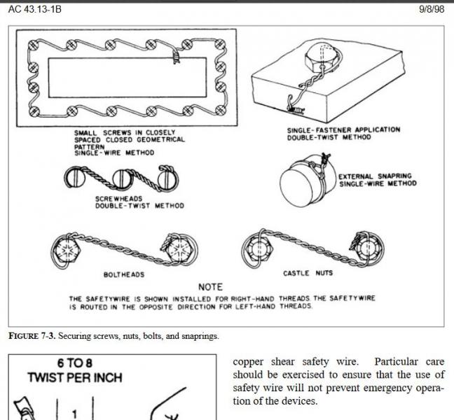

Lock tabs are overrated and, these days, harder to find anyway. I've had good luck with split lockwashers and blue threadlocker; I've used them in sensitive applications like driveshaft flange bolts and never had a failure. If you want to go the full monty, safety wiring is probably the best (and it's how the FAA insists airplanes be held together; secret: always pull down in the tighten direction, and always turn the sharp end down and away, lest it snag the next interloper, like you). One can of SS wire--and what are now cheap safety wiring pliers from Harbor Freight--plus a jig if you need to drill your own--I never have--is all you need. Plus, pretty much all bolts needed for a later Big Healey in 'AN'--aircraft--grade are available and what you need for when your Healey gets airborn:
https://www.aircraftspruce.com/menus/ha/bolts.html
Safety wiring is fun and anybody can do it with practice. Here's the jist:

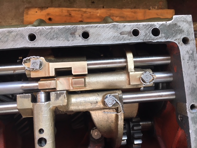

I just did my BJ8's gearbox and it might pass FAA muster:
