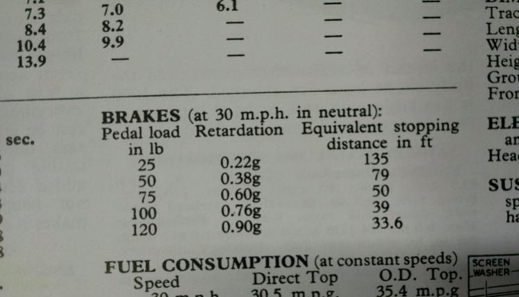

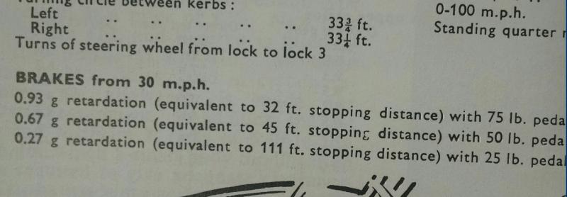

As I mentioned in my opening post, I cannot get the front wheels to lock up even when pushing on the pedal as hard as I can. Someone said their fronts will lock up. I have two questions. 1. If my brakes were working correctly, should I expect my non-boosted brake to lock up under sever application? 2. Does anyone have an old road test that shows what the braking distance (at a given speed) should be on a 1960 Healey?
From Autocar Aug 28, 1959
The Motor - same time frame:
Rob, As I said in my earlier post - you should definitely be able to lock up the front brakes. Booster or non-booster the fronts should lock with sufficient pedal force, and definitely before the rears lock.
As far as I know all manufacturers designed their brakes to be biased towards the front - in the neighborhood of 60/40 front/rear braking bias. This is largely because of the weight transfer when braking which allows the fronts to do more stopping work because of the increased traction. This also means that if you stomp on the pedal (in the rain for example) and lock the brakes, if the fronts lock first you will slide straight because the rears are not locked and still braking much better than the fronts that are sliding. If it was reversed and the rears locked first, the fronts are doing more than the rears for stopping and therefore the rear will try to pass you. This is bad enough if you are braking in a dead straight line on dry pavement, but much worse if you are in a curve or turning any amount or on wet pavement - you will spin. More modern cars have abs which helps prevent lock-up but there is still a front bias.
Old road tests wouldn't be very helpful because modern tire and brake technology is vastly different than 'back in the day'.
Given the monumental advancement in tire/rubber technology, even for bias-plys, this comparison would be pretty useless.
If he can't duplicate the results shown in the charts, wouldn't it at least indicate he has a problem somewhere?
No it tends to indicate the author failed Physic 101
I would assume modern radial tires would perform better than old bias ply in the brake tests, so if I don't come close to the old test results, then I would also assume my brake system is certainly not performing as it should.

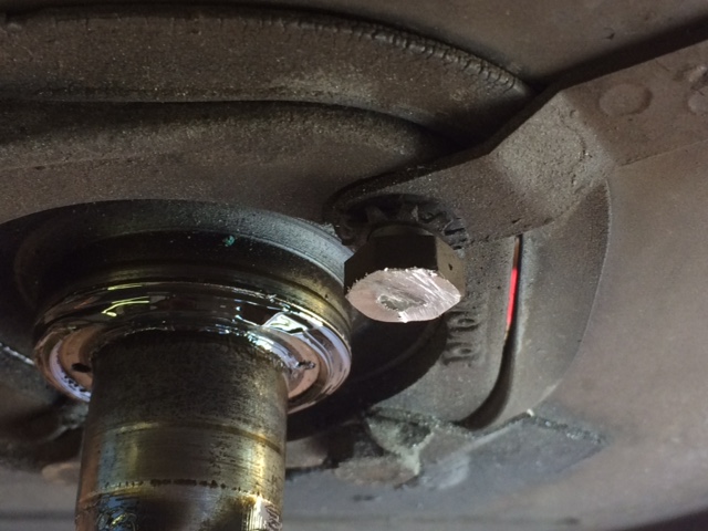

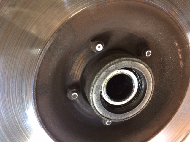

Well I've resolved one of my issues. The clicking noise when I made a right hand turn was due to two of the bolts that hold the backing plate cover around the rotors had backed out and were hitting the bolts that hold the rotors to the hub. See photos below.
I don't remember when I would have removed those backing plates but it had to be 15 or 20 years ago. The parts book says there is supposed to be at metal locking tab of prevent that from happening but I must have damaged that and replaced it with star washers that obviously are not as effective. Good news is it just a matter of tightening the bolts after I build a new locking tab. Moss shows them as NA. The bolts on the left hand side were still tight even without the locking tab.
While I had the hubs apart, I decided to disassemble the front calipers to see if there was an obvious reason why I could lock up the front brakes under a panic stop. Pulled the pistons and although there was a little residue in the cylinders, the bores and stainless steel pistons were not pitted or rough. I blew out all the passages and everything seems clear. I did not break the halves apart since I didn't think it would reveal any more than I could already see.
