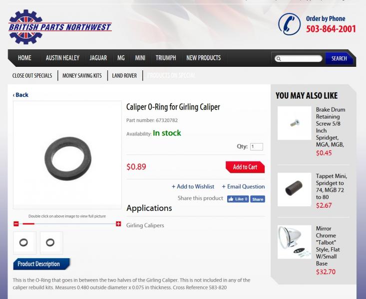

If you have the square-section o-rings, splitting the calipers is trivial. If you do that, you can do a great job cleaning the bores. If you clean them up and make sure the piston ring groove is clean, a few little pits won't matter, as the sealing is between the rubber seal ring and the piston. New pistons aren't expensive either. I'd just get the parts and do the whole thing at once & paint the calipers - it's easy and Bob's Your Uncle!
PS - I think all the angst about splitting the calipers is left over from when the square-section o-rings weren't available.
Well if you do not have one of em square gaskets, U kinda up the creek with no paddle N rocks in U pocket--LOL
EBC - Green Stuff Made in U.K. Organic material. Good initial bite better stopping power. Some dust. Summit Racing has them. I like them. GONZO
Verbiage at bottom. (PN is Moss PN):
This is the O-Ring that goes in between the two halves of the Girling Caliper. This is not included in any of the caliper rebuild kits. Measures 0.480 outside diameter x 0.075 in thickness. Cross Reference 583-820
