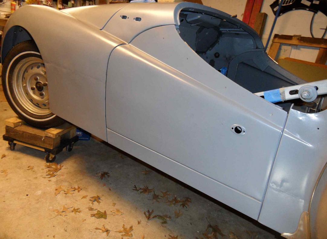

I'm as ready as I can be. Aside from time and warmer temperatures, all I lack is experience and know-how. My neighbor has been a great adviser, but we can't seem to get a day to actually put on some bondo. Where do I start?
My tub and all the panels have been primed with epoxy primer and "bumped" as well as I can expect. I have a gallon of Rage Gold, some hardener, red scotch brites, sanding blocks and paper, paint thinner, lacquer thinner, grease and wax remover, high-build primer, hardener, mixing cups, HLVP gun with 1.8mm tip...

In line with what Pat said, my metal working skills are far better than when I started, but still far from exceptional. I am happy with the work and confident that less than 1/8" of bondo will make it look even better. Knowing how thick the bondo was before I stripped it off, I'm sure to have less. I am not a professional body man, but would like my car to look less like it was done by a novice (that I am).
I don't see the need for significant 'shaping', but much hiding of welding scars, low places, dimples where a dolly can't be used (like above welded channels) etc. I spent hours getting the hood flat, but there's still a few low spots. I've been using a 24" steel ruler to slide up, down and across each panel to see how much filler will be required to make it smooth. I am at the point where the car looks much better in pictures than in person, especially with good light. My goal is to make the car better than when I got it, and I'm sure it will be.
