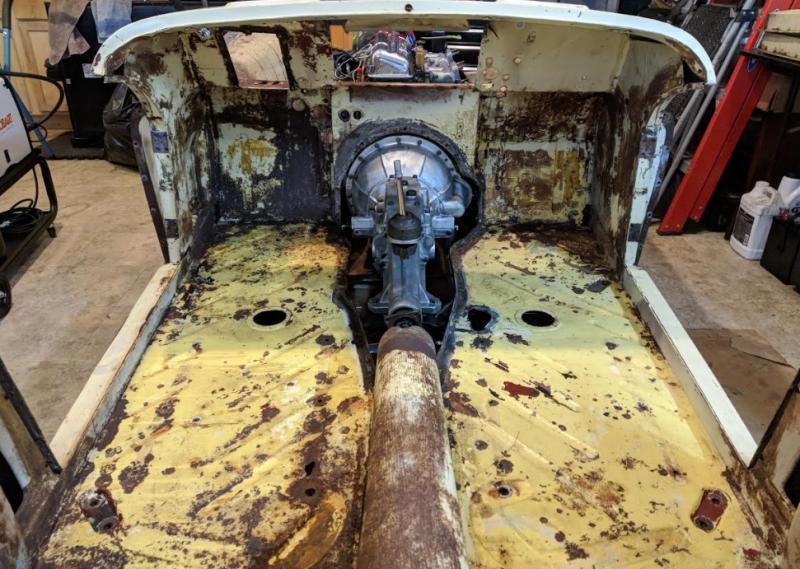

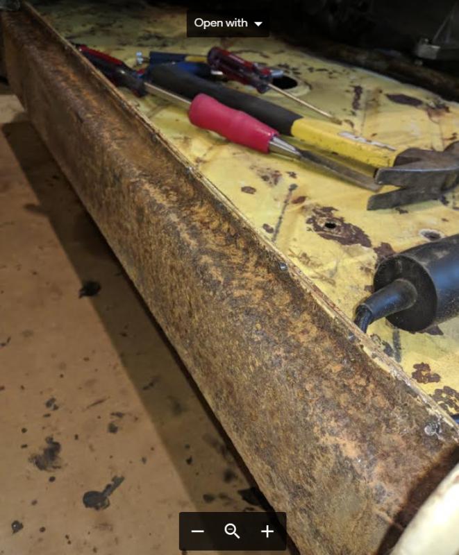

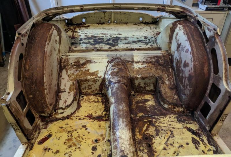

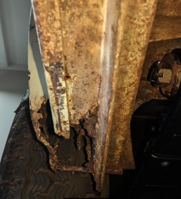

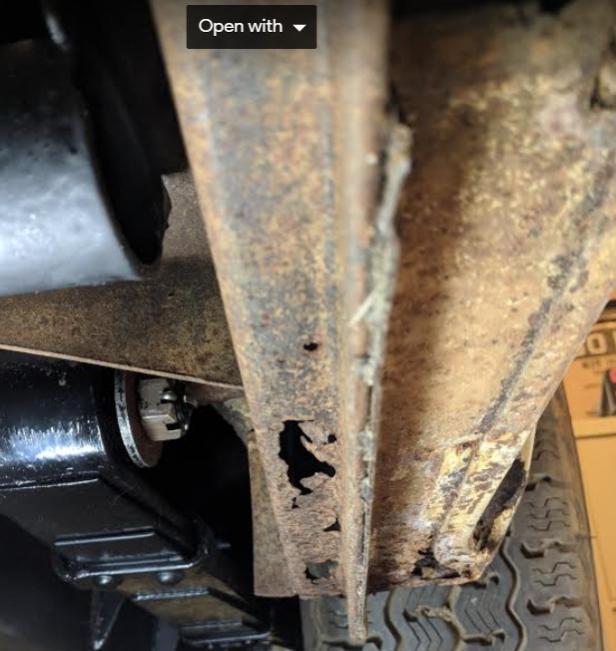

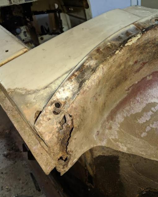

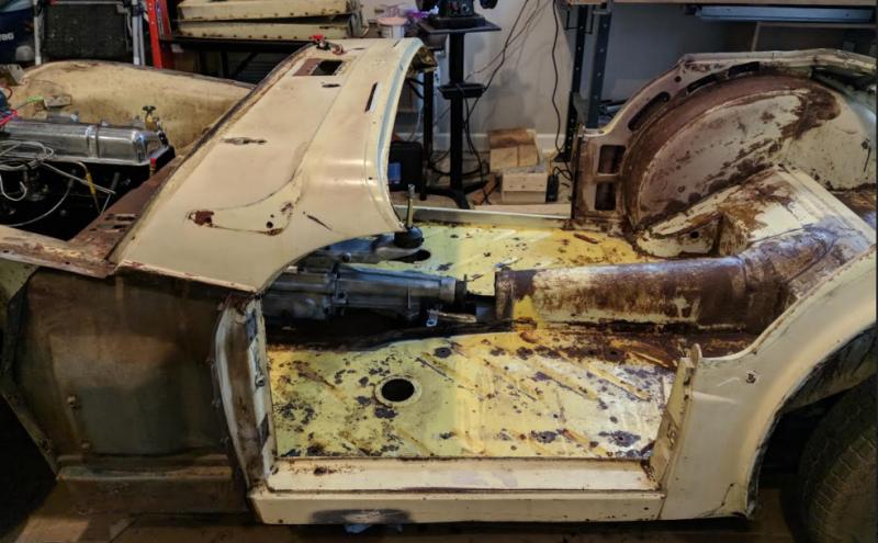

Here are a few pictures to get a better idea of what's in front of me:
Good looking tub; is that the original paint. The car looks like a 1958 in primrose yellow. The inner sills I have found come out of the car difficulty with a lot of work. I used everything from a wood chisel to drill bits to blunt nose rotary files--- each one had its own place and application. I would need to see more of the inner sill to make a firm opinion, but from what I can see in the photos, I would not replace yours.
Sure the outside sills are shot and they comes off easily. I would start there with some chisels and drill bits and blunt nose rotary file to have a better look at the complete car. The part I like about the rotary file is that it will cut only the first layer of tin out of the way and about a ½ to 3/8 around piece grinds away the spot weld to the point where a smack with a chisel or just a complete cut through and separation of the 2 pieces will happen.
The inner sill is the main structural piece for the car and they are open in the back, so that section in the inner wheel well could look worse than it is. in addition The A and B post both weld to inner sill which is the door opening and also plus down along the inner kick panel.
your floor is not IMHO going to come out useable, but might be usable, maybe. I once took some 3/16 plate steel made a pattern and drop that over the whole floor in one piece using 2 of the outrigger bolt holes and the back body mounting holes with a holes cut for the jack access.
Again I would rip those outer sills off for a better look and do some home sand blasting to get an idea of what you have. Do not let someone else sand blast the car; they will trash it. On the top cowl, I usually use paint remover first then sand blast with about 115psi and very fine sand. If you are not used to sand blasting, practice on like the trunk floor or something. Plus that area under the gas tank is usally thin.
But again the tub looks good. please keep posting
One thing that is not apparent at your stage is that if you remove the inner sill, the rear weld point to the B post is behind the sheet metal between the door and rear fender. I had to cut an access hole in the dog leg piece to weld the sill back in.
The paint is original. I believe my father said it was called "Pale Yellow", but I think it's the same as Primrose. Maybe the name changed in 1959, but I'm not sure. For some reason the floor pans are a much brighter yellow. Not sure where that paint came from, but it's original.

Surprisingly nice body! I’m with Steve...take the outer sills off before making a decision on the inner sills.
The floors should not have to come out to remove the sills, however, you will have to lift the body to work both the upper and lower sides. This means you will have to unmount the body to remove the inner sills, and remount to install the new inners. This is assuming you have to change the inners. You will save untold work on the floor and “B” post if you can save the inner sills.
Like David says, the very first step should be to remove rust by whatever method you plan to use...sand blast, soda blast, wire wheel, etc.
I look forward to following along!
I think you will find you can save the floors and the inner sills which will make the job a ton easier, and it is still going to be a challenge. How is the trunk floor? It looks like much of the brown in the photos is dried glue at least on the outer wheel wells arcs. Do not throw anything away even if it looks unimportant. The fuel lines changed somewhere around your cars production, some had shut off valves and some did not. Either way, save all the lines and little clips that hold everything in place and take pictures of those places where clips are use. Saving the pieces will give you a template if you do replace them. The little clips for the fuel line back section are not available and difficult to fabricate and they could be still on the tub.

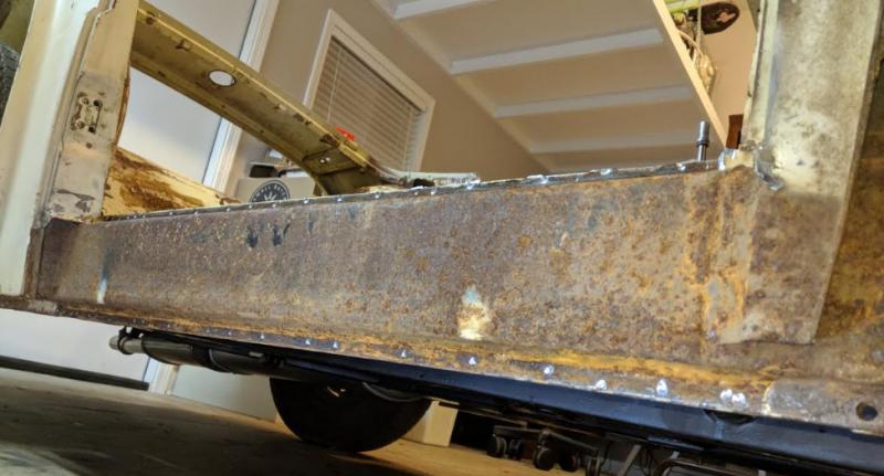

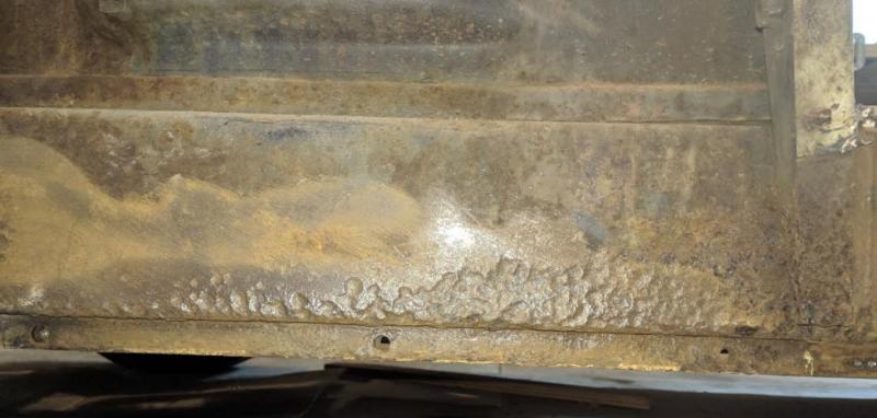

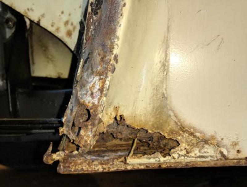

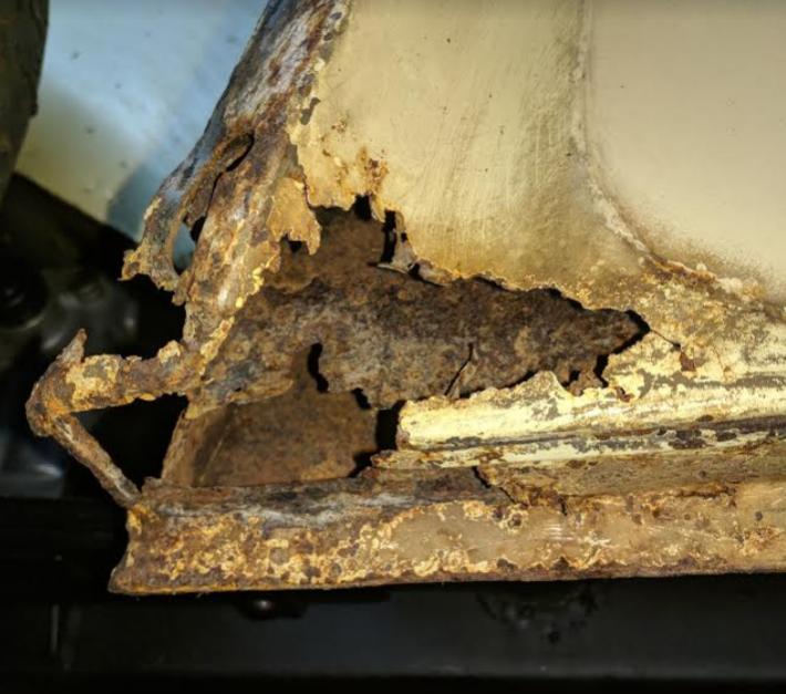

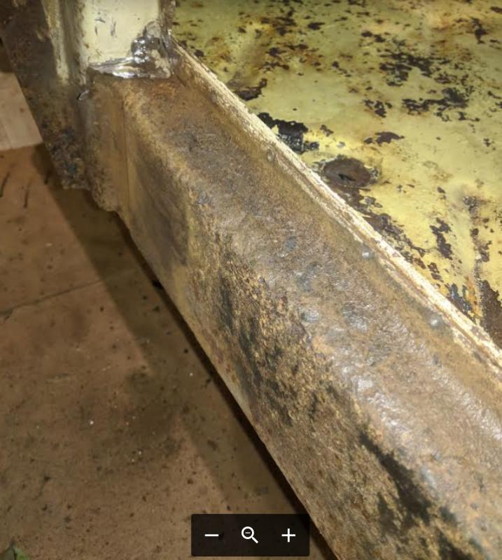

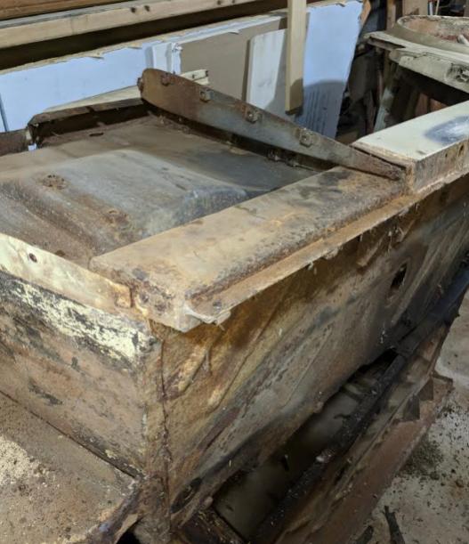

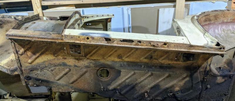

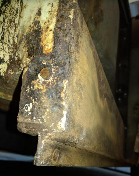

I removed the outer sills on both sides, and to my untrained eye they don't look too good. The lower rear 4-6 inches appear to be rusted out, and there is heavy rust and significant pitting on the front driver side. Is it feasible to patch the sills where they are rusted out without removing from the tub? It looks like the rear 1/4 panel and wheel arch would interfere. From what I've seen so far, I think I need to either repair or replace. I attached some pictures below. Please let me know your thoughts.
Driver Side:
Sill_Driver_1.jpg Sill_Driver_2.jpg Sill_Driver_3.jpg Sill_Driver_4.jpg Sill_Driver_5.jpg
Passenger Side:
Sill_Passenger_1.jpg Sill_Passenger_2.jpg Sill_Passenger_3.jpg Sill_Passenger_4.jpg
Yeah...I think I would go for new inner sills. Since they don’t show when assembled, the pitting is not a problem, but the rust through is. I think you are about at the point that it will be as much work to patch as to replace...and replacing will give a much better result in the end.
The floors are only attached along the upper seam with spot welds. Some of the quarter panel has to peel up to break the “B” post welds to the sill. Last there is the “A” post, but it is a bit easier to break out. If the floor is salvageable, you can do all this with it installed, but pulled inward. If not salvageable, then working on the sill without the floor gives better access.
The last picture looks good, but the other ones paint a different picture. I would replace also; do one side at a time. I think what work the best for me was a “saws all” and a die grinder on the A post with a fine metal blade on the saws all-- you can whittle stuff out of the way and grind the excess off later. I cut a chunk of the inner sill free and left the A post weld alone for a while. Nice clean job getting the outer sill out! What did you use? I think you have this under control as much as anyone.
steve
I went with the patch approach initially on my 60 TR3A restoration but in the end decided to do it properly and installed new sills. No regrets.

The sill came off pretty clean using a drill, dremel, and screwdriver. I drilled all the spot welds, dremeled the corners, and then pried between the inner and outer sills using a screwdriver to pop what was remaining of the spot welds. Took about an hour each side.

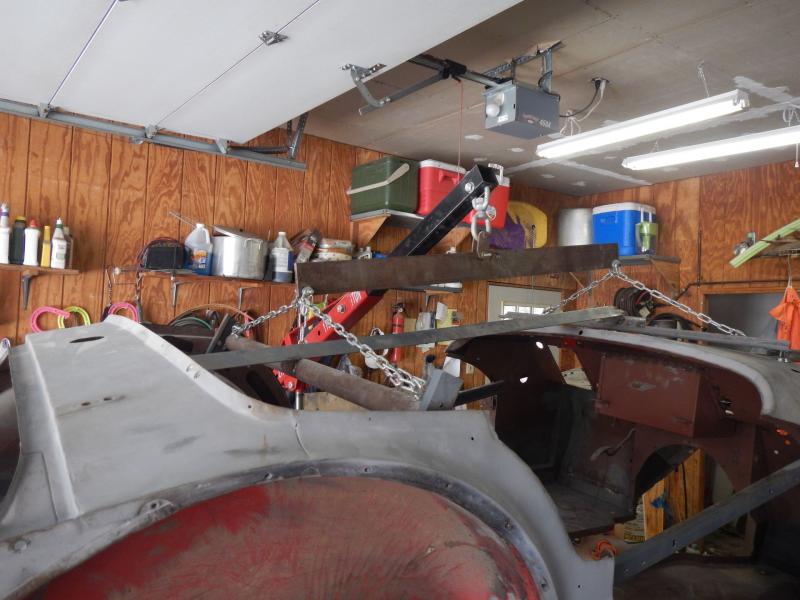

Looks like a sound process. More organized than my work flow but I started with a half completed car with built in issues.
When I lifted the body I may have gone overboard but I attached a lifting bar to the bonnet mounting bolt holes in the front. A bar between the inner wheel arches in the rear and welded a brace between them. Then attached chains to a spreader on my engine hoist.
You may want to leave the 1/4 Panel open so you can weld the "B" post.
