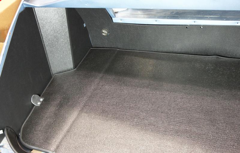

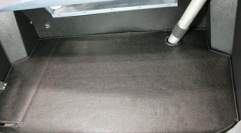

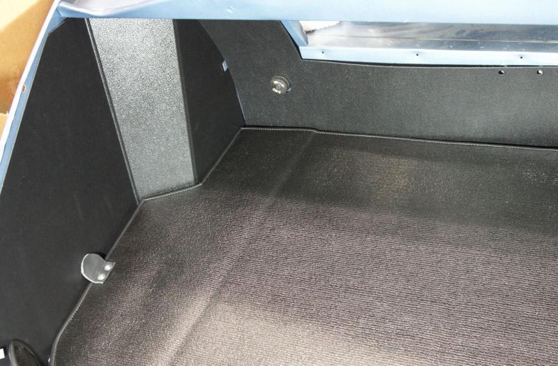

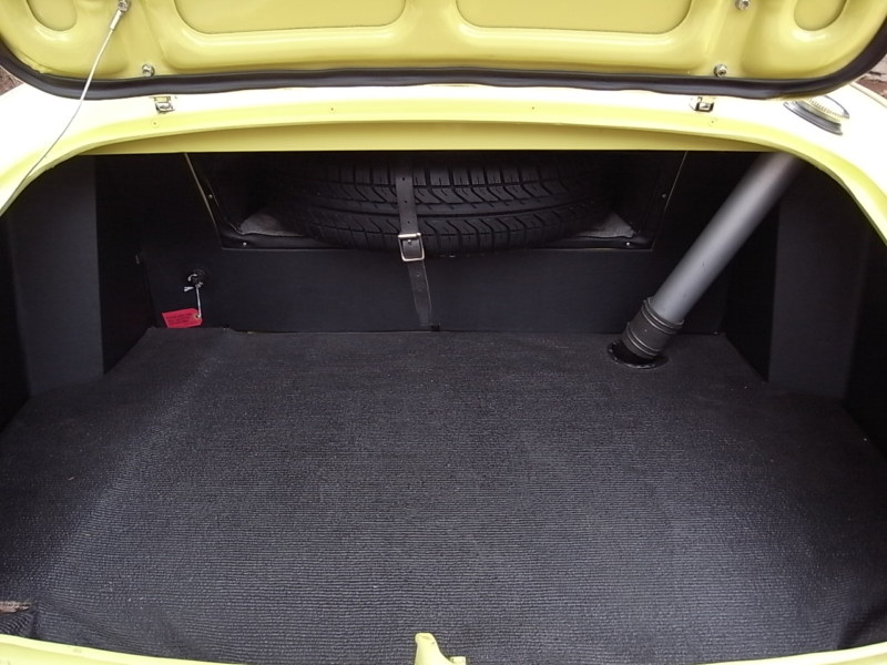

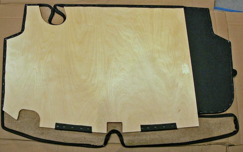

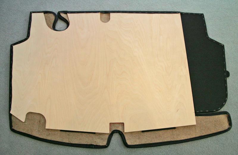

You inspired me to do my trunk. I purchased the kit from AH Spares ($148.59, excellent exchange rate right now.) which comes with the items in the first image. The other pictures are of of my car with the kit temporarily installed.
Thanks!

Duane - this looks like a terrific deal!
Tip: before final install, cut the plywood floor, under the armacord, at a 45 degree angle from the 5 o'clock position of the filler tube. That will enable you to remove the floor later on without removing the filler tube.

Steve,
I really appreciate the tip! AH Spares fortunately made the board so the floor is removable without taking off the filler tube. I did need to modify the board so it fit around the fuel pickup and line.
Thanks again!

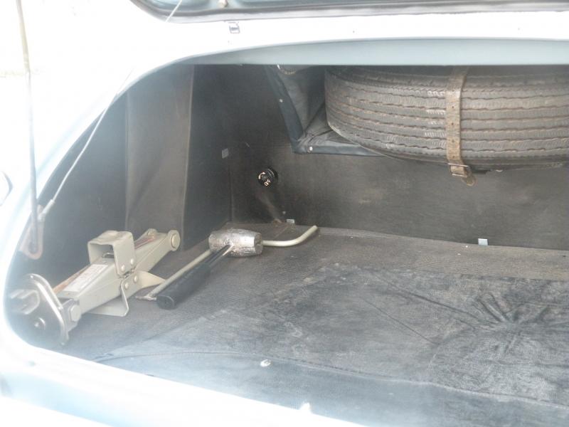

Before
After
duane, are the side panels and the bulkhead pieces upholstered or embossed panel board?
Maxwedge,
Not upholstered, just embossed panel board. I'm planning on upholstering them as they were originally, before my final installation.

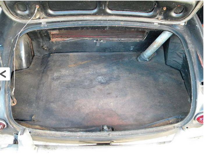

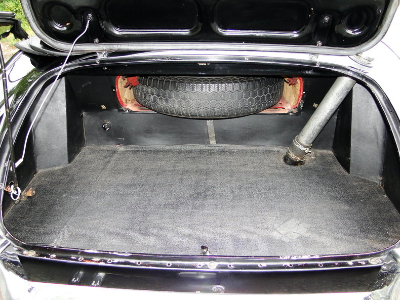

Duane - Do you have pictures of the originals with the fabric in place. Is it armacord like the floor?
Steve,
The originals were plain vinyl covered fiberboard. The Armacord was just on the trunk floor. The last picture of the primrose car was a restoration overseen by Concours expert Roger Moment.
