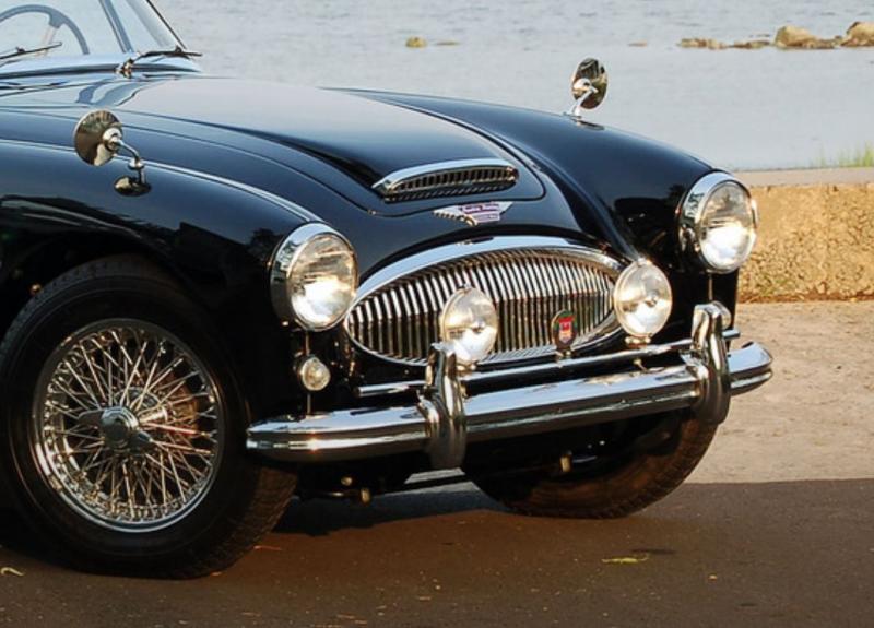

Well, some years have passed now, and this Healey has won the Gold Level Award from the Austin Healey Concours Registry.
And, it is now for sale. Starting offers around $99,000 considered for this museum quality car. View photos below, as they speak for themselves.

That is a work of art. Hope you were able to enjoy many miles behind the wheel.
Good luck.

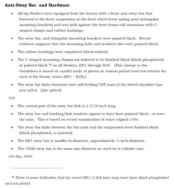

If your looking for 100% concours, the C clamp sway bar brackets should be painted black! (The concours reference below is from the 2014 version.) (Great car by the way!!)
pbraun
pbraun
Good! Already Gold, but that's an easy fix! Will check the feedback sheet to see what else is an easy fix!
