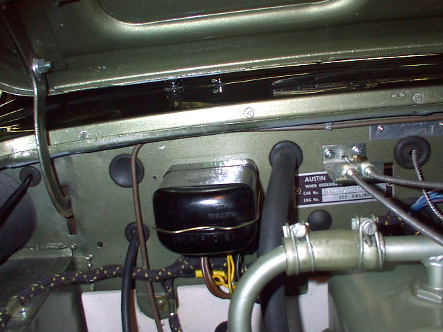

Is this the correct Lucas headlight?

Hi Peter,
Looks like it is really coming together and overall it is looking very impressive. Still, I saw a few things that might not be right. Is that the correct license plate bracket for the BJ7? Mine has a simple bracket that attaches to the rear shroud and the chrome lamp mounts to the inside of the bumper. I think you might have a BJ8 bracket there. I don't believe the BJ7 soft top has the sewn-on drip rail over the windows and the extra flap at the end of the drip rail. Also, I don't see the rear squab, i.e. the backrest for the rear seats. Is that one of the last things going in?
The above, probably not as important for a multi-marque concours (depending on the judges expertise) but when you get the real Healey Dealey it all adds up!

Yeah, you're right, John, that rear license plate bracket is wrong - we are looking for a correct one now, some things are still missing, choke knob should have the large "C", for example, and a few other small bits we are rushing about frantically trying to fix up just so!
The carbs are just temporary...some furflex is missing, as are the grab handles and window handles, also, we need another decal for the hydralic canister with the small white block lettering BRAKE, and CLUTCH, and the screws on the o/d relay need to be simple flat slot heads, not the slot/phillips now fitted.
Other than that...... wish I knew what else we need to get it to conform to the Originality Guide for the Healey Concours Committee's standards. We are working hard to get all the right stuff done. It sure is a long road, and winding, too /ubbthreads/images/graemlins/smile.gif, but the feeling of satisfaction with a job well done is begining to grow as well.
Great job on the car. I have a 63 BJ7 as well and look forward to seeing you at Conclave. Noticed one thing. The serial number plate looks like the Moss Motors part. The one from AH Spares is more correct. It has a silver border around the edge and the font is closer to the originals. Pic is attached. AH Spares also has the chokew cable with the correct "C" on it. They may have the plate bracket as well, if not British Car Specialists should have it as Kilmartin makes it.

[ QUOTE ]
choke knob should have the large "C" ....
[/ QUOTE ]
Peter, I purchased an original (used) choke cable from a BJ7 owner and it looks just like yours. I'm wondering when they changed over from the "C" to the "Choke".
For the Brake and Clutch, the Concours Guidelines recommends transfer lettering, 12pt. Helvetica. I'm guessing that it was originally printed on the canister, not a decal. A good art supply/drafting store should carry the white letraset lettering. After application, a coat of clear will keep it from rubbing off too easily.

Thank you all very much for your comments!...
Steve - Right you are!....... Don't know where that number plate came from, but it should have the silver edge.
Derek - I am pretty sure the body number plates were unpainted. Will check again. /ubbthreads/images/graemlins/smile.gif

We have changed a few things this week - license plate bracket is correct now, cheese head screws on the throttle relay, grille has the bottom 1/2" painted silver, cotter pin on the throttle switch is replaced,proper air control knobs on, pull handles and door knobs on......hydraulic reservoir cannister has the right lettering now, but still in search of a proper top! (Black)
