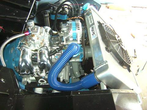

So, after taking some time off to build a house, sell that house, move 3 times, buy a house out of foreclosure and start remodeling it, I have finally restarted my sprite restomod project. Not a whole heck of a lot of progress, still have the chromed dash, still have the 60's era Rader mags. The 12A rotary has been buttoned up, the brake and clutch hydraulic lines have all been plummed to the new wilwood master cylinders, an aluminum scirocco radiator has been mounted in the nose along with a 19 row oil cooler.
Next major hurdles will be installing a street rod wiring harness and plumbing a fuel line from the trunk mounted fuel cell to the carb. Ive switched to an OER 45 sidedraft carb instead of the 4 barrell holley or the original nikki.
