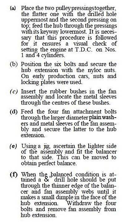

The factory marked the balanced fan assembly by drilling a small hole through the pieces and fan down to the hub extention. This was to make a reference point so if nencessary it could be taken apart and reassembled and still reatain balance. If you are using the original fan and hub extention, a good start is to line up these holes. In Geo's photo you can see the hole on the fan blade on the right in the 12 o'clock position. Since you didn't have balancing weight on disassembly, you may not need them. The locking plate is fairly symmetrical, light in weight and close to the center of rotation so I think it will have very great affect on balance. The tab washer plates can only be mounted between the same bolts as the were originally so I don't think these will influence balance.
Geo Hahn
That procedure seems to just balance the fan -- but I think the original set-up calls for the fan and hub to be balanced as an assembled unit (hence the reference hole mentioned that is drilled thru the fan and into the face of the hub).
TR3driver
Great Pumpkin - R.I.P
:iagree:
It also calls for the pulley halves to be installed.

Got it, thanks. I note the pin hole in the fan and see how it lines up with the pin hole in the hub. Makes sense to me.
Frank, I'll just double check the balance using your method but, since there were no weights when it came off, I doubt I will add any weights unless it is grossly out of balance (which I doubt).
