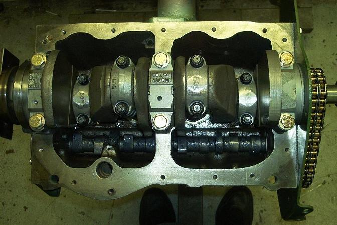

I think more is needing to said about this, most of you know, but I build race and street LBC engines for a living. First off, everything the factory in the way of rotatong mass installs in your engine is balanced, just not as tight a spec as you can get the machine shop to do it, if the compnents had grossly weihgts you know it at much lower rpm range, trust me they do balance it, this is a must. For exmaple the factory balances piston assmblies by simply weighing a lot of pistons and then grouping them to together in lots of 4, 6, 8 or whetever, now their factory piston spec might me +/-2 grams, but that is still balancing. Ok different things are balanced different ways, Piston are simply static balanced, meaning you simply weigh them and then make them all weigh as close as posible which require some simple drilling, milling or die grinder work normally inside the piston on the bottom in a non strength area, ok connecting rods are also static balanced, but that is a little more comlplicated, you need a rod trapese for this, you have to match the bottom weight, top weight and total weight of each rod, can this be done to a set of stock rods, you betcha. Now on to crankshaft, fylwheel, balancer, these items require a special balancing machine in which spins the part like a tire baalncer would spin a tire and wheel and then the machine tells you where the imbalance is and how much, anbd you remove weight in that area to achieve balacne. Here's a picture of one of my race prepped MG 1275 cranks on a Hines computer balancer being balanced. I also included a picture of a connecting rod on my rod trapese getting the bottom weight checked.
70herald said:
I will have to find the crank that came out of the original 1300cc engine in the Herald. It looks like the factory used an angle grinder to balance it!
Could very well be, balancing marks on given component could be drilled holes, milled or grndings, very common, even in machine shop balancing. Hey it does not have to be pretty to be balanced :smile:

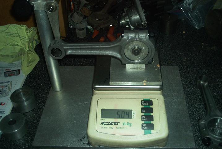

Here's a phot of a 125 perfoamcne street engine I built, it had stock connecting rods, they were blanced by me, I started by checking the weight on all the rods, top, bottom, and total, noticne you'll see the lightest rod of the bunch weighted 509 grams on the bottom, and the other three a wee bit lightening doen to them to mathc the benchmark rod (the lightest one of the bunch)it was done by simply using the bench grinder and removeing a bit of weight off the bottom of the rod until I got them all within +/- 1 gram.

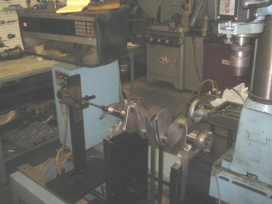

Just for the record, my engine parts were all balanced as Hap did above, as shown on the pictures on my site. The Fidanza flywheel was checked by the machine shop, but found to be in perfect balance when it came out of the box. I had heard from several others who had theirs checked and the result was always the same, perfect balance.
But that is not to imply that you shouldn't have it checked just to be safe.
You can noramlly trust a aluminum flywheel from a company like Fidanza to be nuts-on, balance wise. A flywheel out of balance would show up preety quickly, and you have to consider probably 80% of thier customers are bolting a aluminum flywheel to used engine, so balance right out of the box has to be right, or they would be out of business pretty quickly, same deal goes for clutches as well, they are factory zero balanced.
