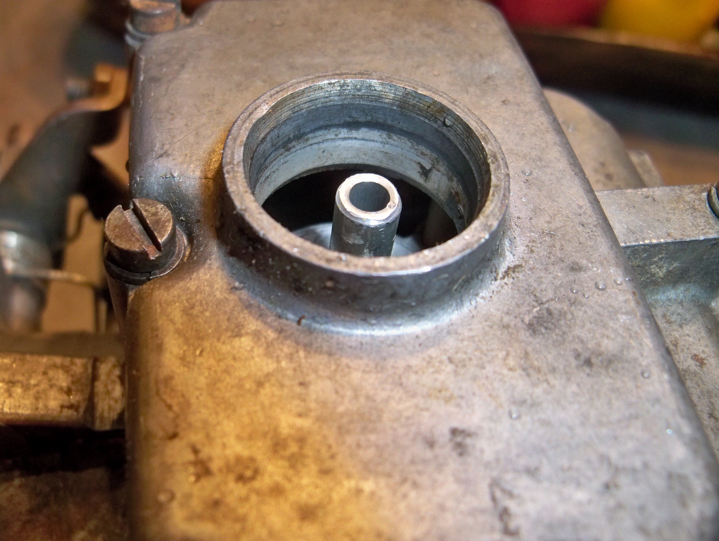

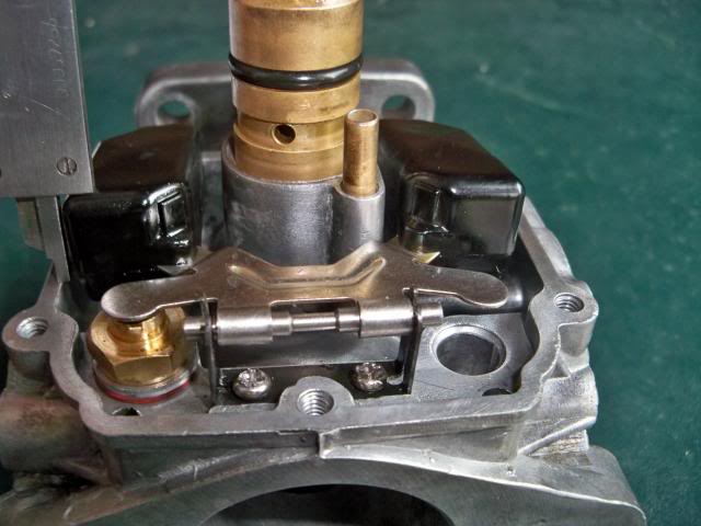

I,m not crazy about the kind of plug you have, but that's not the real problem.
There are 2 types of float chamber plugs. You have the screwed in. Here's some pictures. From them I think you'll see what you can or can't do by just removing the plug..

Looks like I am screwed in as well. I think the float is stuck shut. If I pry the plug out and little or no fuel comes out, that will prove the float is stuck shut - right?
Not so much the float...they don't tend to stick....but the needle valve, that's another story.
I meant needle valve. Back in college, I rebuilt a GM carburetor from a Pontiac or Olds (I forgot which) belonging to a fraternity brother and called the needle valve an "elk's tooth".

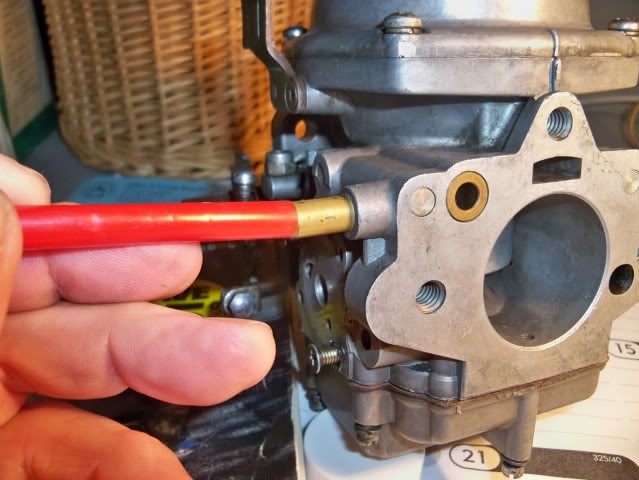

If you just want to see if there is gas in the float chamber there's an easy way.
Get a soda straw and blow into this nipple... OR if you have a pre 73 carb, into the round unthreaded hole (brass in this picture) in the carbs air box mounting flange.....while lifting the air valve up with your finger.
If there's gas it'll bubble up under your finger.

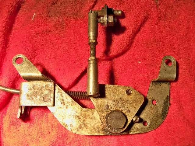

The back carb has to come off - a miserable, stinking job, working blind with sweat running down my face 1/4 turn at a time with an open-end wrench. I've got 3 of the 4 nuts loosened or off and the choke, gas line and emission hose disconnected and I loosened the linkage connecting the throttles at the back carb end but it's not budging. Before I ruin something, do I have to loosen the other two screws so I can slide the flex part off the back carb so I can remove the carb? As usual, the manual is no help.
You have to have all 4 nuts and washers off the studs where the rear carb hangs AND the bottom left nut and washer from the stud on the front carb..Then you can swing the throttle linkage mounting bracket out of the way so that the rear carb can be removed from the studs.
As far as the carbs' throttle shaft linkage, you really just have to loosen one end of the coupling that is attached to the rear carb's long throttle shaft, but you can loosen both on the rear carbs throttle shaft and slide the coupling over the long shaft.
This shows the bracket and why it has to be removed from the studs on both carbs.
