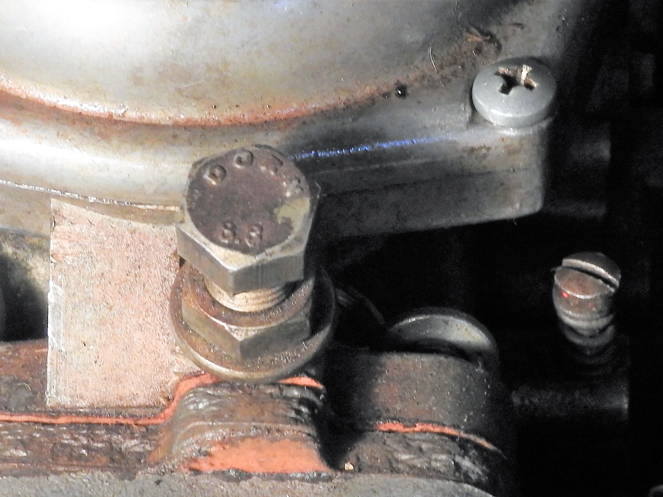

More work, eh? OK. What is this bolt on the manifold end of the rear carb? Is something supposed to go there?

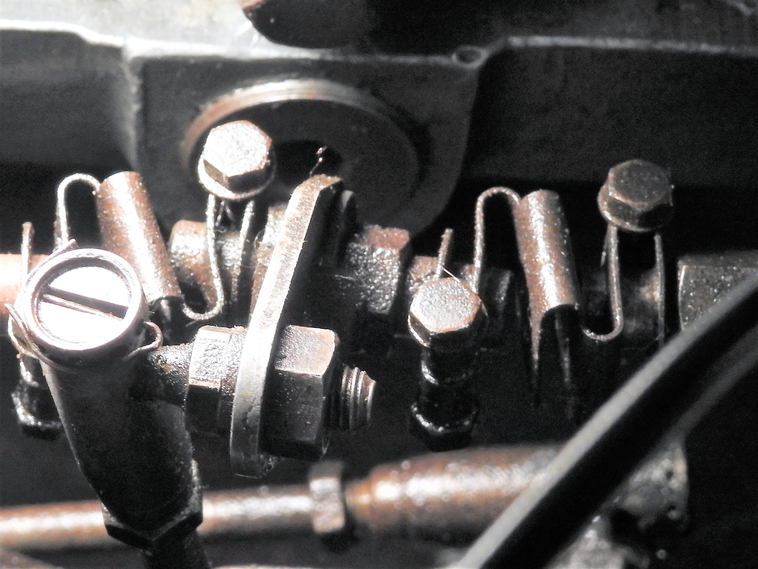

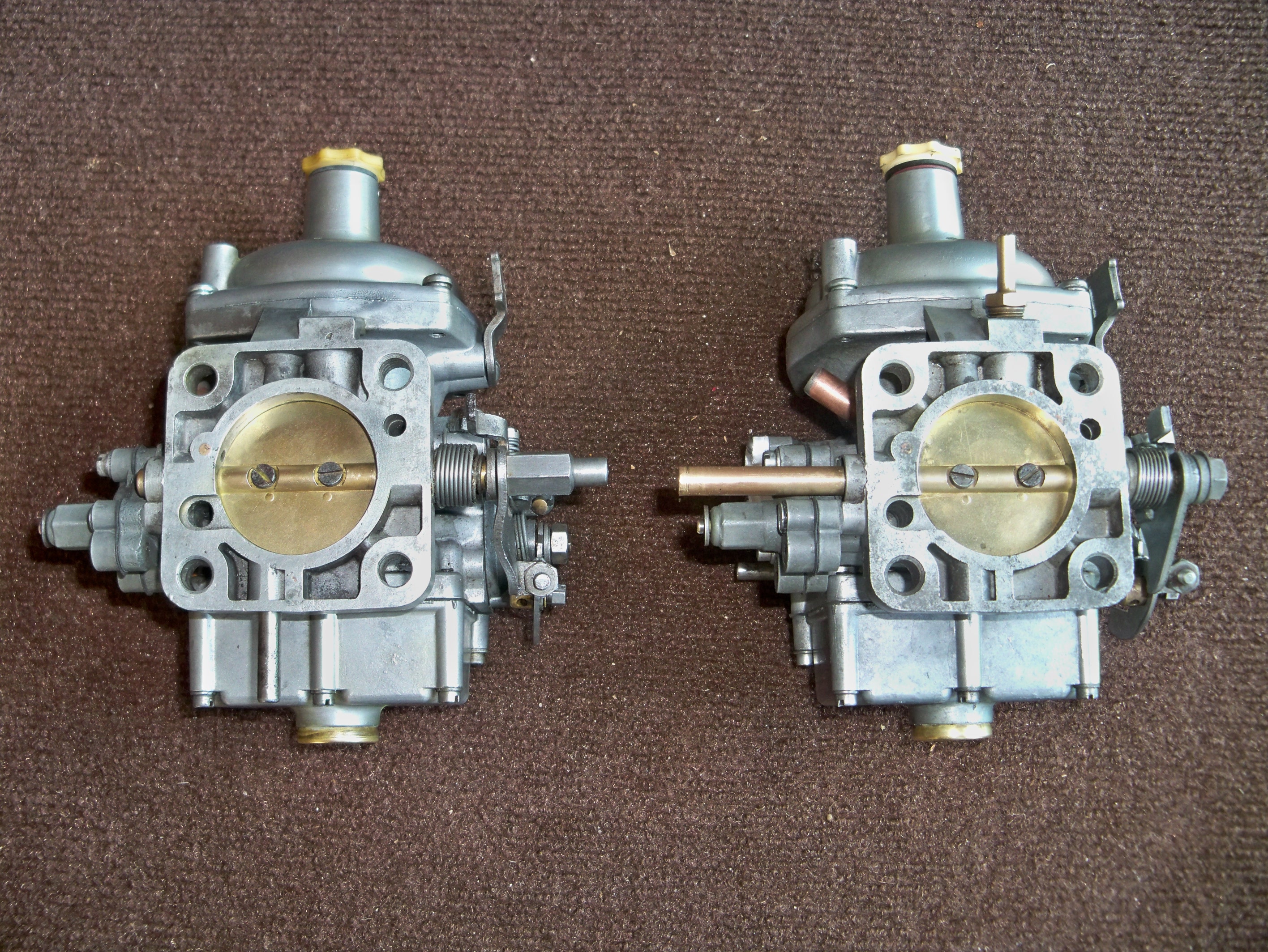

There is a threaded hole there for a vacuum nipple...on the rear carb it would have been the location for the nipple that supplied vacuum to activate an EGR valve screwed into the cylinder head.
