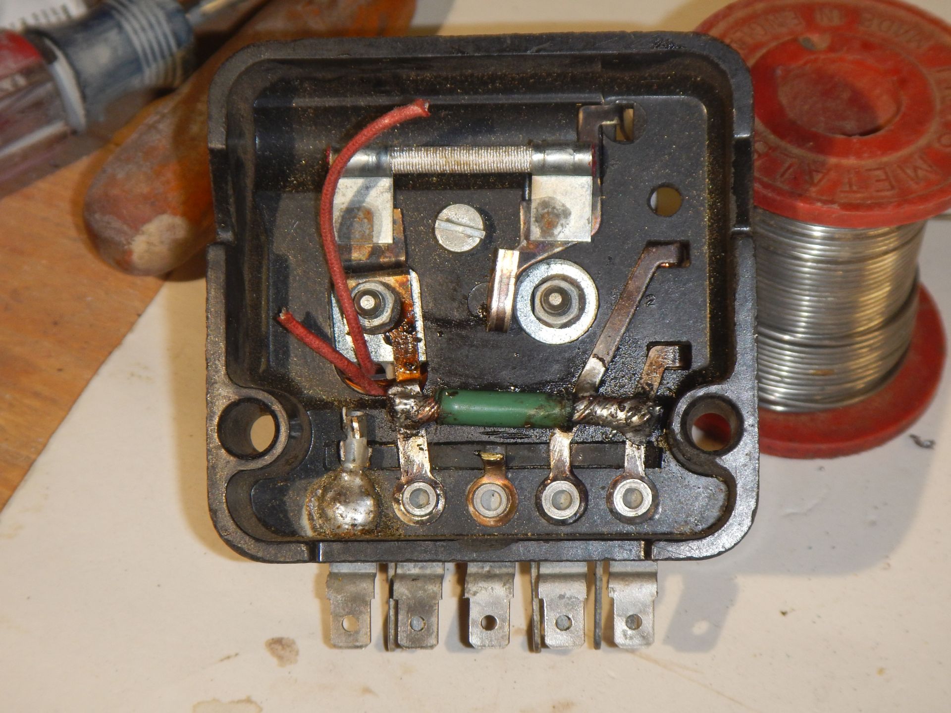

This is what I did to my regulator box as per Randall's diagram.
David

I do not want to "hijack" this thread but I will go ahead since it is directly related. Basil if you feel it is inappropriate let me know (or anyone else). David - I see you are not using E and F but Hamish is using them. Can someone explain in simple terms (for me) why it is done both ways and is there a advantage to one way over the other. Another dumb question - are the leads that you are soldering to cut or do you just solder to them and that takes care of it? They don't look cut. Is the "coil" assembly simply left in place or removed? Bruce
Bruce I have NO electrical knowledge and followed advice from those in the know in the tr register
I did cut the “fixed” metal strips
And my observation was the connections for the thick wires join to each other and the same for the thin wire connections.
I also removed the innards ( use it to keep spares like a plug. Fuses and spare electronic ign unit.)
I suggested disconnecting the F (field) wire because it can be "hot" with the generator/alternator output voltage. If the other end is not connected to anything and is well taped, it won't matter. But on general principles, I'd keep it unpowered. I would also disconnect the E terminal, so it is no longer connected to the chassis. If you don't, the cutout and regulator relays will still be powered. Probably won't hurt anything, but they still will suck up current unnecessarily.
Or, just gut the innards of the regulator, so nothing inside is connected to any of the terminals.

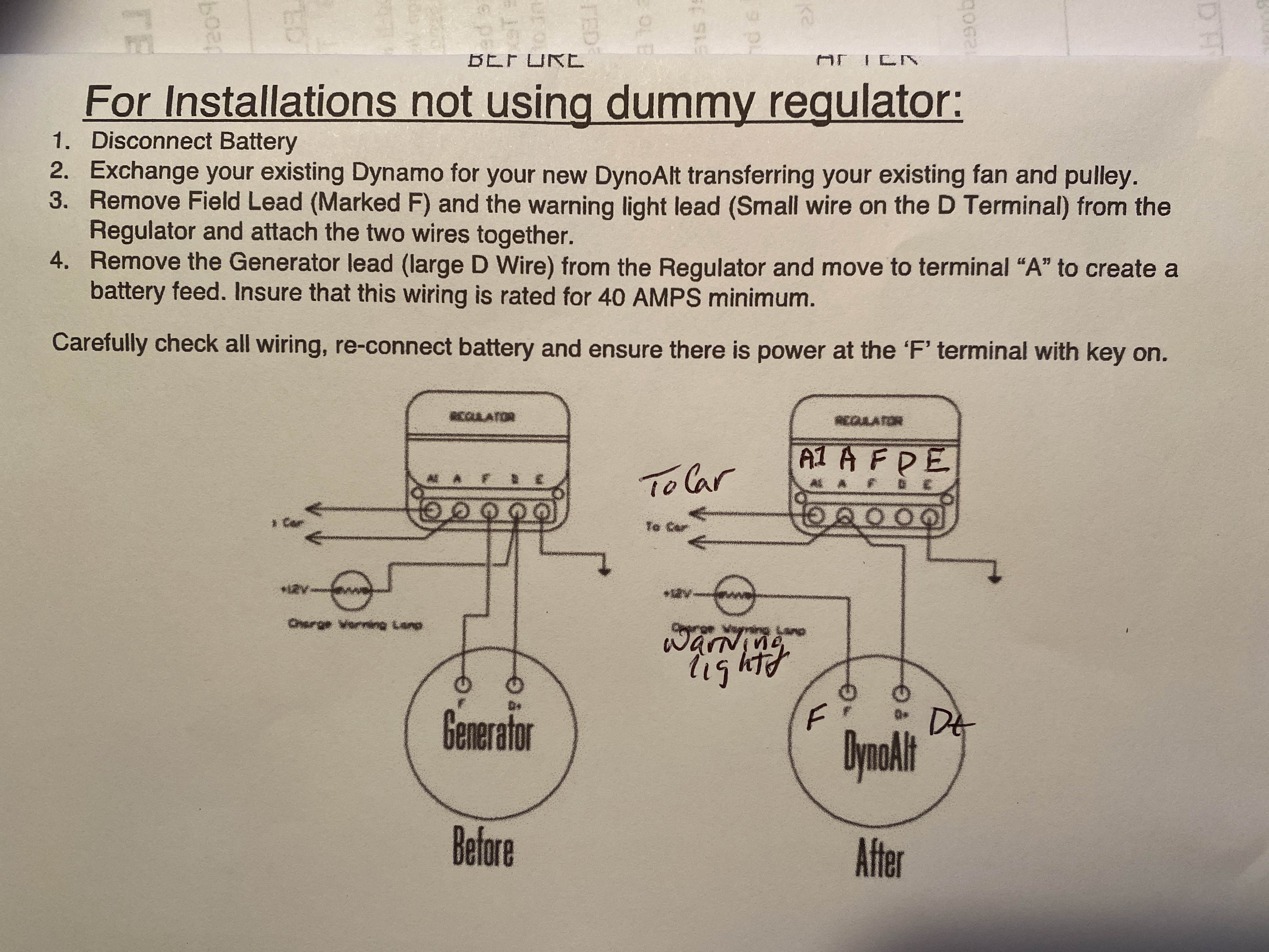

Dick sent me this instruction which came with the Dyno-Alt (which I have misplaced somewhere). I am not knowledgeble but this seems different from what I am seeing above. F is disconnected as above but E has a lead coming off of it. Since the instructions do not call for any internal "shunts" or disconnects I am not sure how this translates to the above methods. I don't see me going back to a generator but I suppose this method is more reversible. I am fairly confused now. Bruce

I believe that is the mod Randall posted.

If you are using an alternator with a built-in regulator the original control box is only there for show and a convenient connector for the charge light, amp meter, and battery charging connections, so the internals are now obsolete.

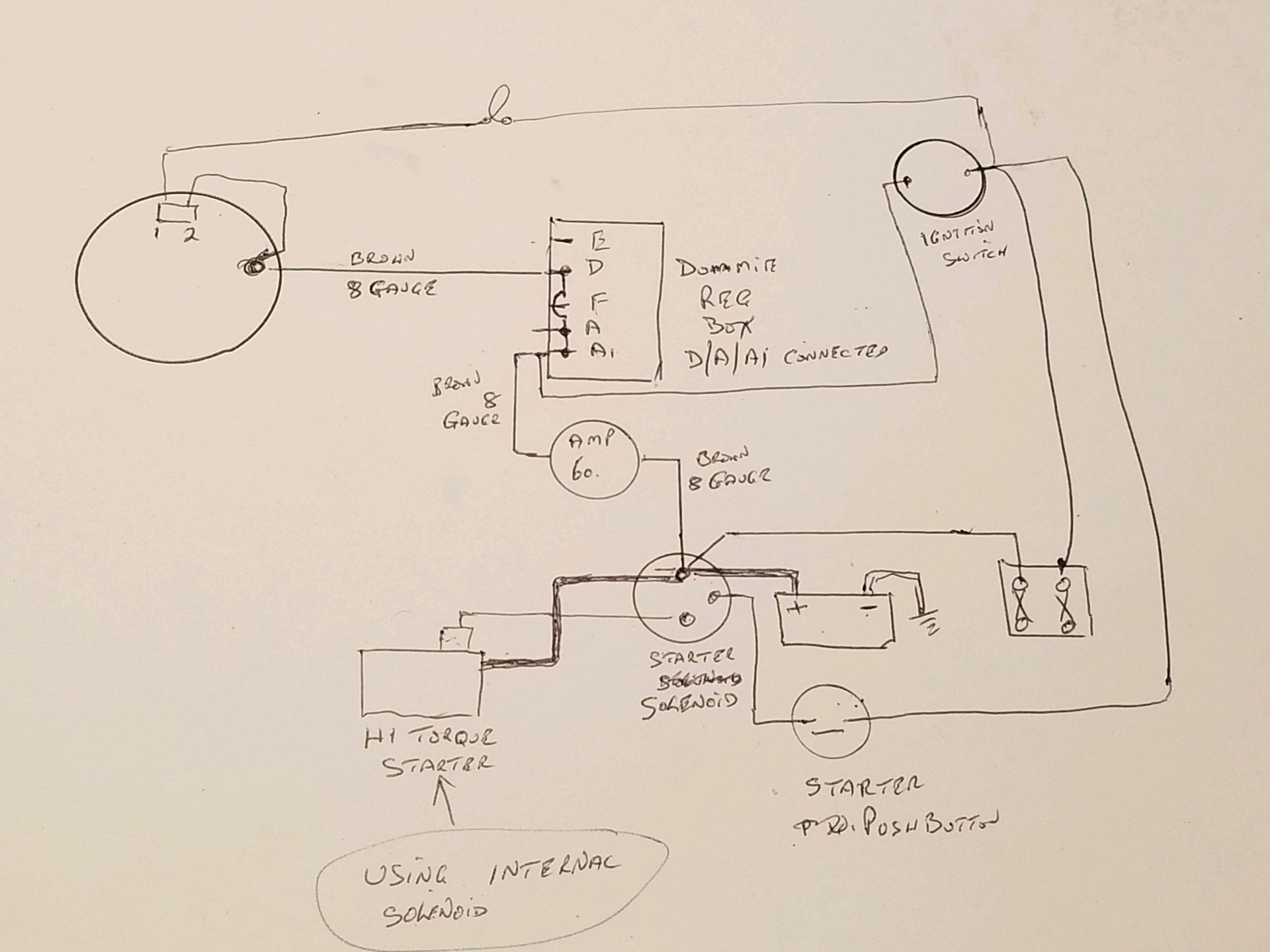

I get that it's function is not needed anymore. I do want the box mounted for looks. Obviously all the above work. So I will just pick one. The great Randall was never wrong so I will use the picture that David posted of his recommendation above to do the modification. Bruce
Actually, I think that the picture in Bammons' post should be OK. As long as the D and F are not connected, you should be OK. Or, you could bridge the A and A1 as in David's picture, but I would not connect it to the D terminal. That would prevent powering the existing regulator's coils.
David - Thanks for the drawing. For someone like me this helps. My altenator is only 40 amp and I am using a high torque starter as well so this is the way I need to do it as well. Bruce
Hello Bruce
Notice I wired my High Torque starter so that the original solenoid acts as the switch for the starter. This way I can use the button on the solenoid when I am working on the engine.
David
