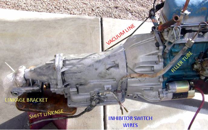

Would the datsun 210 automatic behind a 1275 with the conversion plate be an option?
They can be fit to the Morris Minor, but very unlikely you could fit it to the Sprite with significant modifications to the tunnel and crossmember.
