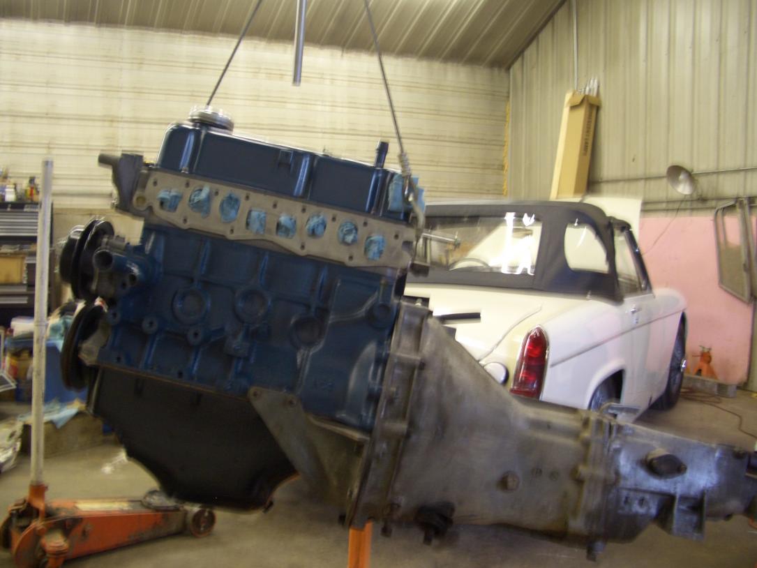

My next spridget transplant!!
This is the b210 engine rated at 80hp stock but overbored 1mm. I have far less invested in this than in a rebuilt 1275 which is probably the main reason I've done it. These aren't world beaters but fit fairly well and are rock solid reliable.

I thought someone said the B210 tranny wouldn't fit in the tunnel? Or is it just that the B210 tranny won't fit on an a-series engine?

If you need some measurement's PM me!
