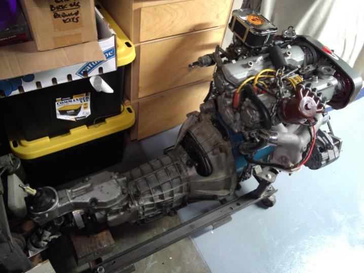

Another good engine swap option is the Fiat twin cam. It's short, powerful, classic, and beautiful. Up to 2.0l. Use the 124 trans. Here are some pix I saved of one going into some spridget.

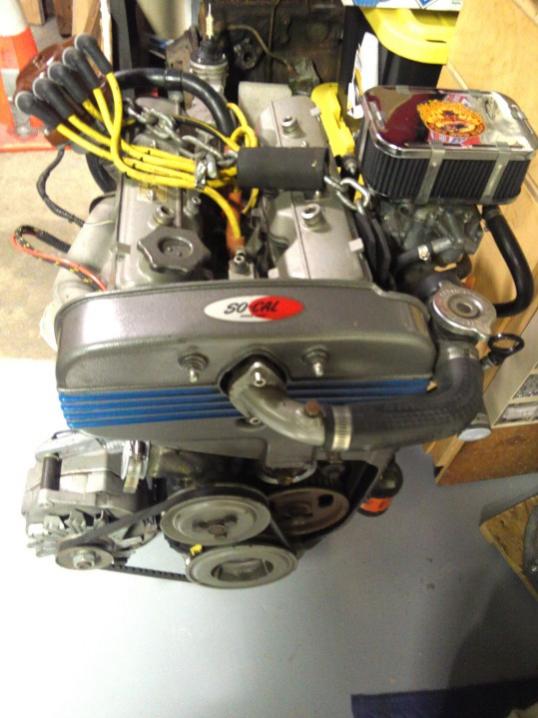

I have a 2 liter Fiat Twincam w/5 speed, but it's slated to go into one of my Morris Minors. The engine bay in the Morris is very short, so it would easily fit the longer engine bay of the Sprite, but the larger gearbox needs the gearbox cover increased in size considerably. The Morris having much more room when it come to the transmission, would certainly require serious modification to the Spridget tunnel.
What model Fiat is that engine/trans out of?

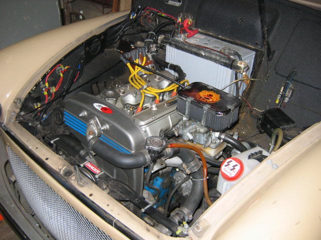

124, I think. I bought it off a friend, so don't know a lot of detail other than it has Elgin cams w/adjustable degree cam sprockets and has about 130HP. It's fairly fresh (maybe 5k miles). It used to be in his car, but has been superseded by a 350 Chevy.
Hope to put in this one of these days...

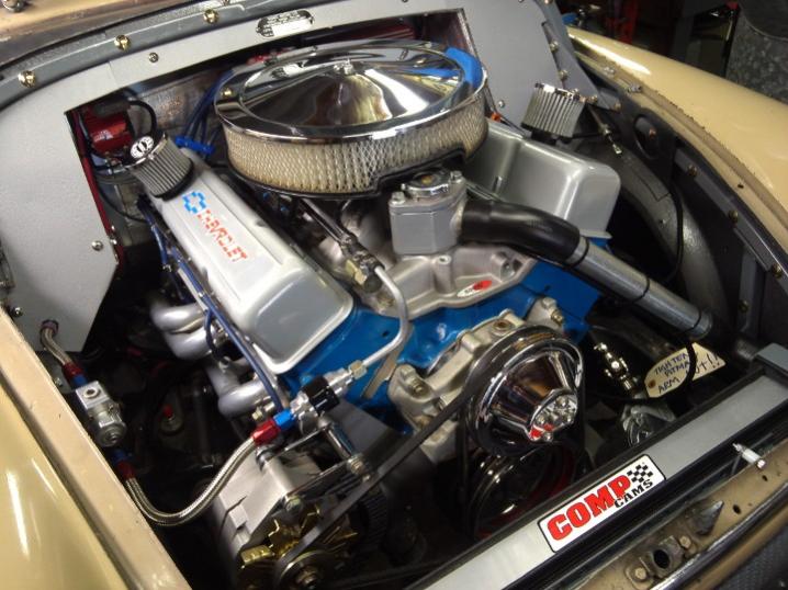

A little bit of overkill.
Wonder how many part's of a Minor you can break with a hot 350 in it! Looks to me as if the Fiat is about right.
Kurt.
Kurt.

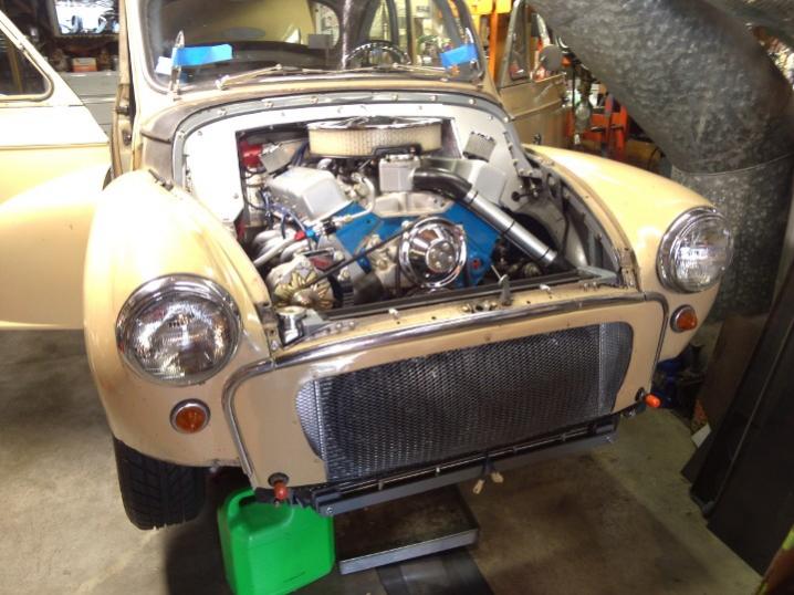

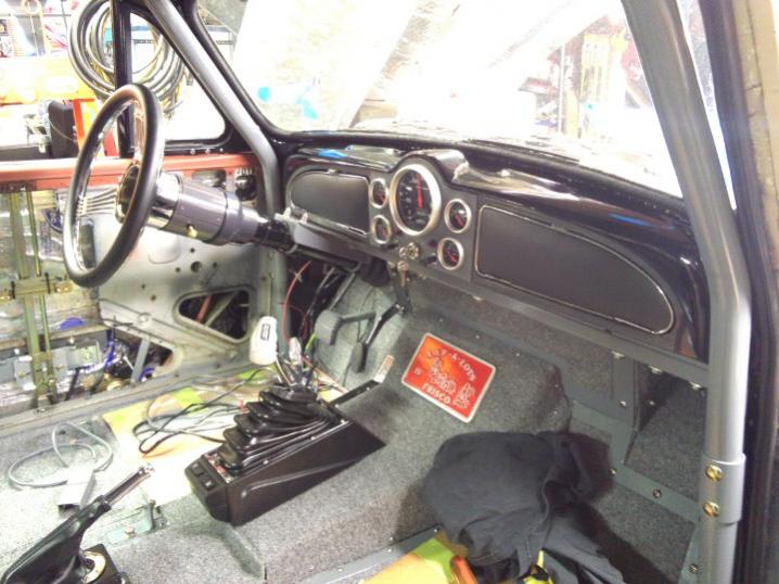

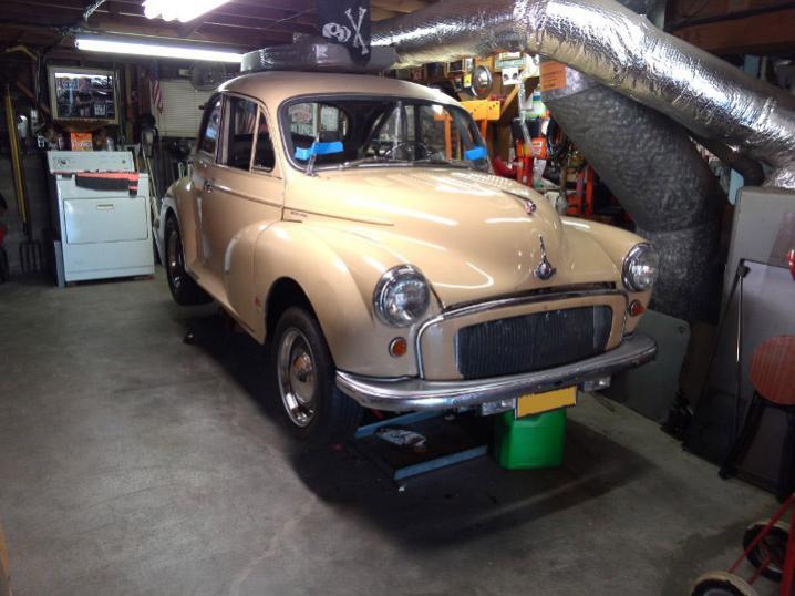

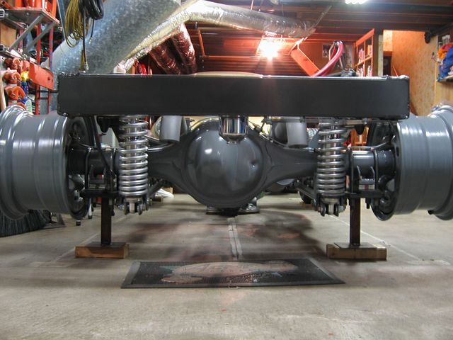

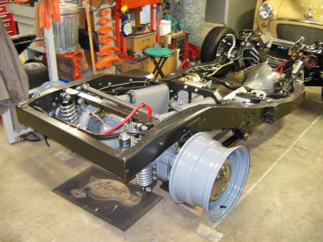

Well, the Minor part (pun intended) is pretty much skin deep... It's built on a shortened and narrowed S10 chassis, and believe me, it's done right (see pic) looks pretty much stock from the exterior. If you didn't look under the car or under the bonnet, you'd never guess.
Firing up the motor might give the game away, too, I suppose. :jester: Very nice, Gerard. I really like it.
Thanks Rick, yeah, it'll be a sweet ride. He's almost done with the wiring, so it'll be on the road soon. I'm looking forward to my first ride in it.
The muffler are pretty quite, so while it won't sound like an A-series, it'll be more "hmmm.... somethin's different" but it won't be a dead giveaway.
Wonder if he can fit a parachute in the "boot", he might need it!!
It is nicely done, Gerard. As mentioned the "Minor" looks like its rather minor!
Kurt.
