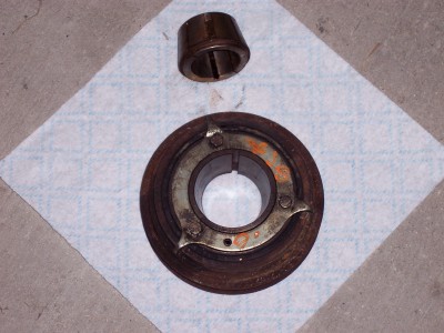

The used Harmonic balancer arrived. Photo depicts the rear side. John Farrington's source was correct. The three fingers are attached to the part of the balancer that attaches to the crank.
The rubber that has been the basis for discussion is visible in the photo arround the outer edge of the finger ring. Only the outer portion of the balancer - the actual pulley part, is dampened by the rubber.

I'm not sure how people attach photos so that they appear on screen. I have a photo of the used balancer , but you have to click on the word attachment in the post above to see the photo.
