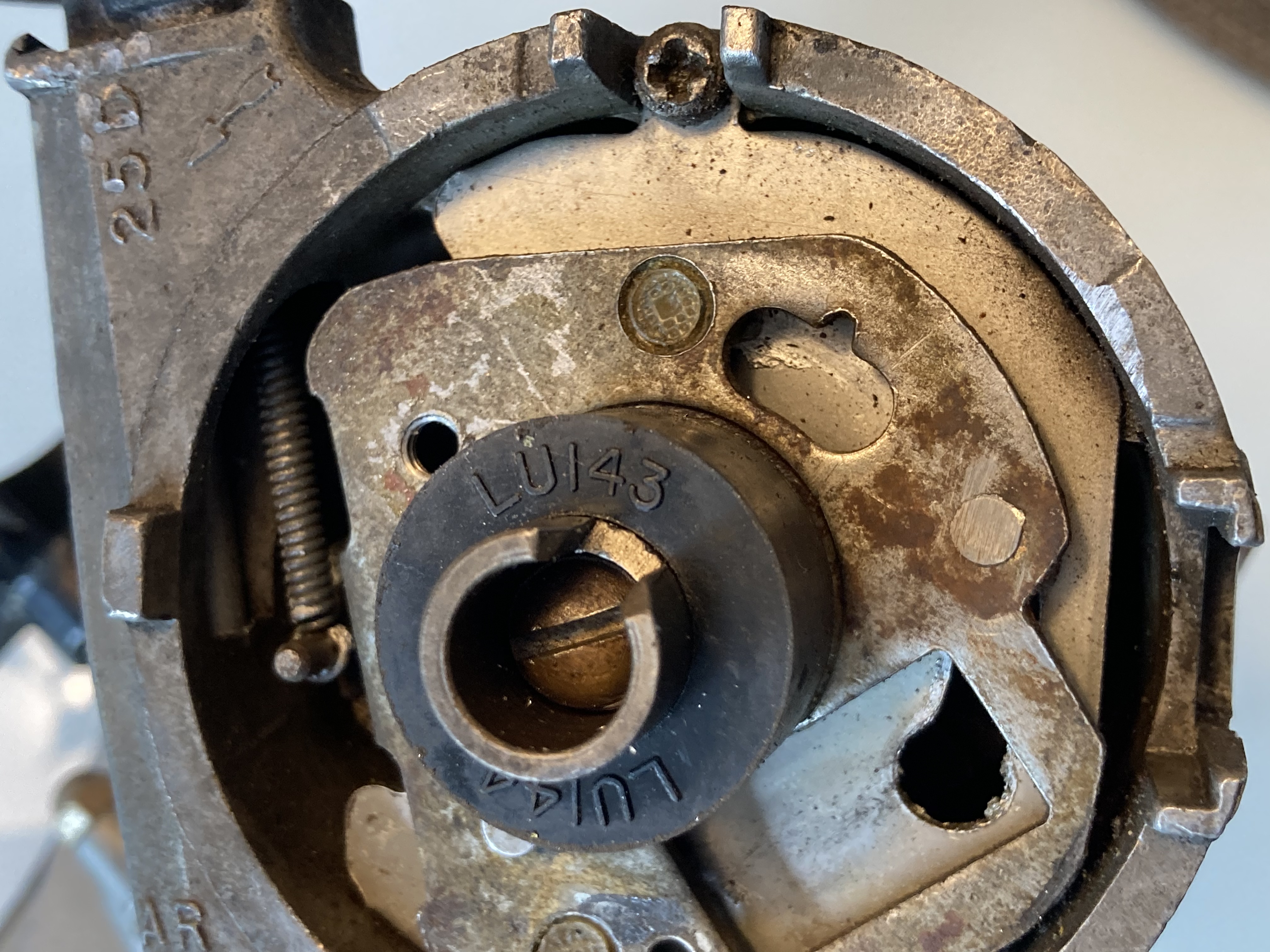

I recently removed dizzy and electronics from my 75
It had a 25D with old electronic ignition. I am going to put in points and condenser. Upon removing the old electronics I see on the base plate an area that has been filed/ground off.
Does anyone know what was there?
It’s on the right side of the picture
Thanks

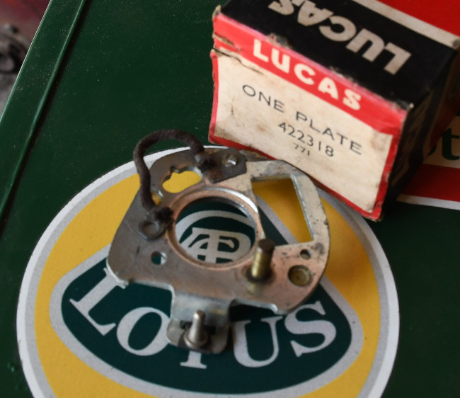

And what has been ground off was the pivot post for the points.
I see that now. Part number on box, as well.

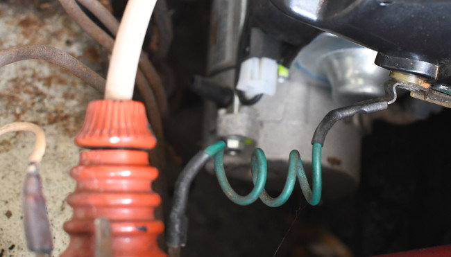

Another bit of info; you can get replacement points sets from NAPA or other parts stores. "StanPart" Standard Ignition Products. Rotor is: LU-300, not recalling points P/N, LU-316 or LU-319 maybe. Lucas numbers are: DSB958C for points, DRB101C for rotor.
A ten inch piece of 12-gauge multi-strand with female ends, wrapped around a pencil to coil it!
