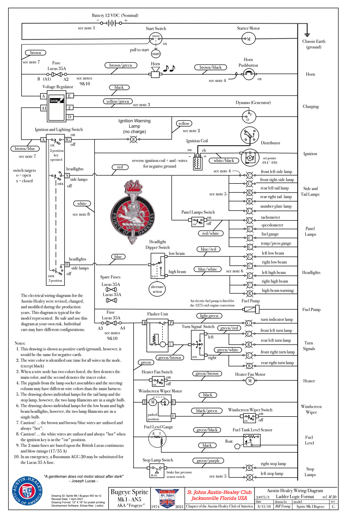

Like I said, I really don’t have a handle on electronics. I didn’t follow a wiring diagram, I just hooked the wires up as I thought they’ve were before. I turned the key, I had no fuel pump noise and the tach needle went up to about 2000.
I quickly turned it off.
I am now looking at a Rick Astley Electricsl Systems manual to see if I can make sense of this debacle.
..so, no vroom vroom at this time.

I finally got everything hooked up..well as best I could from pictures I had taken. I did not look at any wiring diagrams, well I wouldn’t understand them anyway.
I turned the key, no sound from fuel pump and tech jumped to around 2000..turned off quickly
I now have Rick Astleys Essential Electrical Systems manual open trying to understand where the wires should be because obviously they aren’t correct.
So, no vroom vroom yet
Not familiar with that book but looking at the descriptions it seems it should help.
As for wiring diagrams, one of the easiest to decipher is a "ladder" style one. Austin-Healey Club member Bill Young's is good, even if specific to a Bugeye Sprite. It would apply to about any of the British cars of the time. Differences are minor, most notable is the positive ground vs. negative. But the ignition circuit is color correct and annotated for negative ground difference. The Bugeye tach was mechanical, so not in the diagram, but the white wire to "feed" yours is just going on a detour from ignition switch to it and then connected to the coil's "SW" or "+" connector.
> For the Moderators< If I'm stepping on any toes here, please delete the JPG.
I took the liberty of converting the PDF file to a JPG:
