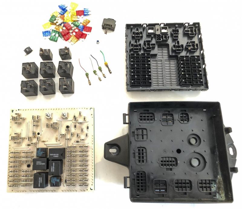

OK, today I picked up the Aston Martin from the shop here in Portland. There is no Aston Martin dealer in Portland, so the shop I use is probably the best choice (and may very well be the best choice even when there IS a dealer handy). The entries on the work order include:
Diagnose and replace waterlogged engine compartment power distribution box.
Repair extensive wiring damage due to corrosion at fuse box/distribution box connectors.
Labor cost was $1350 (probably a fraction of what I would have paid at a dealer).
Parts cost was $553 (cheaper than I would have thought, all things considered).
Here's the old, waterlogged engine compartment power distribution box:
<-- Note water stains from multiple, long-term standing water episodes.
This distribution box was not installed in a place where it would normally be protected from water. So here are my theories:
1. Aston Martin is a new company and their designers and engineers are trade school drops outs, so obviously they don't know any better than leaving electrical components where water is likely to enter.
No, wait a minute, Aston Martin is a decades old company.
2. Aston Martins are made in England, and since it never rains there and moisture is never an issue, it's not surprising that they designed, engineered and built a car without adequate, or even the most basic, moisture protection for electrical components.
No, wait a minute, it rains all the time in England. Cars built there should be as waterproof as submarines.
Hmmm ... so what could explain this? Maybe it's just being the world's worst engineered and designed cars since the Yugo? I'm leaning toward that theory.
And the shop owner tells me that I was just lucky that they were able to save the engine compartment wiring harness. That's a $2,000 part, and Heaven only know how many hours it would have taken to install.

Seriously, for an Aston Martin sounds like you dodged a bullet (a bit of one at least) price wise - annoying about the tire light. black tape?
Everybody has to own one of these kind of cars - once. Ferrari, Aston Martin, Lamborghini...luckily, you got away with under Two Grand - this time. Maybe silicone spray or something else can waterproof the electrical bits so as to avoid any further water problems.
Reid, as info, the XK8 Jaguar has the main ECI and several control boxes in two compartments on the back of the firewall with plastic covers over them.
Here is the kicker, at the very bottom of each box is a tube that empties the ingress of water down to the ground. Guess what happens when they get blocked up. They also just clip on to the side and any little knock disconnects it. We have many members talk about that section being full to the top with water.
Might want to look at the manual and see if the same design team thinking that was a good idea installed those in your car.

I agree that it could have been MUCH more expensive. I'm actually surprised that all those parts shown in the photo in my last post came to only $553, retail.
I agree that "exotics" are expensive to own and maintain (and repair) and that I got off cheap this time, but the bigger question is, Why was this repair necessary at all? Just make the Engine Compartment Power Distribution Box waterproof. How hard is that?
