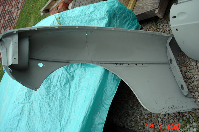

it is from the morespeedperoformance, it is the guy who owns that. he took off the dashboard and fendes to get it redone. and i was wondering what i have been doing wrong to try to get the fenders atleast off
Fenders are pretty straight forward - bolts down the hood line & inside the grille area, couple up underneath at bottom edge, about 5 or 6 behind the kick panel inside the car....but, you have to release the front air dam before the fender comes off....& getting to a couple of them up behind the dash is tricky.....

Don't worry about removing the splash guards - they're not attached to the fender.
Yep, you reach all the interior bolts from either inside under the kick panel or the corner of the dash.
Ok i got you but, i do rember 2 bolts behind the splash guard which i know i have taken out. because they were a pain to get out.
Nope, no bolts behind the splash guard! Not for the fender....only thing in there are the 2 center bolts that hold the door hinges to the body.
The door hinges stay mounted to the a-pillars which are part of the unibody.
