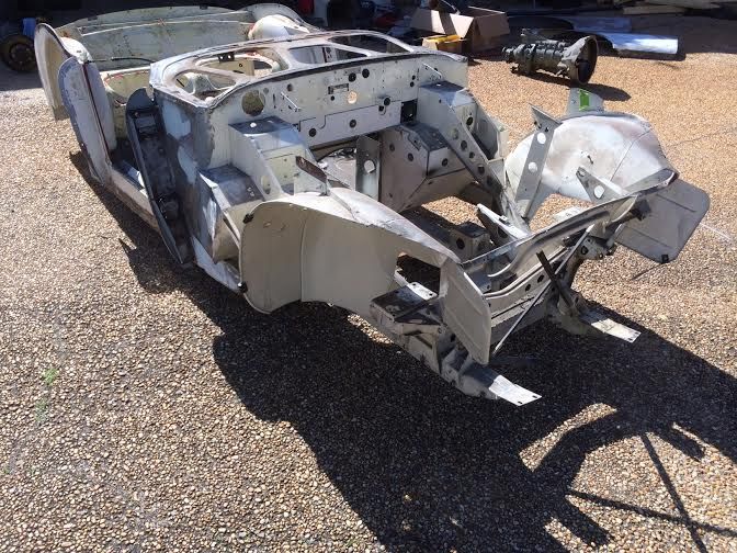

The panels fit decent, but due to previous repairs, they weren't great. Frame is solid. The only repairs I found were to the outer sills, lower front fenders, and lower portion of innner door channels at the front.
The hinge pillar panel and side reinforcement were in bad shape at the bottom. The metal came in from Moss motors, so I decided to go ahead and remove the rotten pieces. I ended up removing the newer rocker panel as well. It had been poorly seam welded in place and whoever did the repair welded the rotten metal at the bottom of the pillar to the new rocker panel. the only way to get to the rust behind it and to remove the portion of old metal welded to it was to remove it and cut it off. I will properly spot weld the rocker back in place after the door channel/pillar is repaired.
Im going to need to fab up a repair piece for the bottom portion of the bracket pillar.
I now have easy access to repair the area where some special person drilled holes in the kick panel to gain access to the fender for the installation of a crappy aftermarket antenna.

Only about 15% of the superstructure was salvageable , thanks to Marty at Jule I now have a great superstructure to work on .Its waiting for me to finish the 64 Im working on right now then its the 62 Tri-Carbs turn . ... Im a glutton for punishment.
The attachment shows what was left after the sandblaster had its way with her .
