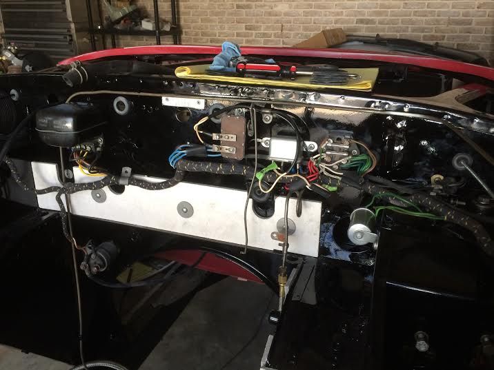

I applied seam sealer to the cockpit. This is made by lord fusor and is very easy to apply.
I then cleaned the heat shields, blasted the washers and painted them, then installed the shields. I also started running the wiring harness.

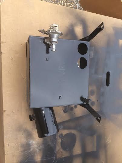

Heater Box Before
Heater Box After disassembling, blasting, and fresh paint.

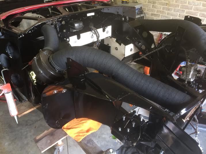

Heater and fresh air tubing in place.

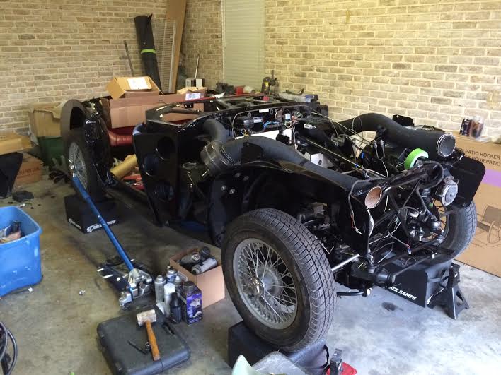

It's been a while since I have posted. The car was put on hold for a bit because I had to work on my own projects...have to make money somehow!

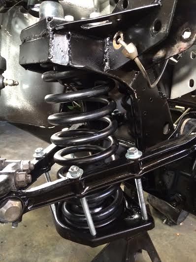

Anyway, she is now a roller. I reconditioned all of the suspension components, replaced bushings where necessary, and installed new rear leaf springs and front coil springs.
[/URL][/IMG]
Front suspension before reconditioning.
Front spring installation after blasting and reconditioning components.
Installing the front coil springs on the healey is pretty uneventful when compared to the installation process on Sixties American Muscle Cars!

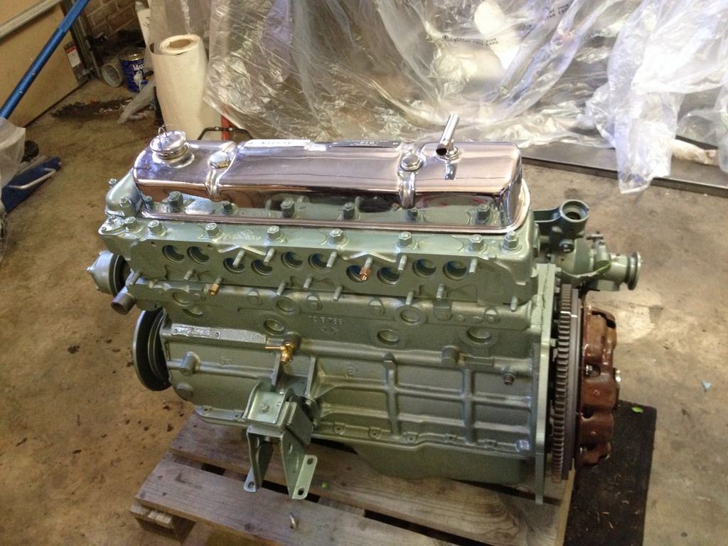

The mechanic finally finished the engine, which only took 15 months!:censored: I wet sanded the primer he applied then sprayed it with some correct Healy Green I purchased in a quart container. I have to say that using a paint gun to spray the engine turns out a lot nicer than spraying from a rattle can, but I guess that goes without saying.
BTW, a special thanks to Bruce at Healey Werks!!!! The mechanic said he called Bruce and talked to him several times with questions about the engine. I am sure that was annoying and if you see this, thank you so much for sparing your valuable time to speak with him!

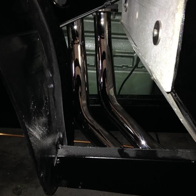

New Stainless Exhaust. This system looks incredible against the black paint on the underside!!!
A beautiful work of art!
