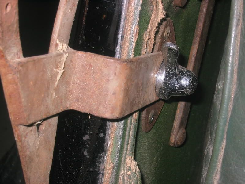

....& I have a question: how does the back edge of the rear side curtain attach to the car? I can't figure it out. I know how the front edge of the rear side curtain attaches but can't put the bracket on until I figure out how the back of the side curtain attaches.

How's this?
vping...there's 1 photo missing that I need to see....the rear bracket, please, from the inside...somehow it slips down behind the rear panel into a slot in the body tub, I know that....however, I'm guessing there's a piece of metal that goes across that slot (probably behind the panel)that's not on my tub & that I've got to identify in the few left-over pieces in my boxes!

I sent 2 pictures of the bracket that holds the rear side curtain "tang" to your web site. Hope it helps!!. Someone needs to tell me how to put pictures in a post.
Got the photos...thanks - just what I needed....now, I've gotta go find the little "tangs"!

Tony, Do you need a photo still?. The inside of that is coverd by fabric.
Try photobucket.com. It's fast easy & free. I have hundreds of pics there and it is what I use to do all of my posting.
<div class="ubbcode-block"><div class="ubbcode-header">Quote:]Tony, Do you need a photo still?. The inside of that is coverd by fabric.[/QUOTE]
nope, got it...thanks
