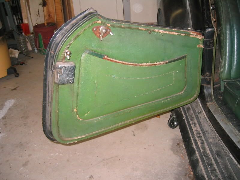

This must be a favorite angle to photograph TD doors. This is mine from lat year. Your looking at some old stuff here.
Notice the little barrel shapes on the handle & side frame attachment. There was a small rope like handle here that was used to close the door. I think it was an after market item. I found some remnants of it in the door pocket along with a D&D die, a Ronald McDonald ring & some ancient food stamps.

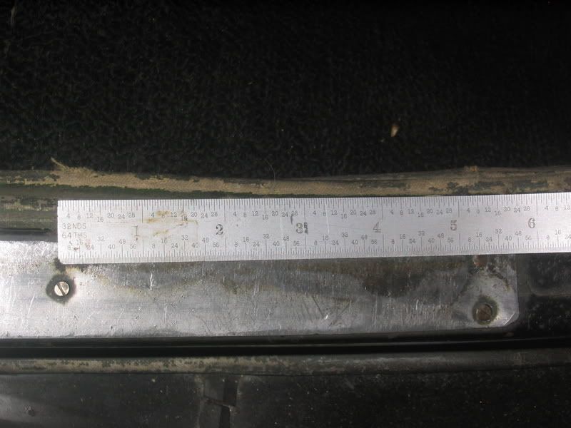

Good photo - I can see the little screws holding your door sill covers in place...the new ones don't have holes - or come with screws...can you give me some measurements?

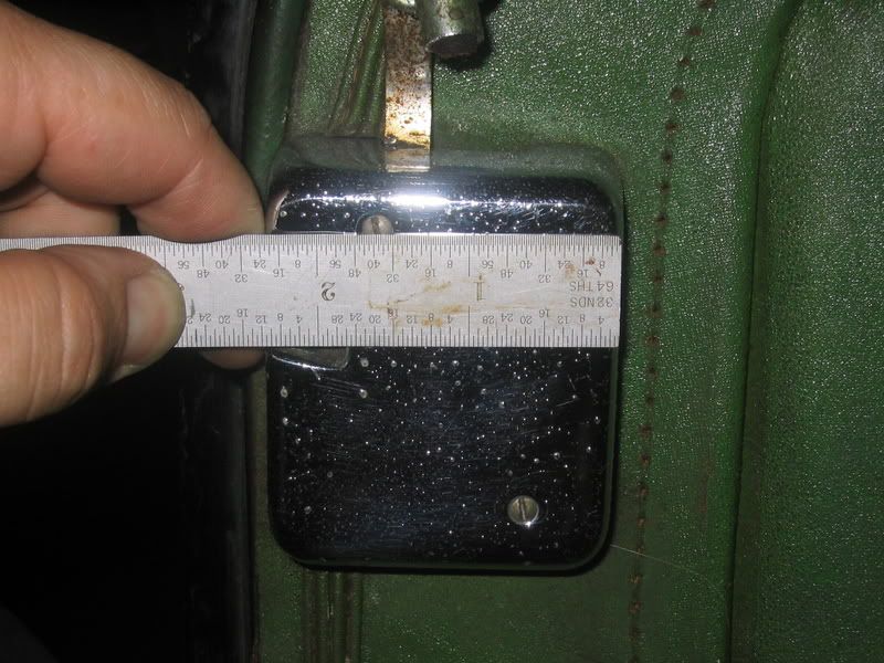

Why certainly. One moment please.....
This should do it.

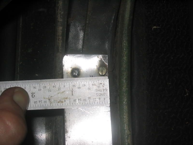

No, no...sorry...maybe I wasn't clear...I'm talking about the sill plates - the pieces of metal along the body tub under the doors when they're closed....its just barely visible in the right edge of your photo.
Ohh! Gotcha. Here is one while you wait. It's all in the details my friend. Side curtain screw.

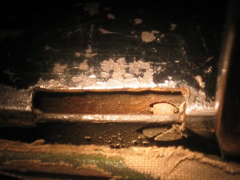

That was gonna be my next request...a photo of how the rear side curtain bracket is attached to the body tub...think you can grab a better angle?

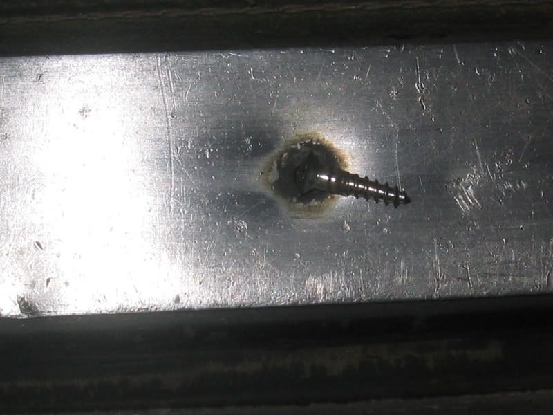

Man the restoration of your car is becoming a part time job for me /bcforum/images/%%GRAEMLIN_URL%%/smile.gif d'b my pleasure Tony but this is a toughie. I had to pry it open with a toothbrush to prevent damage. I'll see if I can get it open a little more and maybe get a ruler in there.

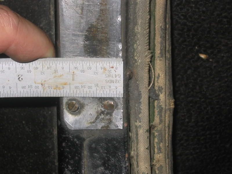

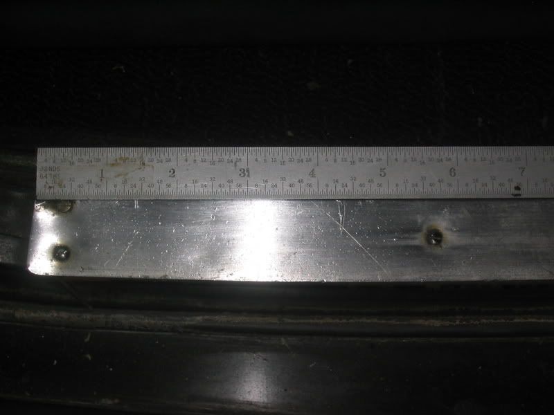

Here is the sill from back to front and the screw size. I doubt that screw has seen the light of day in awhile.
Unless I'm mistaken, no TDs came with those plates as standard. So the holes go wherever you think they should go. Use screws, not rivets.
True, Steve...there are no holes anywhere on mine - think they were aftermarket or dealer adds...while the plates were not original, everybody has them so I'm thinking about adding a set to cover the seam...I had previously ordered a set from Moss & they arrived today...they say "M.G. Car Company LTD." in black....no holes anywhere...was thinking there had to be some rhyme of where to drill holes & what type little stainless screws to use (MGB's have real tiny ones).

Hey vping wanna sell those lockset covers?
Tony I have the small screws that hold that sill plate down - but cannot guarranty they are stock. They were holding down plates that have "MG Car Company" etched in them and we all know that originally they were plain plates with no markings. Looks like vping has an original set. I would be curious what the screws are also.
