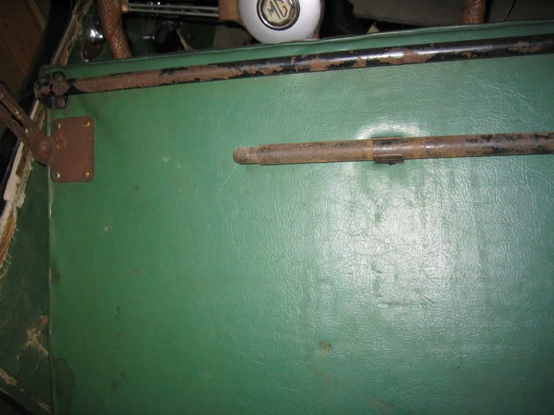

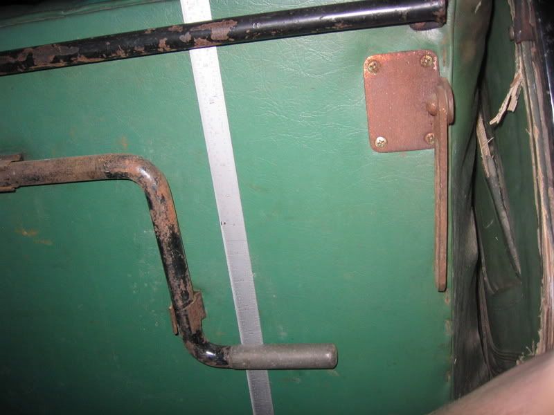

Oh, I need photos of the back of the seat with the tonneau bar installed (& measurements for locating bar) & the engine crank handle attached in its clips.

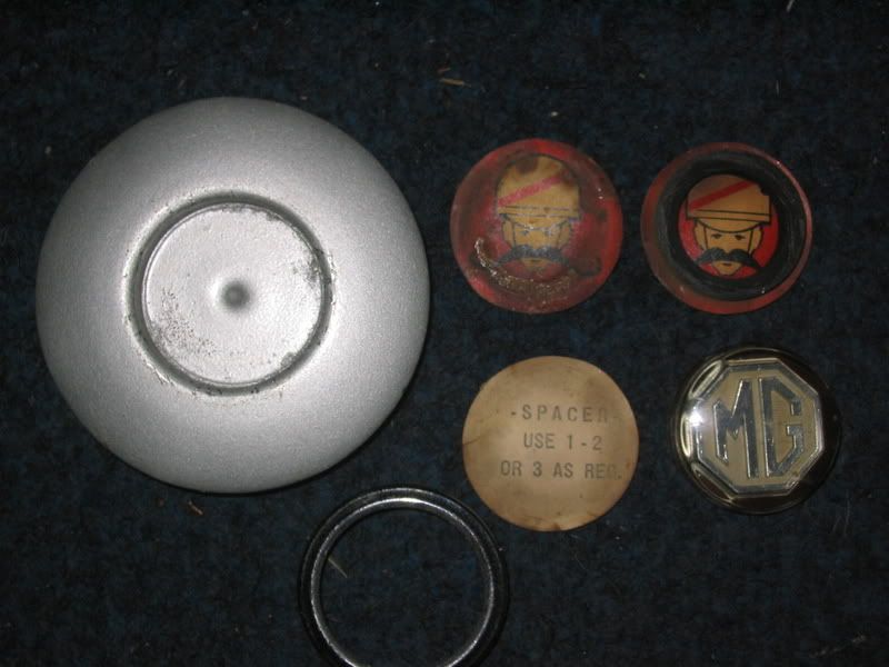

I will be heading home now Tony & I'll see what I can get in terms of pic. BTW, did you steering wheel cap have any little paper discs in it just under the plastic MG Logo?
<div class="ubbcode-block"><div class="ubbcode-header">Quote:]did you steering wheel cap have any little paper discs in it just under the plastic MG Logo? [/QUOTE]
Yep - it had 1 like a little washer...right now I'm trying to find the little retaining bolt that holds the cap to the steering wheel.
...& I'm real happy with the Moss aftermarket wheel!
No. These little paper discs:
Oh, no, I've not taken that apart - it didn't need to be done...but I have 1 thin paper 'washer' that goes between the entire cap & the wheel....but, yours looks like metal & mine looks like ivory.
The center cap is chrome the center- cener is a chrome ring that holds the molded plastic MG logo. Under the logo is a rubber washer and the tree paper picture spacers to keep it all tight.
Do these pics help of the back of the seat?
Yep - Photos verify what I thought was their relationship to one another...do you have measurements?
Bar to top of seat?
Crank brackets from some point of reference?
The center cap is chrome[/qote] Are you talking about the MG logo or the larger cap? My larger cap is plastic that looks like ivory. I'll take a photo tomorrow.
The larger cap is Chrome. Measurements - can you wait till tomorrow night or do you need them tonight?
Tomorrow's fine...interesting about the differences in the caps!
True. d'love to compare them side by side.

Maybe there were chrome vs. plastic options in 1952?
Cry, I can't see the pics.
<div class="ubbcode-block"><div class="ubbcode-header">Quote:]Maybe there were chrome vs. plastic options in 1952? [/QUOTE]
That might be the difference - mine's a '53.
