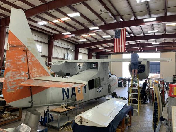

I miss working on planes so much. I started hanging out at Jack Kosko's facility in Fawn Grove, PA about 11 years ago, when he and his group of volunteers were finishing up their second TBM Avenger restoration. They were all old school craftsmen with an average age of 84 years old by the time I joined in on the fun. After the Avengers, they were working on a Cessna Bobcat when old age and health issues finally caught up to Jack. He sold the farm and transferred the Bobcat project to another individual to finish. Jack passed a few months later. Once working on planes gets into your blood, it's very hard to stop.
