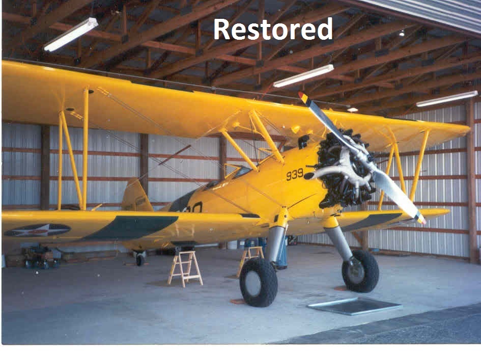

No welcome wear out here, I've been there many times, mine back in the 60s. PJ
