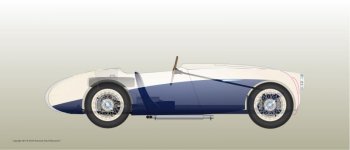

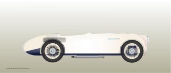

First time posting to the AH section but post over in the TR, Jaguar, and MG forums from time to time. I illustrate cars and, in particular, British sports cars from the 50s, 60s and 70s and have recently embarked on an illustration of the 100S and 100M Healeys. Thought I would share my progress as well as ask for any comments or observations.
  • Sketch 1 - I've roughed in the body contours, established the wheel base, penciled in parts of the frame and added a few other bits that will help correctly locate other items
  • Sketch 2 - Steering wheel and column added, set in place, rear springs and prop shaft penned in, a bit more of the frame drawn
  • Sketch 3 - Body counters finished up, cowl and bonnet added, fuel filler, boot hinge, tag lamp and front/rear turn lamps added
  • Sketch 4 - Fuel tank is in, straps and top of wheel added to spare, door card, dash, mirrors, and rear brakes added along with the front frame outlines and a number of other bits an pieces.

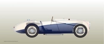

  • Sketch 5 - A "test" motor and gearbox (in this case, a B series from my MG drawings)—please I know it's sacrileg) dropped in so I can check the relative position of some of the components that will fill the forward bulkhead—fuse panel, regulator, fluid reservoir, etc. I know it's sacrilege but I needed something until I get to drawing the 100S power train.

Looks nice, but the rear calipers should be on the rear of the hub.
Thanks. Good catch. I meant to reverse them after I drew them but must have been wrapped up in other details and never made it around to it.

A bit of follow up on progress. I've spent the past few days correcting a horde of details but finally was able to pen in some new parts. A few of the changes include: redrawn differential (to reflect the centered pinion), added the fuel tank outlets and plinth, add the plinths for the boot handle and front turn lamp, changed the wheels to 48-spoke (per a 100S owner), corrected the rear brake, added the front brake and suspension, finished up the steering box and started the other steering bits, lots of edits to the profile and paint lines, redrew the whole foot box area, added the grill and nose profile (also penned the grilles for the other models while I was at it), and generally cleaned up things. I'm sure there are still some errors but I'll keep working my way through them with the help of a couple of present and former 100S owners (huge thanks!).
Tomorrow I'm going to get started on the motor and gearbox and tidy up a few of the loose ends. It's getting closer...but still along way from complete.

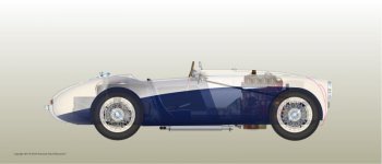

Am getting closer to complete. Still have the motor to pen and a few other details but here's most recent version.

It is really coming along nicely. I can't tell easily on your drawings, but the wheels were painted white, not silver on the 100S.
Thanks. Wheels are a little off white as pure white just doesn't show the detail or print well. You may have also noticed, I'm showing the wrong grille on the last version I uploaded. I'm actually working on the 100S, 100M, and 100-4 cars simultaneously and wasn't paying attention to which grille I was showing when I saved the JEPG. Next upload will show the correct profile.

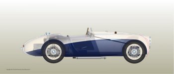

And the most recent version. There are still quite a few details to work out (the exhaust header and down pipe being the most obvious) but I'm creeping closer to finished.
The parking lights are smaller on a 100S than a 100. I think they were from a A35 or something. A nit, but some might notice.
Fixed it. Was also able to correct a number of other items with the help of you photos. Will post up a new version in just a bit. Still futzing with the accelerator linkage. I hope it was easier to assemble in real life than it is on the illustration.
