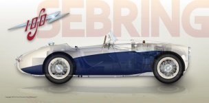

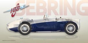

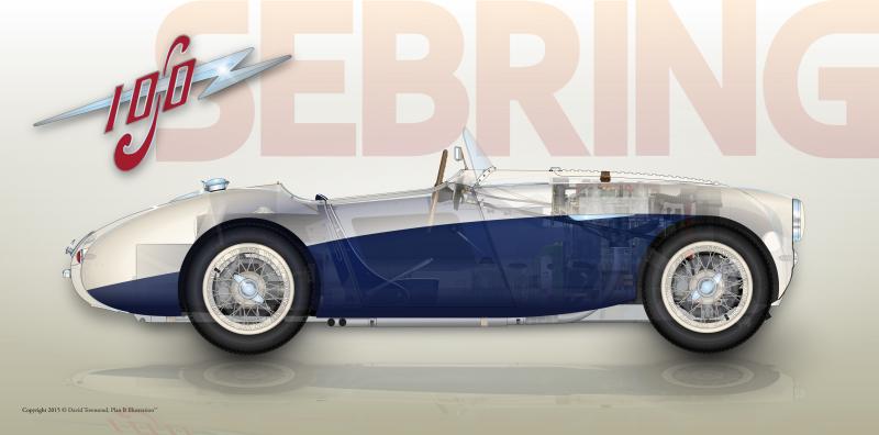

Well, it's as far as I can take without the review of those more knowledgeable than I. There are too many changes and additions since the last version to list them all but a few of the highlights include the tach, speedo, oil gauge, and temperature gauge lines have been run, corrected the exhaust manifold (courtesy of a gentleman who furnished a picture of an original), added the front sway bar, completed the throttle linkage, air box, dip switch and bunch of other bits and pieces.

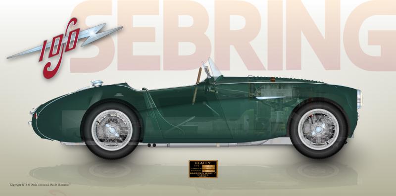

Next up is a Spruce Green version, customized to the serial number of the car (upon request). There will be two versions of the finished print available (once it's been reviewed)—a collector's edition that will include the serial number of the owner's 100S, body and interior colors to suit, and modifications to match the car and a second "standard issue" print as shown here, available in either a 24" or 36" size print. These are printed on acid-free, archival quality paper and are numbered and signed. Prices have not been set yet, but if you're interested, shoot me you e-mail address and I'll add you to my mailing list.

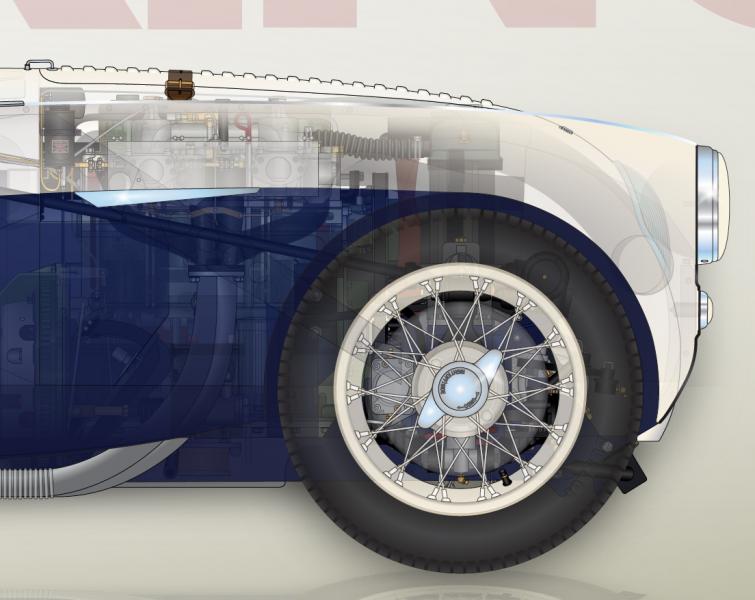

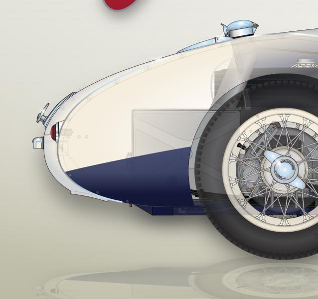

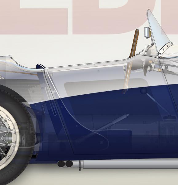

Well, the 100S illustration has undergone several reviews (with a few more to come) and each time the gents (previous 100S owners/restorers) who have so kindly committed to look over my work have found all manner of unique 100S items that need to be edited. While I'm sure the next round of review will turn up additional items, I'm happy enough with where things are at to post the latest version.
Some of the details that needs to be changed included: the choke mechanism, the spare tire strap, the cockpit coping, water pump nuts, exhaust down pipe and manifold, forward exhaust clamp, base of the mirror, steering column clamp, throttle shaft, pedal pads, wheel lacing, shift boot, and a number of other nits. Even though these seem like small changes, they're important to make.
I should have the order form up on my site by Saturday and expect to begin delivering prints about 2 weeks later.

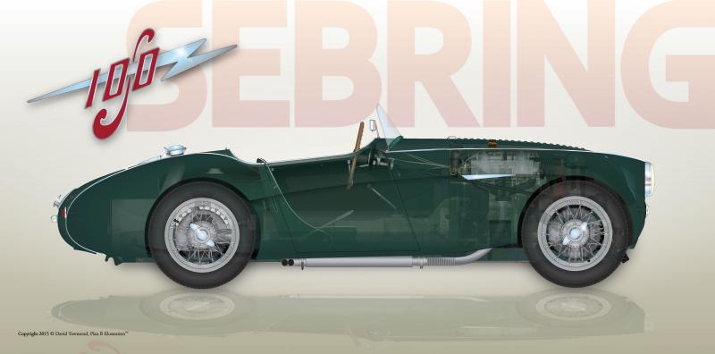

In the meantime, here's a version in Spruce Green.

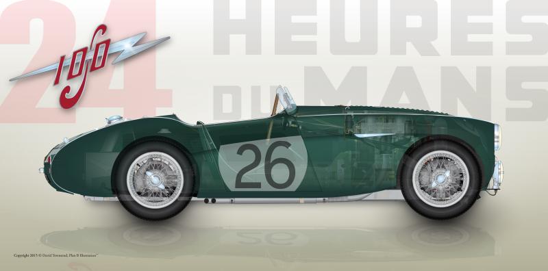

Well, I've been busy making innumerable corrections and tweaks to the 100S illustrations, which now include the Jackie Cooper car and the famed (infamous?) #393 that Lance Macklin crashed at LeMans. The differences are sometimes subtle and other times not. The manufacturer plate that shows on the Cooper car will be offered only on the Collectors' Edition to current and previous owners.
I have to give shout outs to Michael Salter, Ken Freese, Rick Neville, and Carroll Phillips without whose help none of these would be what there are. Special thanks to Michael who really did yeoman's duty reviewing countless versions of the original artwork. Together, I think we've done something very cool.
Hope you enjoy perusing the illustrations as much as I did drawing them. The order forms should be up on the web site by the end of the day tomorrow.
