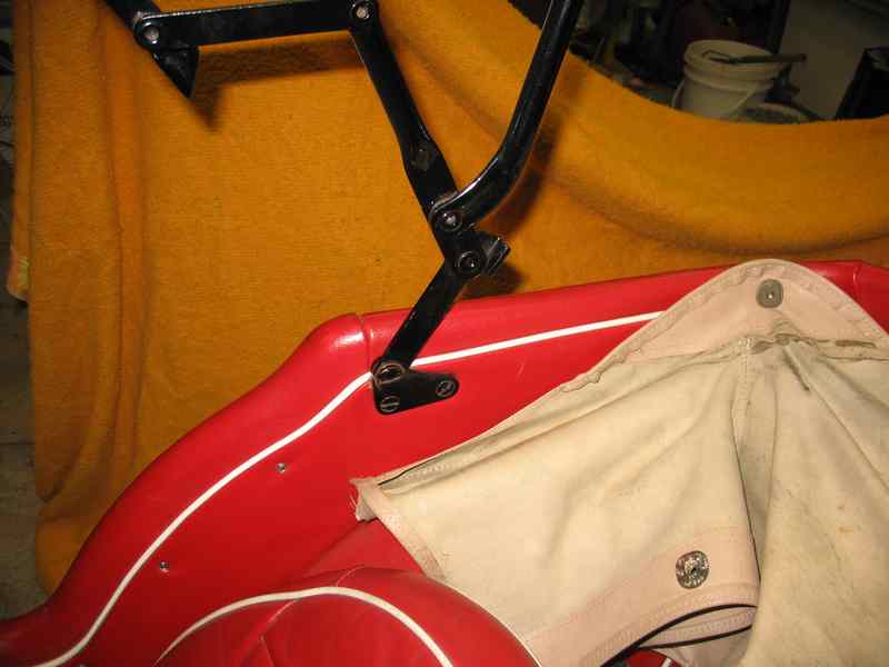

My 1958 TR3A came with a "fawn" top, sidecurtains and stick cover. In 1989, I had the sidecurtains re-done in tan or beige - very close to the original "fawn". My build record says "fawn".
Here is the original "fawn" stick cover after 51 years of wear and tear.

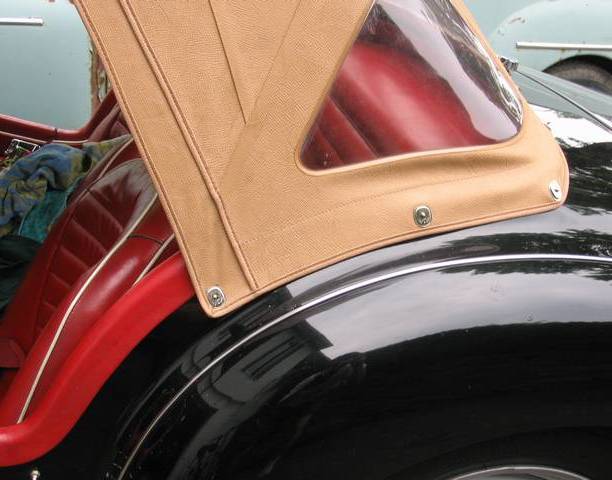

And this is the top I bought new in 1989. Notice the slight colour difference. But no judge at TRA ever docked me any points because of the colour beige slightly different.
If you TR is primrose yellow, dealers sometimes swapped items from car to car to please a buyer. Anything for a sale. maybe someone else wanted a black top, so the dealer swiped the black one from your car and sold it on another TR.
I took this photo earlier this summer with 102,000 driven in the past 19 summers. The secret to keeping a top looking this good is simple.
1.Keep it in a vinyl bag to protect it.
2. Don't just dump your 20 pound tool box into the trunk on top of your top and/or sidecurtains. Get a bag for those as well.
3. Don't use it. I'd guess that I have had my top up in the rain for about 3,000 miles during the last 102,000 miles driven since 1990. I don't go out when it's raining, but if I'm away from home and it rains, I'll use it. On occasion, I have left it in the bag in the "boot" and I have driven over 300 miles in the rain to get home witout having to put the top up.
