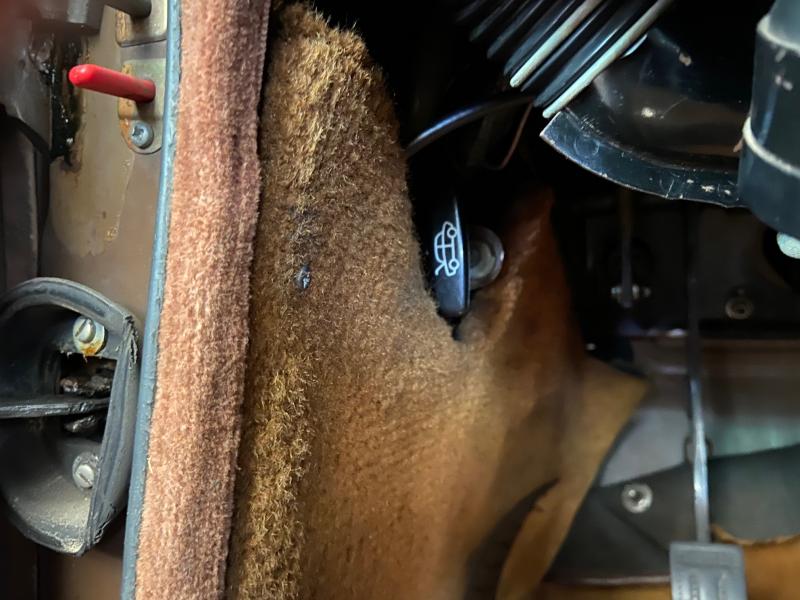

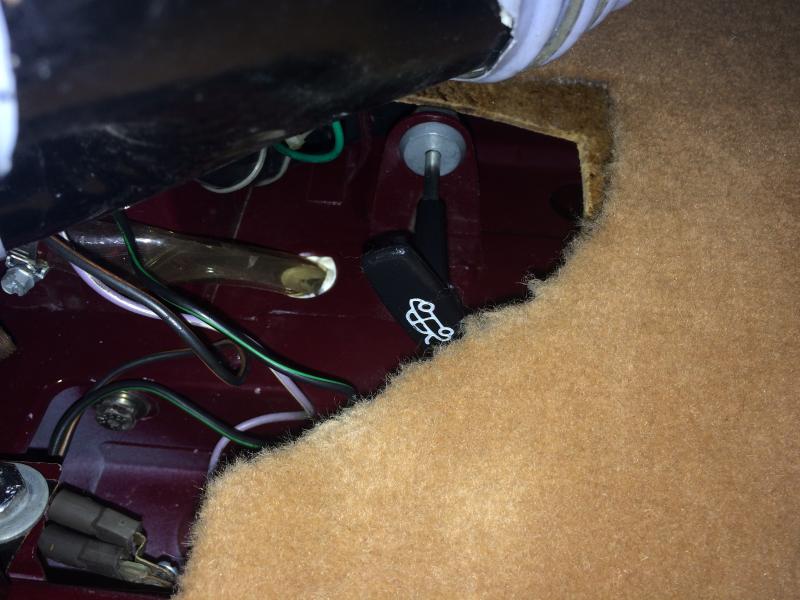

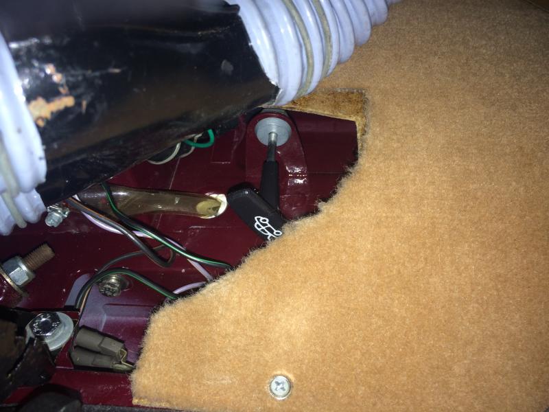

My hood release interfering with surrounding interior upholstery panel.
It's hard to use and doesn't seem correct. The carpet board is pretty thick.
Would like pictures of a correct setup. Thank you in advance.

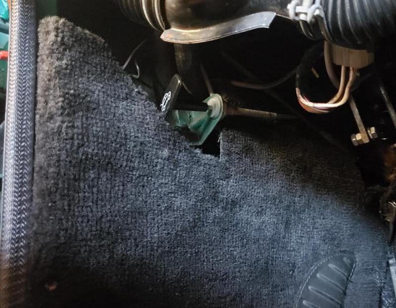

Mine pretty much looks the same as yours. The release handle moves very little.... I have not had a problem using the release as it is shown. Most of the time I reach under the passenger side and use the emergency release to open the hood (bonnet for you guys east of me :smile:)

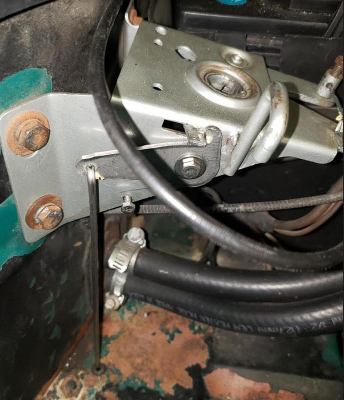

I just last week installed the Moss emergency release rod and it works a treat!

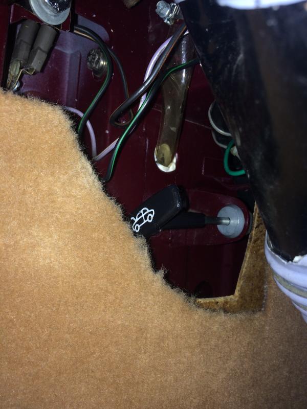

The hood release handle should be oriented "portrait" instead of "landscape", that way it won't interfere with the kick panel as much.

The handle is at this angle because it's built-in. The handle ferrule has a flat side matching a "D"-shaped hole in the welded-on mounting tab which is part of the body structure. The handle itself has an index groove which matches the inside of the ferrule. Hence Elliot's and mine being at the same angle. This could be changed but one would have to bore out the mounting hole to allow the ferrule to be rotated. That would necessitate removal of the cable from the car.
If I do that, I'll make an extension for the mount which would orient the handle landscape as well as moving it inward, further away from the carpet panel.

You beat me to it Steve.... As you say, there is an indexing flat on the ferrule and a matching flat side on the cable mount in the car.
I guess you could orient it differently but for me, the current orientation does not seem to be a problem.

Is your cable a reproduction part? I suspect is and it is probably the only part available and doesn’t exactly match the original factory part. The picture I posted is of a factory original set up. I’m nervous about continuing to use it and will be installing an emergency release cable ASAP

I like Moss' newer rod-style emergency release which looks to be foolproof, rather than the older cable design. They sell both.
I tweaked it a little: rather than drilling the holes for the main screw and stop screw, I tapped them, inserting the screws to the desired depth with locknuts on the back. The Moss-supplied spacer makes the action pretty sloppy, so I bored out a thin SS washer to take up the slack on the excess length of the spacer.
