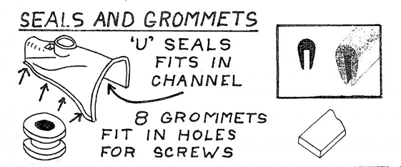

RestoreThemAll
British Car Specialists have a Rare and Hard to find parts catalog.
https://www.britishcarspecialists.com/WebCatalog/
Look under Transmissions/Seals.
There's a seal that fits on the floor pan lip and meets a channel in the gearbox tunnel. I ordered one this week.
attachment.php
