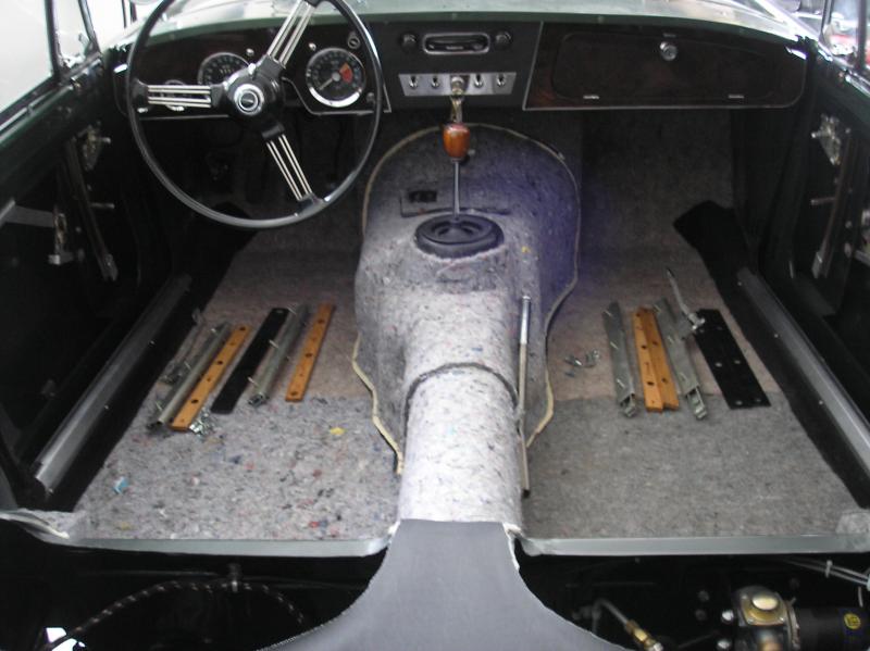

Healey Nut
Heres my 67 before the main carpet sections went in . Thats the jute from Victoria British over everything including the tunnel . Under that is that sticky rubberized foil backed heat blocker stuff . It goes from right up the front of the footboxes
all the way to the rear kickpanel .
Healey Nut
Healey Nut is the jute 1/4"?
Thanks for all your help!
Yes , thats what it says on the VB website , and the foil heat matt stuff ads another 1/8” ish
