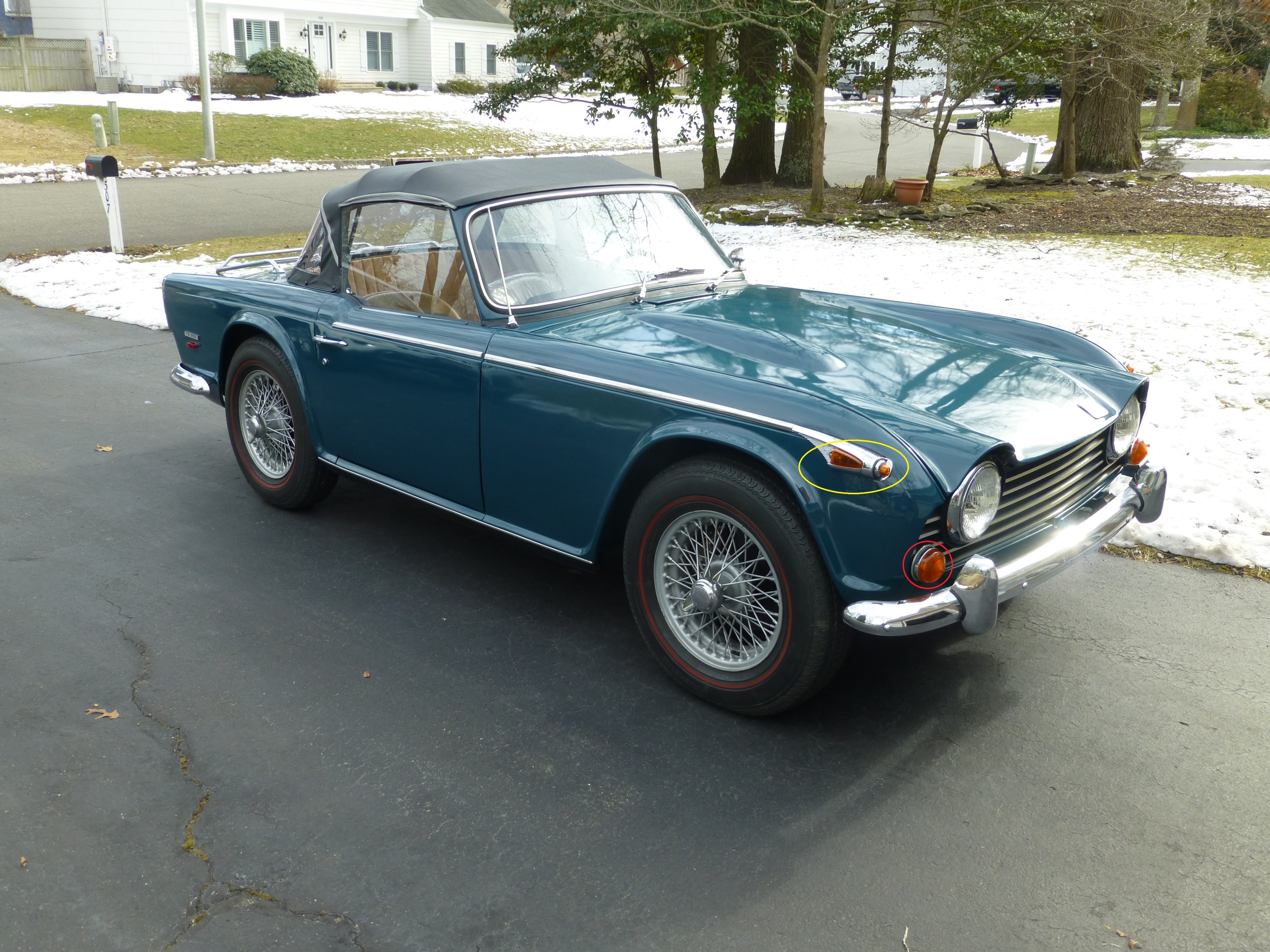

Has anybody switched their tr3 front turn indicator bulbs to amber?
I got my litezupp order and the lights are much better but the clear lense and white leds front turn signals are still hard to see in bright sunlight conditions.
Does a tr4 or other car use amber bee hive lenses?

checked moss.looks like 560-275 is what I want,healeybn8 or spitfire.

RGK
The 250 turn lenses, red circle, are amber.

TFB
Thanks for replys.
RGK ,looks like a screw held lense for the 250,nice looking car btw,but cant tell from pic.
Hamish suggestion for amber bulbs in the orig. clear bee hive may be an option.It would still look stock until the lights were on and the parking lights are low amber with bright amber indicator.
Napa has led amber 1157 two pack for 22 in stock so I may try some tomorrow.
