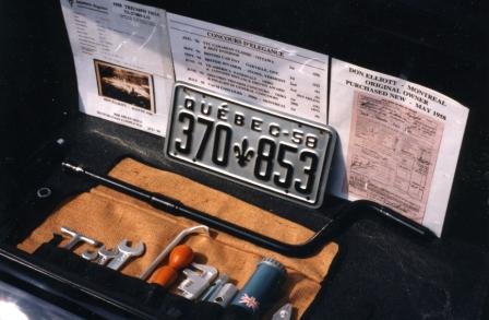

The Hardura mat in my TR3A was contoured flat when new. THe new one is 20 years old and I trimmed it to fit the same way. No TRA judge ever commented on it or anything else in the "boot" because you are not required to open the boot lid. I always do because I have so much to show.
BTW George, I stuff my side curtains in a special bag made for that and when I store them in the boot, I place them so the black supports at towards the rear of the car. I pack tool bags etc. up anong the rear hardboard (I protect mine too) and the side curtains in the bag lie on a slight slope

Nice tool kit Don!

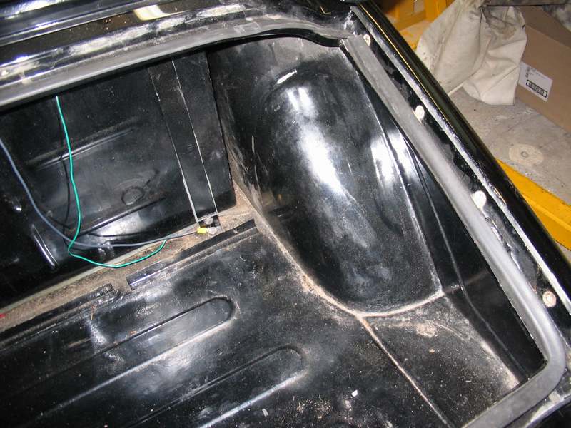

The 4 tiny #4 trim screws are correct. My TR3A cam with them when new. But during my 3 year restoration from 1987 to 1990, I totally forgot about them. Sometine during all the welding, I must have welded these tiny holes closed. I don't have the holes or the screws. It's been that way for 20 years. Since TRA don't ask to judge the boot, I don't need the screws. I cover the mat with another piece of trimmed carpetting to keep the matting clean and it saves wear. Alao I can flip out the matting and shake it to get rid of sand or other dust etc. without having to un-do 4 screws which is a pain.
I also consider that the closure of those 4 holes means fewer spots where new rust might develop and the floor inside the boot stays dry.
This is how my boot floor looked in 2007, 17 years after it was repainted in 1989. I had removed the wire harness and sent it to Rhode Island Wiring where they put new black cotton braided covering on it.

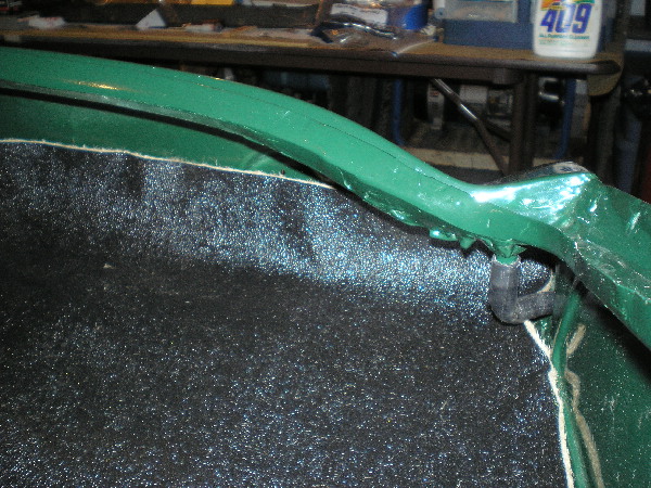

My name is Eric. By the way the new Hardura mat fit pretty well although not at all like the original. The original was less flexible and less jute backing. I had to trim the part closest to the boot or tank closeout otherwise it fit OK. I had to use a #6 screw and washer as I have the original boot floor and the holes were a little rusty and the holes were too loose for the #4 screws. Also looking at Don's pic I wonder where the wiring harness to the tail end are.
Also the mat I have is a VB product.

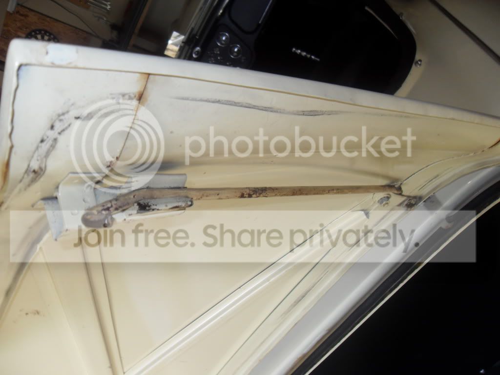

By the way do you have any close up pictures on how the boot stay rod is attached to the mounting bracket on the boot hinge?
Thanks, Dick

ekamm
Here's a few pics I took more let me know it there is anything that I missed.
ekamm
Just re-read your post here is a closeup of the place where it attaches.

That's great Eric, thanks. Answers my questions, very well. Hope you had a good outing yesterday.
