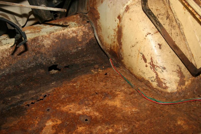

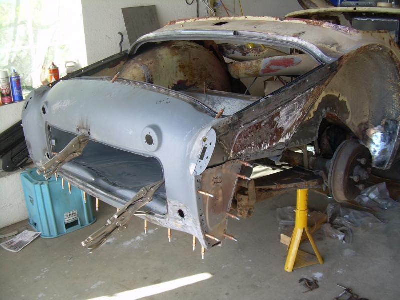

Hey Steve - trunk floor replacement is a lot of work. I did mine but it was completely shot. I also removed the rear apron, so that I could clean up the internal rust on that part. I can't even begin to count how many spot welds I had to drill out and how many plug welds I had to make. It came out great, but if I had pin holes, I'd just drill them out and reweld those areas. You are going to probably have a carpet or mat over the trunk floor, so no one will ever see your panel replacement.
If you want the floor to look great and you've just got some rough spots (rusty), you could buy a replacement floor and then just patch back portions of the old floor with new, as needed (cannibalize it). If I were to do it again and my floor wasn't completely rotted out, I'd patch it back and reduce the headaches.

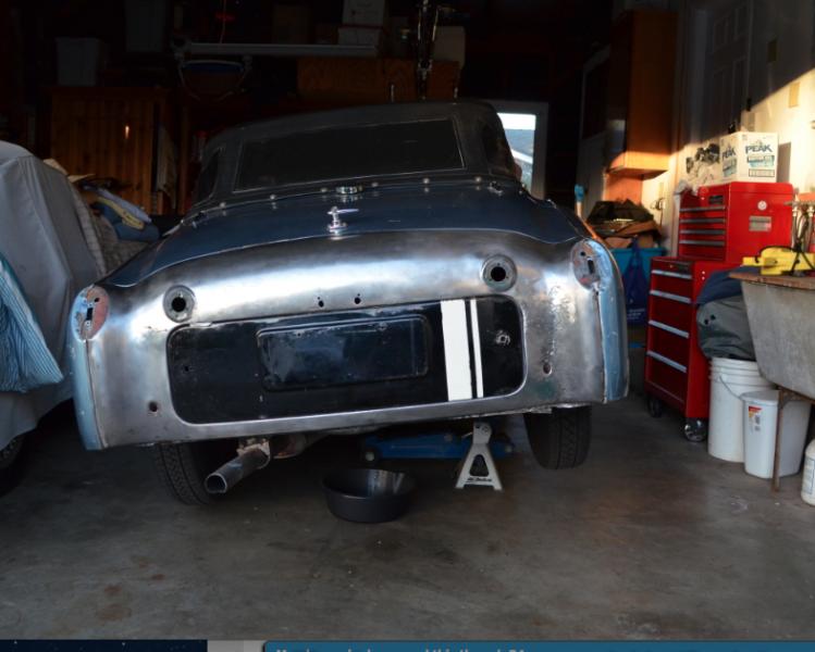

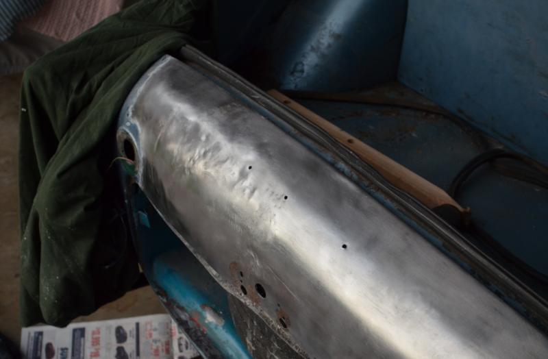

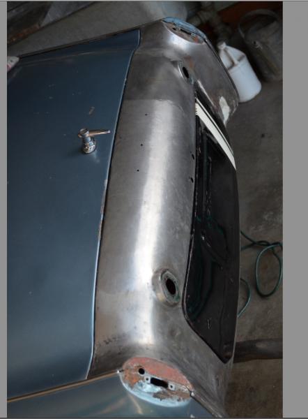

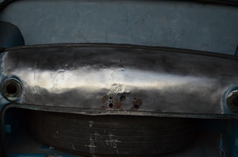

Here are some pictures of the rear section. Two photos are soon after the paint and bondo was removed. The other two photos are more recent. It has been a slow and steady process. So far happy with the results.....it just takes are really long time.
